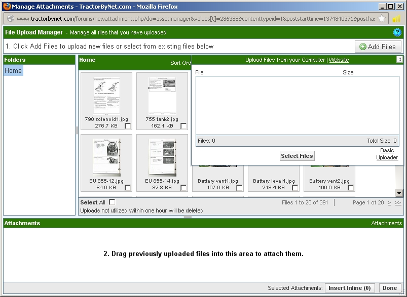

To add the photo directly to your post just click on "Go Advanced" at the bottom of the reply box. Then click "Manage Attachements". Then "Add Files" and browse to choose your pic file to "Upload". Then "Done" and post it.
