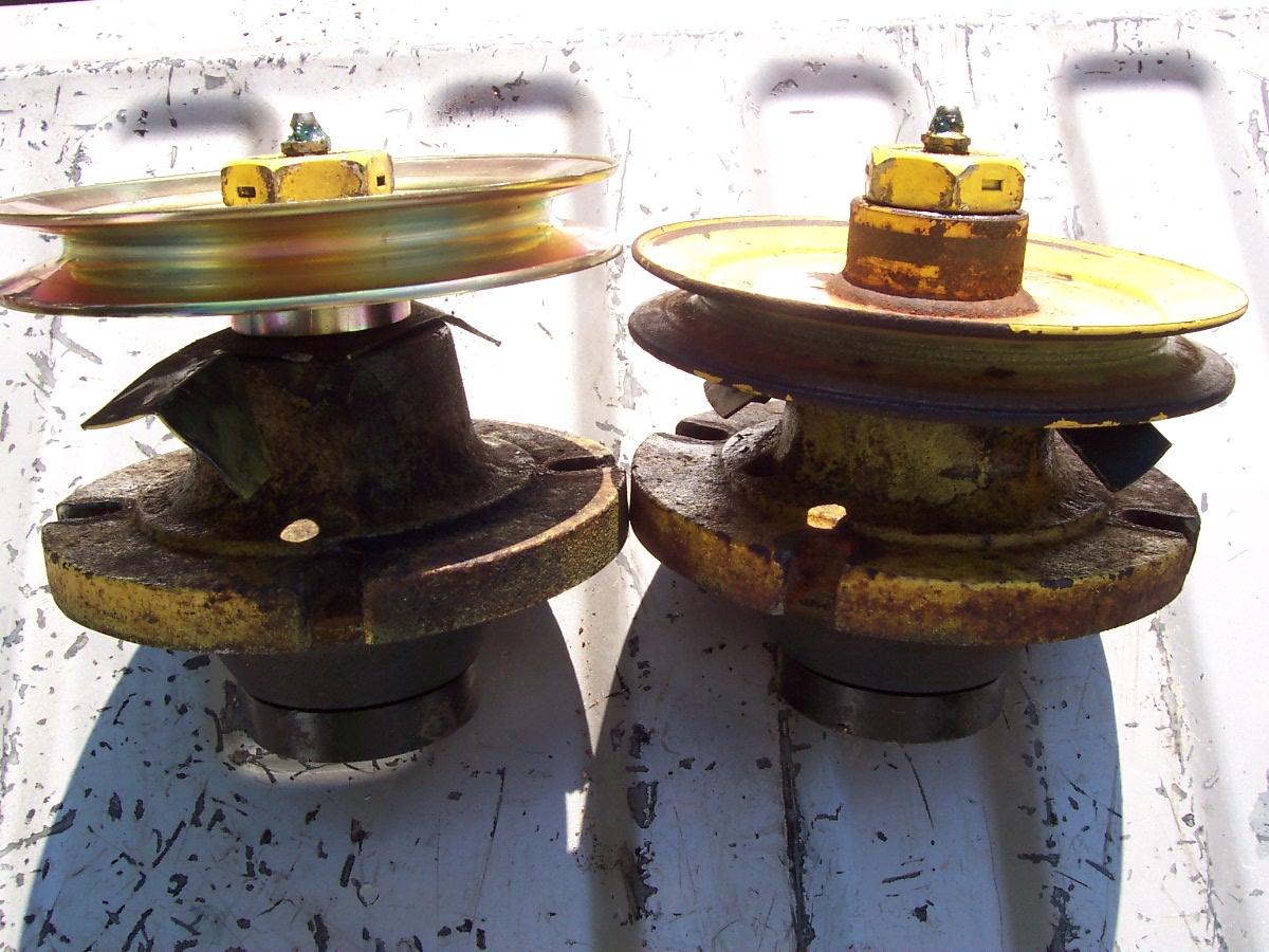

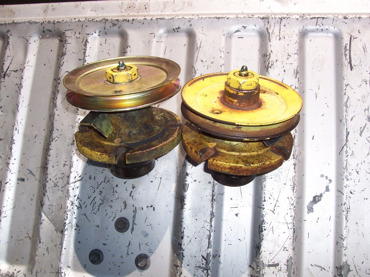

Ok I pullies are done I picked them up the other day. Estimate was way off they socked me for $450 bucks plus a new belt @ $60. Ouch
Went to install them this morning and discovered there will be a major alignment issue. Now I have to bring one back to the dealer and deal with them idiots again. Prolly have to wait another two weeks to fix again the right way

Looks like all that is needed is, take the nut off the new pulley and flip it over, sucks dealing with idiots. Glad you couldn't figure out the Photobucket, I got to see the pics of your 900s. Still have a soft spot for those jewels, owned a '73 and a '75, king in their day. I pulled a camper with the '75 for a couple of years before I sold it. Thanks for the memory trip.

Idlers usually arent rebuildable. and cost ~$30
The spindles, 6 bearings @ $10 each ~ $60
New pulley, likely around $40
So $130 in parts and $320 in labor. Sounds about right. 1hr per spindle @ $100/hr shop rate. Good incentive to learn to do the bearings yourself. I could have had it done in under 1/2 a day once I had parts. And be ready to go.
They got you for a new belt. Price seems about right. But did you need a new one??
I agree about just flipping the one over.
