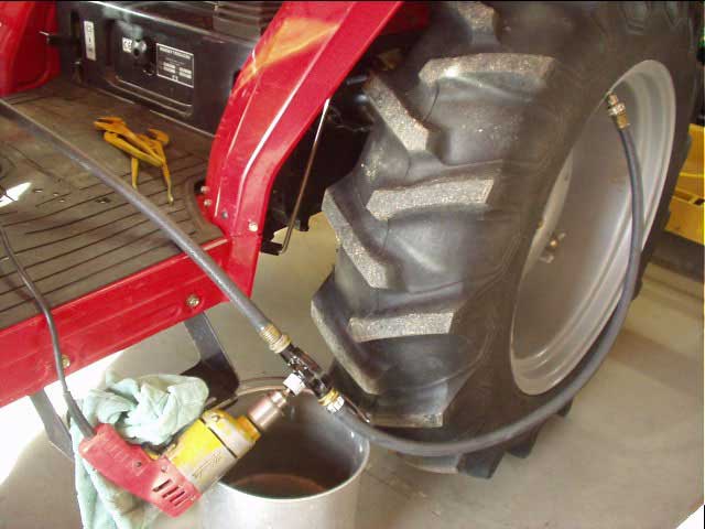

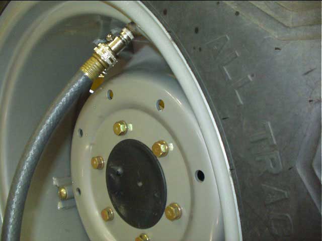

Never one to leave well enough alone, I gotta ask. Why not just put the hose down inside the opening on the jug if you are going to use a pump anyway? /forums/images/graemlins/confused.gif
/ Easy tire fill
#22
<font color="blue"> ..... Why not just put the hose down inside the opening on the jug....... </font>
<font color="black"> </font> By using a resovoir it eliminates the stop and go when changing jugs, since you can pour fluid into the can continously and faster than the pump can empty it, so its easy to stay ahead of the pump and also not loose its prime.
