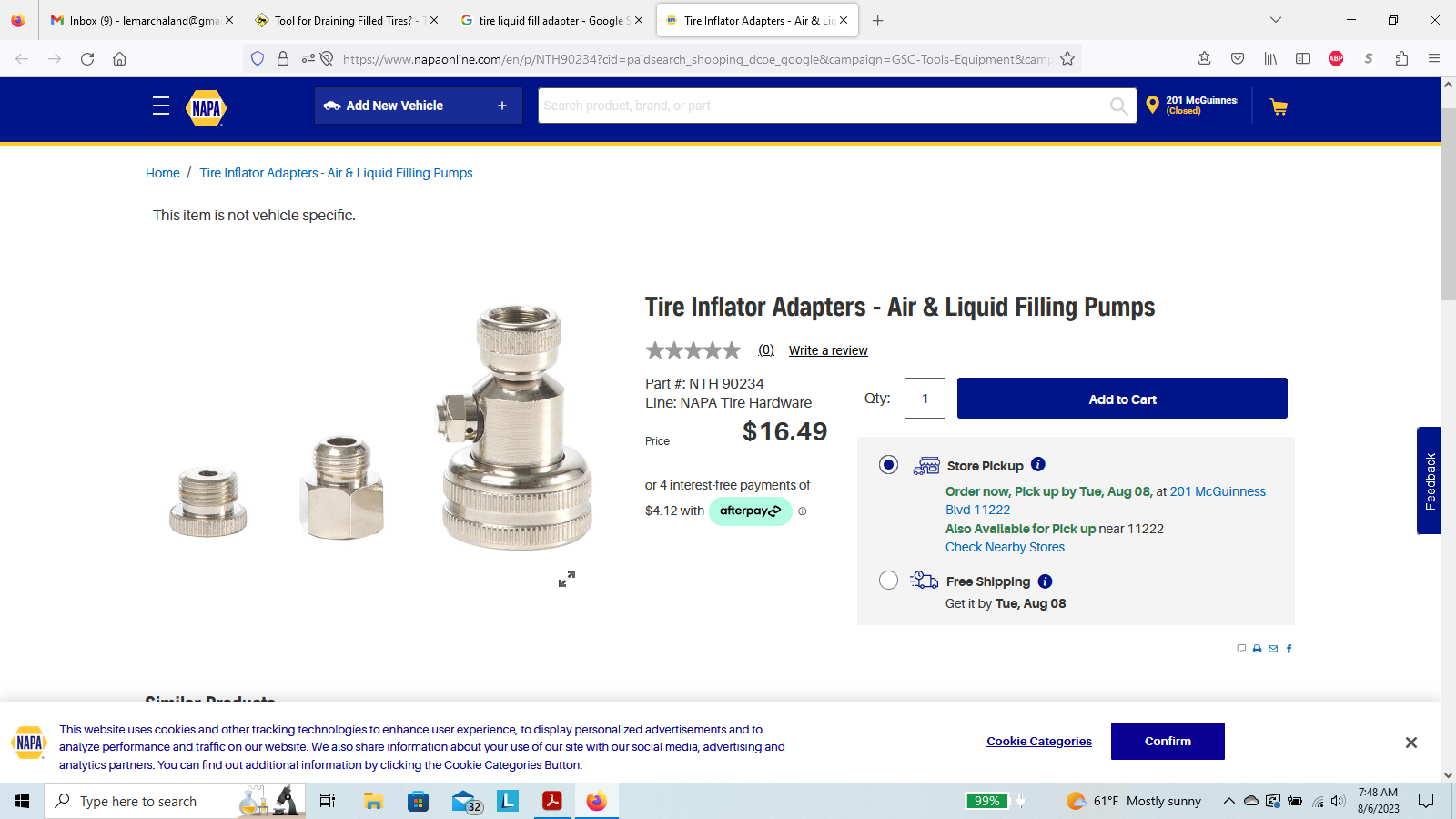

   / Tool for Draining Filled Tires? #7
This valve works for changing Schrader valves so should also work for draining fluid from tires through it.
Be careful when draining fluid if the tire is jacked up off the floor. I have had a bead break loose from the hanging weight and draining process.
