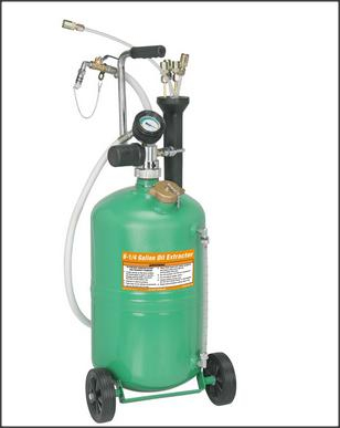

There is a another Harbor Freight option which can also suck out cold 90W gear oil and be used for car brake fluid flushing etc.
Off course you will need a decent air compressor to operate it.
Oh well, it's still a better deal in the long run.
