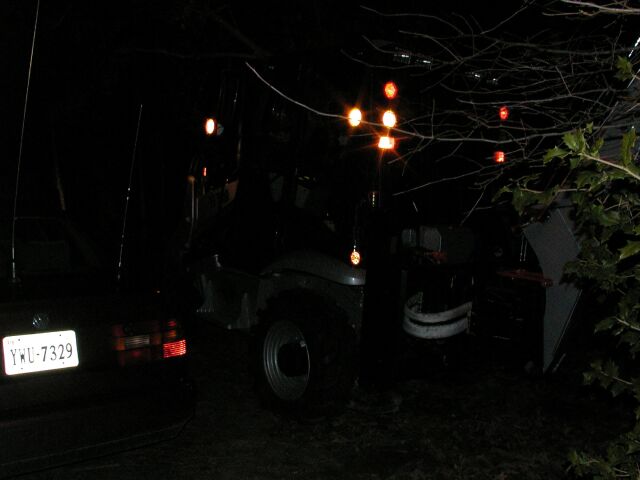

Re: tilt indicators
I finally finished wiring up all the lights today. Here's a picture of the EF-5 with just the "road lights" on: the two rear LEDs and all the side and front amber LEDs are on in "low brightness" mode. (The two rear amber LEDs are off.)

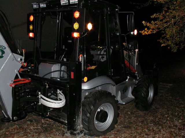

Re: Lights
Here's another picture of the lights. In this one, for some reason, the lights messed up the exposure... /w3tcompact/icons/laugh.gif
Still, you can see that the left side turn signal is on, because the amber LED on the rear right is off. Also, you can see the difference between the red LED's low brightness "marker light" mode, and the amber LED's high brightness "turn/hazard signal" mode. You can also see that the LEDs are a little directional. The front side left one is dimmest because it's the most off axis from the camera. The rear side left one is more in line and brighter, as is the back left side one, though a bit less so. The amber incandescent on the bottom of the rear lights appears very bright, too, but if you look at both of them straight on, the LED looks a lot brighter than the incandescent. I tried taking a picture of the amber LED straight on, but it didn't look any brighter - everything else just turned black, and it was too cold to fool with manual exposures. /w3tcompact/icons/smile.gif
The rear red LEDs' high brightness mode are connected to the brake lights, but aren't on in this picture.

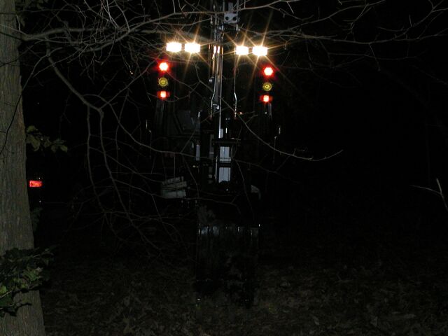

Re: Lights
And one more picture, this time straight on from the rear, with the four worklights also on. The amber LEDs are off, but the red LEDs and incandescents on the rear are on in "marker light" mode.
