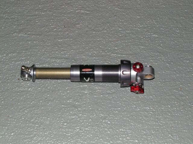

Re: Seat shock...
I finally got the custom shock absorber from Stratos. It started life, before receiving extensive modifications, as a mountain bike shock. Here's a picture of it laying on the garage floor.

   / EarthForce EF-5 enhancements #148
Re: Seat shock...
Mark,
How did you determine the "angle" to mount the shock...?
#149
Re: Seat shock...
John - In this case, it was easy. I just took out the worthless piece of junk that was in there and replaced it with a quality unit.
I think I know why you asked the question. At least, I'll assume I do. /w3tcompact/icons/smile.gif Basically, the arrangement used on this suspension requires an increasing amount of resistance on the part of the shock as the seat travels down, for two reasons: First, the amount of motion in the shock relative to the motion of the seat decreases as the seat nears the bottom of its travel and second, the shock is nearing a horizontal position while the motion it's trying to damp is still vertical. A vertical orientation of the shock would be a lot more efficient use of the shock, and that's what I would to if I were doing it myself (and I may figure out a way to do that with this seat), but I took the easy way this time. Fortunately, the bike shock is quite versatile and adjustable enough to handle the job, even though the deck is stacked against it. It's got independently adjustable extension (rebound) and compression rates, using the red knobs you see in the pictures, and an adjustable ramp-up force rate, using varying amounts of air pressure.
   / EarthForce EF-5 enhancements #150
Re: Seat shock...
So I'll assume now... it's like riding on "air shocks" and not as "harsh"...{the whole machine feel...?}
