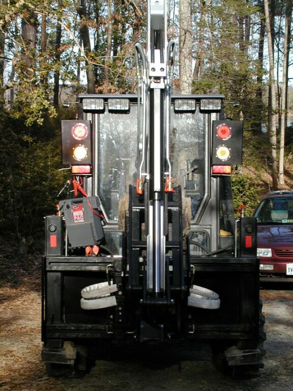

Re: Lights
Harv - Ok, here's the picture you requested. Actually, it's a little worse-case than you requested. The sun is not just shining, it's shining directly into the lights(about 3 p.m.). You can tell that by looking at the lights on the right, which are not on, and from the reflection in the rear glass.
Unfortunately, I've now run into a limitation with the camera. The difference in brightness is still very large to the naked eye - it still hurts to look directly at the amber one (the one that's on, of course) from a distance of 20 feet (I stepped it off this time). But, the main difference you can see in the picture is that the amber reflects ambient so much better that you can the red illumination shows up better than the amber.
   / EarthForce EF-5 enhancements
#113
Re: Lights
Not too sure what happened on that last one. Let's try it again...

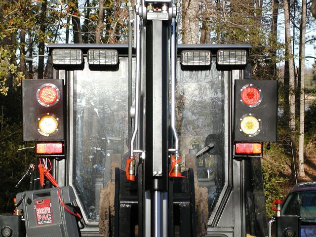

Re: Lights
Another picture of the lights with the sun directly on them.

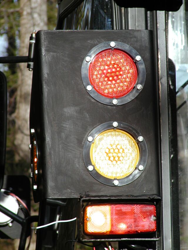

Re: Lights
Here's a close-up. In this picture, the amber light that's in the lower left, the factory turn signal, is on - it's a 21-watt incandescent.

For some reason I lost track of this thread there for a while, but I took a look at your daylight shots just now and dang, them babies is bright. /w3tcompact/icons/shocked.gif
Anybody with eyeballs should have no trouble noticing you coming at them, but I guess they would at least have to be facing you. Now, if you wanted to dance a laser beam out the back, you could probably get their attention no matter which way they were facing. /w3tcompact/icons/cool.gif
