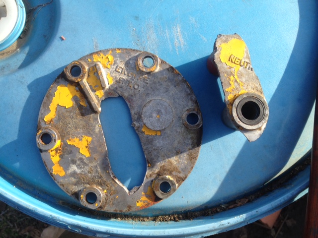

Hey Kenneth, I missed this post. I've already pulled the cover for the PTO lever. It's broken beyond repair. I've also reached in as far as I can and scooped out all the nasty sludge in the bottom, it's easily 3/4" of junk down there. I'll pull the other cover off on Saturday and see where that gets me as far as movement goes in the hydraulics.
In the meantime, here's a picture of the PN on the cover for my PTO lever, first pic. That part number does not match what AGCO has, which is: 181214M1. The back of my plate shows 181269M1
That being said, I found this replacement, but this one says "Ground PTO" in addition to neutral and engine PTO.
FERGUSON, Series, TO35, PTO, Sub-Component, GROUND SPEED SHIFT COVER, 181214M1 at Wengers Of Myerstown
Overall shape looks the same, assuming I use my lever and detent spring this should still work for my needs, yes?

Give these guys a call, they may have it All States Ag Parts | Used, new and rebuilt tractor, combine and skid steer parts they part out old tractors.
Awesome, they're calling me back tomorrow and are pretty sure they've got what I need. Thanks!
