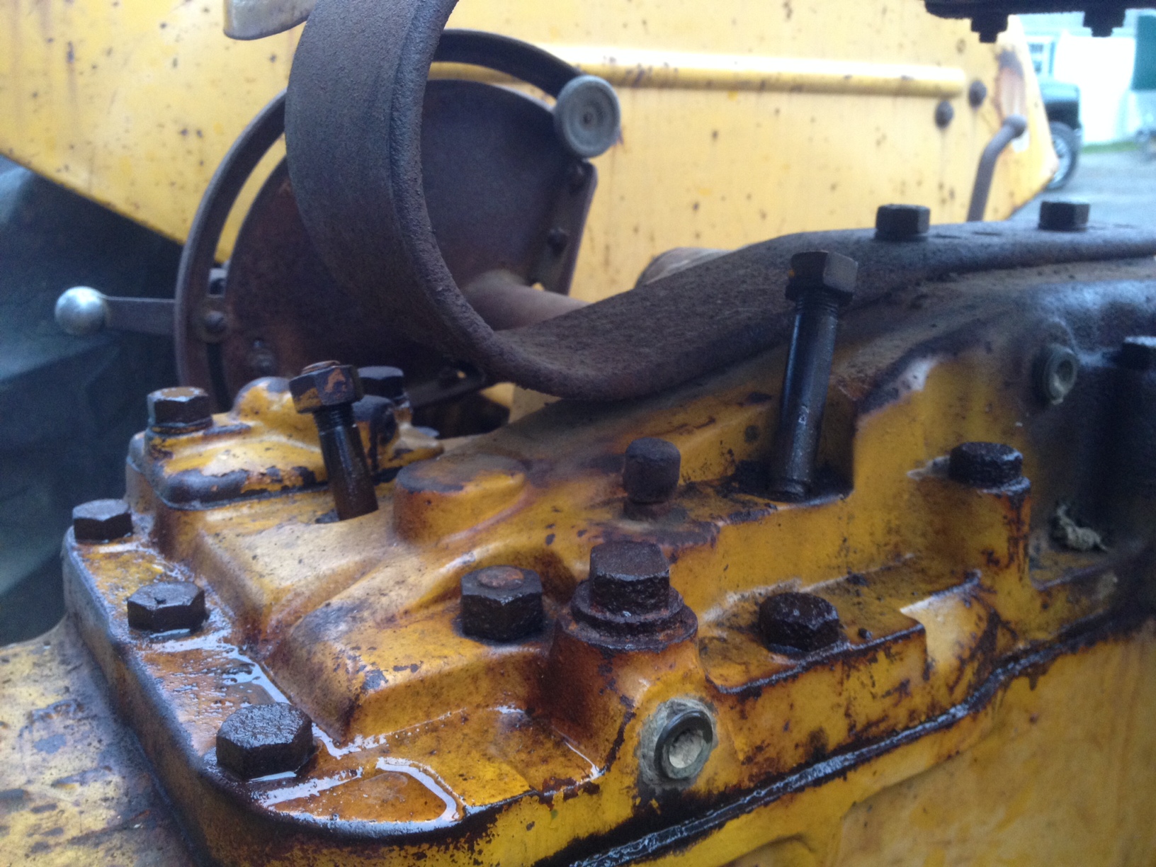

I filled the case with 5gal of diesel, a quart of ATF, and a bottle of alcohol after I cleaned the pump filter screen and put the PTO lever/cover back in place. I fired up the tractor and went to engage the PTO, the lever wouldn't move. It moves freely with a nice solid detend when the tractor is not running, but once fired up it won't move. I verified that it's installed correctly, all is well on that end. I worked the 3pt hitch lever and draft control, no dice, that sucker's not moving. I still let the tractor run, but as I was fiddling with things, I noticed a drip of diesel coming from that 4 bolt inspection cover on the clutch housing. Great. I'll probably have to split it after all.

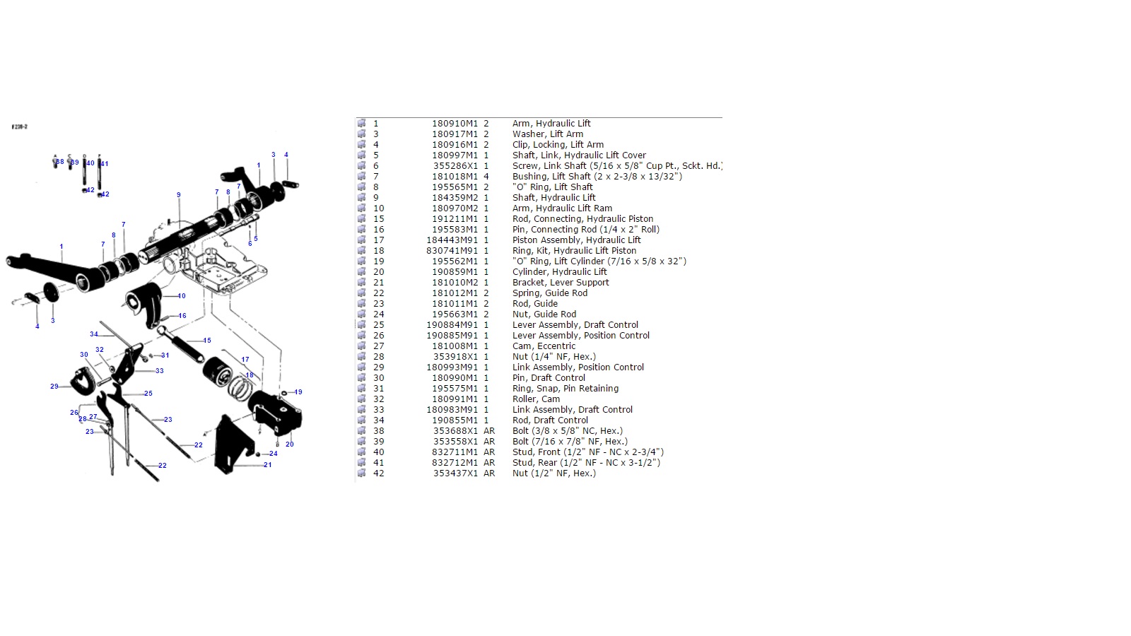

Then I noticed the lower radiator hose was split and leaking, gotta order a new one. Then I started fiddling around with other things, and noticed under the seat, there are three bolts (studs?) that are broken. I can pull them right out. I've posted a picture of two of them, the other is under the seat bracket. I'm wondering if this has anything to do with the 3pt hitch not working. It would certainly make sense. I'm off to look at AGCO for diagrams to see what those studs go to. I'll likely have to pull that cover plate under the seat to see what's wrong down there. Difficult job?
AGCO pic- is item #15 supposed to be parallel to the ground? Mine is not, it's at about a 45° angle.
Edit: from my (very) quick research before I go make dinner, it looks to me like the lift cylinder may be bolted in using those studs. If they're broken, the cylinder surely won't lift anything. That's my guess for now, until someone more educated informs me otherwise. :)

Yep, those studs hold the lift cylinder to the top cover, it probably blew the o-ring between the cylinder, and lift cover. The top cover will have to come off to fix that, one you get to the cylinder you can see what size it is, and look into it to see what it needs (might as well while you have it out).
