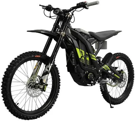

/ E bike recommendations? #83
I was strongly considering one of these.
But it has no pedals, and I'm getting fat! ;-)

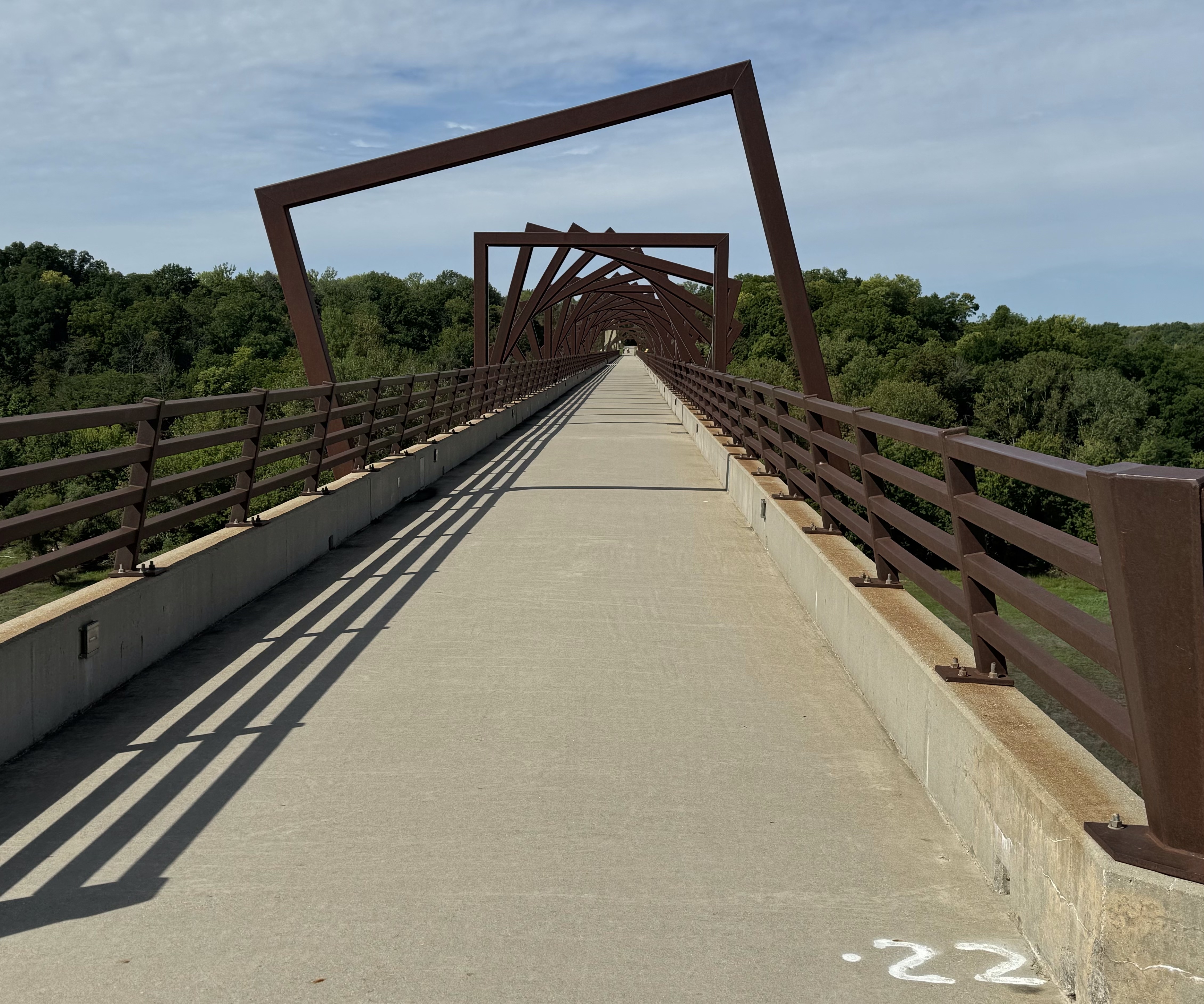

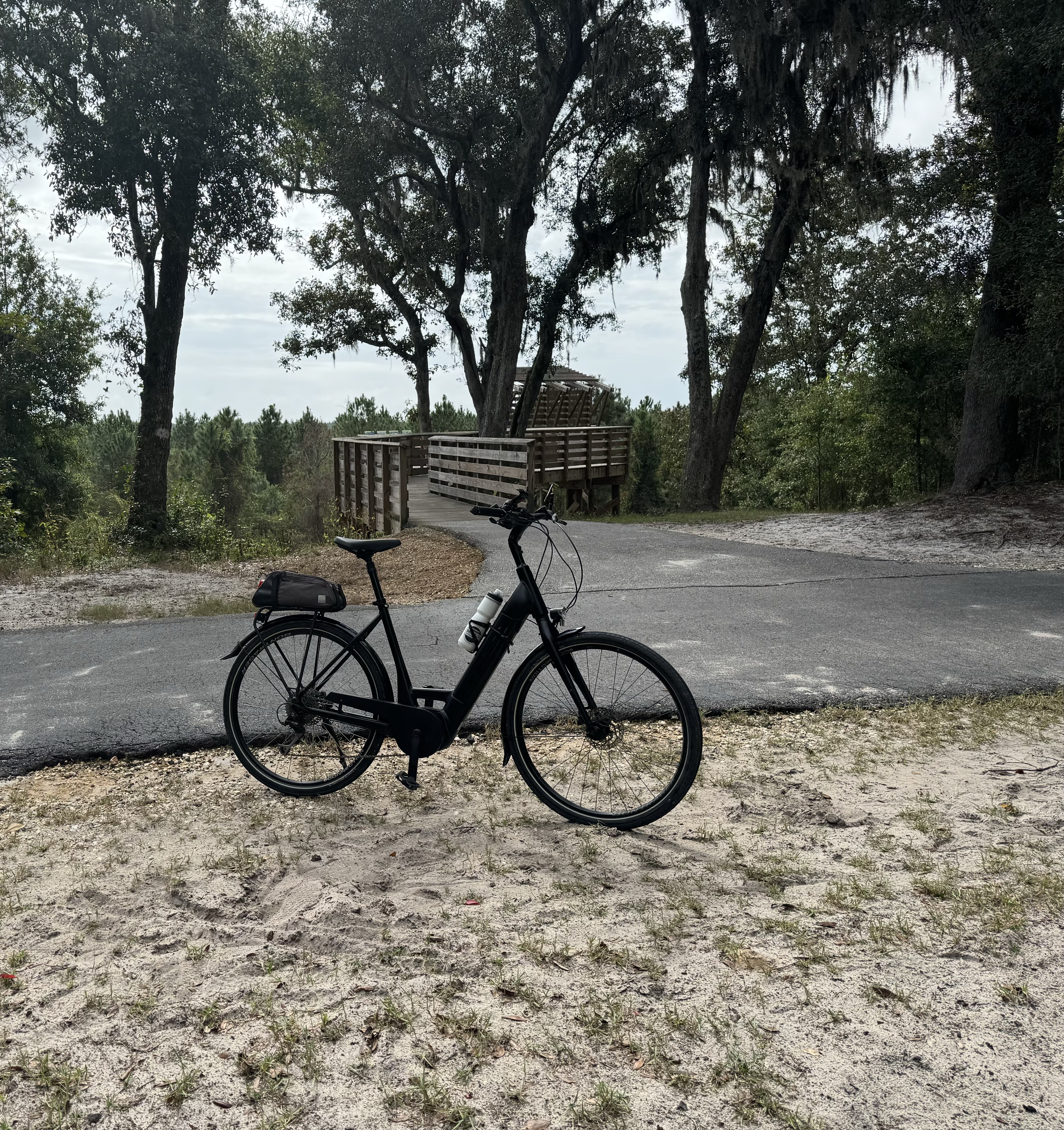

I’m the OP and still riding. I’ve got about 6400 miles on mine. I’ve slowed down not because I wanted to but other projects come up. For example I rode very little this last fall, winter and early spring because I did a lot of firewood.
Last year we went to the high trestle trail in Iowa.
We also hauled them to Gulf Shores last fall.
/ E bike recommendations? #99
View attachment 3804918I’m the OP and still riding. I’ve got about 6400 miles on mine. I’ve slowed down not because I wanted to but other projects come up. For example I rode very little this last fall, winter and early spring because I did a lot of firewood.
I've road and walked across that bridge dozens of times. Well worth the trip. Amazing views and bridge construction.
