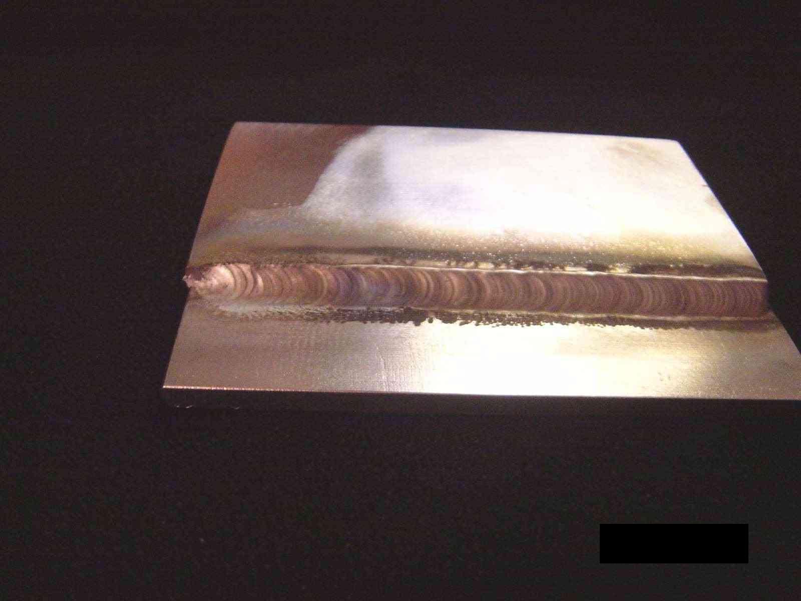

First, the Dynasty 200 will weld 1/2" aluminum to a piece of 1". How? Mixing in helium.
Here is a aluminum Tig weld I did with 100% helium, and my Dynasty 300. With 100% helium you can pretty much cut your amps in half. Down side is, there is a very very small window where the arc will start, and in the last few years helium cost have gone through the roof.:eek:
I like water cooled torches just because they are smaller.

Nice weld!
