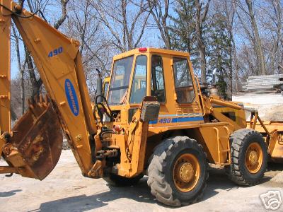

#26
Well I feel much better with my choice now. Like I said I tried one of them out (200-4) and no doubt it was liven large. It was parked in the front lawn of a house that it just ran over. So it seemed impressive especially after owning an early model 580 case. However I didn't like the detriot diesel although I haven't heard anything bad about them except that you can hear them loud and clear. At 38000 lbs I would have to think that mud would be a problem. I compromised with the 490k at 24000 lbs (7 ton lighter) very simular to the 190-4 models. so far I'm very satisfied. Its painted and some decals on it. I will put up pics as soon as possible.

#31
OK I got it all done. New tires, Paint, Decals, Lights, Cylinder seals, Glass, Brakes and of course the heater works and had to have a radio. Enjoy the pics
/ Dynahoe information search #32
Looks Great!! Job well done! Did you have the decals made or find a source? Now we need some action shots! /forums/images/graemlins/cool.gif

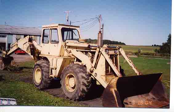

/ Dynahoe information search #35
Recently, I was given a Dynahoe backhoe loader. It sat behind my boss's house for the last 8 years without running. Well the boss wants it gone! I've put in a few hours going over the machine and replacing fuel lines, plug wires, distributor, etc, etc... I'm pretty sure it still needs a head gasket, but I'm unsure what the engine is. It's a 4 cyl. gas motor. Looks like a Ford industrial type. The backhoe doesn't have any identifying markings that I could find. It's got a Drott 4-in-1 front bucket, totally open cockpit. Could this be a very early model? It looks like it should date to the 60's. I'll post pictures when I get a chance. Any info is appreciated.

/ Dynahoe information search #37
Well, with some research I was able to determine mine is a Dynahoe 120. I've no idea what year model it is. It has a Ford 192 inch 4 cyl. industrial gas motor. I got a head gasket for it, and now she purrs like a kitten.....well not quite, but for it's age it's surprisingly strong. I need to address my brakes, or lack thereof, next. The pedals go straight to the floor. I may be in need of some master cylinders as well. The 4-in-1 front loader is quite handy! What a beast this machine is.
