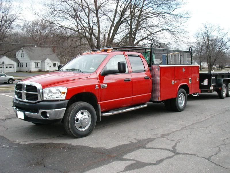

I'm on some diesel truck sites but haven't heard about that yet, have heard about the problems with letting any auto idle for long periods of time, something to do with the fluid not being circulated. I have a Dodge with a Cummins and new in 07, an Aisin 6 speed auto tranny, everybody confuses the name with Alison of course, but the Aison is Japanese!! I know, who would of thunk it, a Japanese tranny behind a Cummins, but they are supposed to be far far superior to the Alison.
Not to get into any brand wars, but you should see some of the brand bashing/flame throwing going on at some of those truck forums, it can be entertaining at times to see how ignorant some people could be. Never seen any brand wars here regarding tractors.
