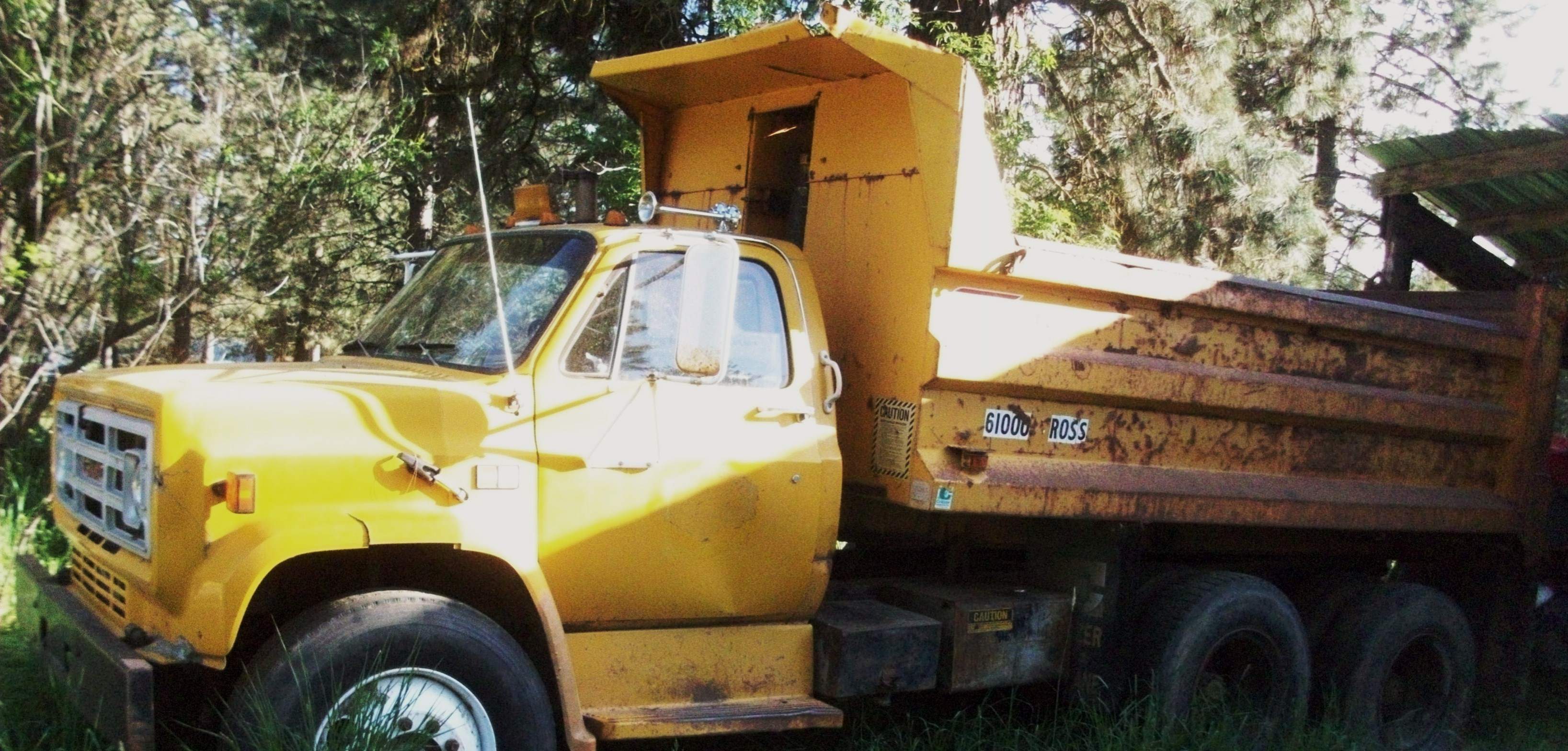

Here is a pic I found on Google of a similar truck, except that the one I've found is SRW.

A SRW pickup with a dumping flatbed will have zero payload. You want a dually 1 ton at least. Even a 7k dump trailer will have a better payload than a 1 ton dump

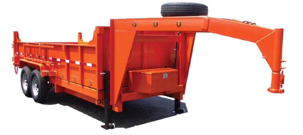

Why ignore something that works? :confused3: The 4" offset ball allows the trailer to be jacknifed when backing.
None of this applies to the OP, a gooseneck dump trailer will work on a super shortbed truck with out an extension. :thumbsup:

The picture you added is of a goose that I wouldn't consider, it has very little upper deck space.
Perhaps useful purely as a dump trailer, but for my uses I want AREA as much as load capacity, e.g. I want to be able to put a couple of tractor implements up there.

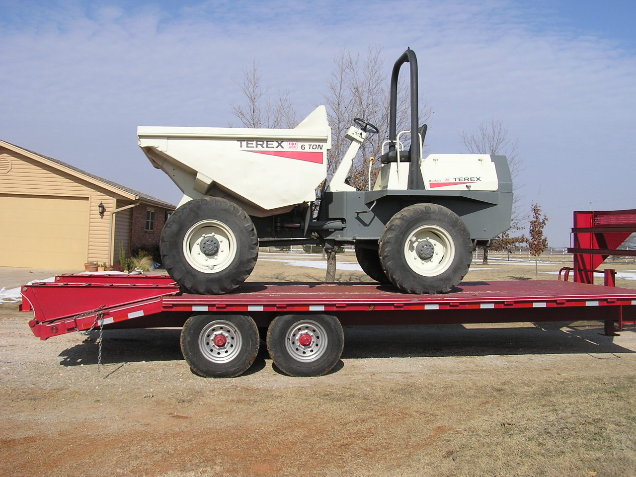

I've been longing for a hydraulic dump trailer to use around the place, but I can't justify the cost of $4500+.
I'd be interested in hearing other thoughts on the subject.

Here is another option for off road use:
Tracked Dumper.
construction-equipment-tracked-dumper-YANMAR-C30R-2---2_big--12121019442898103000.jpg tracked_dumper_1.jpg Tracked-dumper.jpg
Articulated 4WD Dumper.

Wow, I bet those are even more! Problem would be taking it off premises then.
/ Dump truck vs dump trailer #35
Depends on how far. It has a road gear, put a SMV sign on it and it would be just like driving a tractor down the road.
It weighs a little over nine thousand pounds, so I can haul it on my trailer.

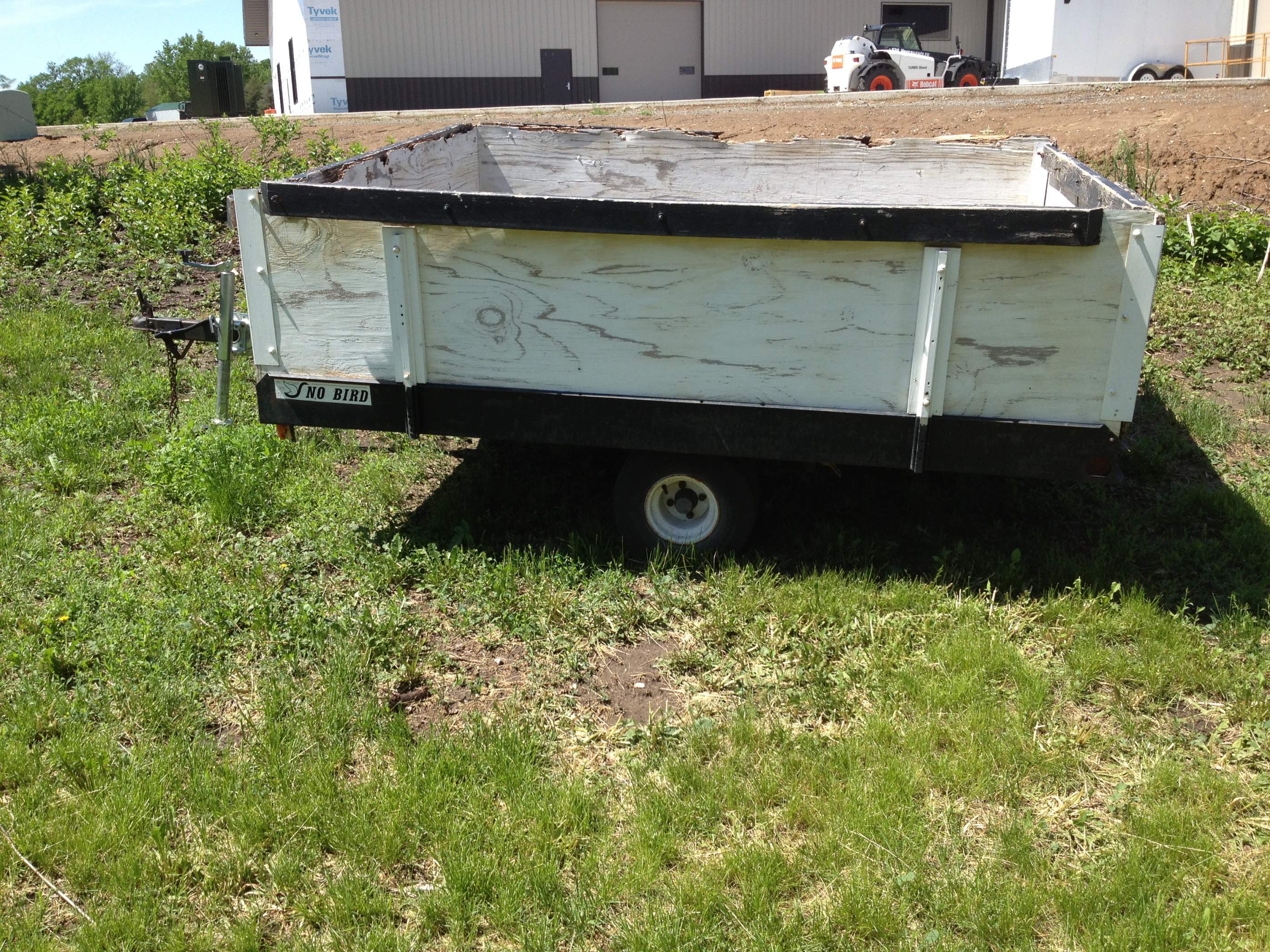

To add a bit of context to the discussion, here is a pic of my existing trailer. As you can see, it wouldn't take much to represent a significant upgrade.
