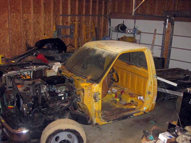

Hey all Ive been posting a few questions about my dump truck project. Well I have another and figured I would share a pic since I know everyone likes seeing pictures.
The ? I would like to find a set of extendable towing mirrors that will fit it. Its a 1991 k3500 I know 88-98 parts fit but looks like the doors are unchanged till around 2002 my sherman body parts catalog looks like it confirms this but a call to the bone yard the guy told me that only 88-98 doors will work and seemed sure of himself. I know I can buy some CIPA aftermarket ones but they are pricey and would rather find a used set but I'm not sure what will fit (I dont care about all the bells and whistles ie. power,heat, turn signals . I removed west coast style and refuse to put them back on after its painted. I figured with all the talent around here someone would know.
Its off to the paint shop next week anyone guess the new paint color?

Its off to the paint shop next week anyone guess the paint color?
If the firewall plate is blank on the color code; then it is one of the SEO fleet colors, look on glove box liner for WA9414, WA5445, or WA5456; these are the most common yellows that do not require a surcharge as a special formulation. Usually requires a 10 vehicle order, or a delay in production until sufficient vehicles are in sequence for special paint option TGK. Some years, the cab and chassis models also have had a few additional colors not available on the regular pickups, but not considered special, it should have a code on plate.

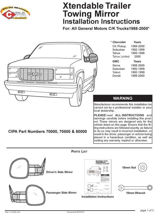

Ok here's some more confusion I got these from the aftermarket company CIPA
one model mirror fits from 88-2000
and then the other model fits 99-06
This messes me up even more so if I had a 1999 or 2000 I could order either model Wouldn't that make it universal from 88-2006:confused: Am I missing something. Only thing that makes sense to me is it has something to do with the wiring?

/ Dump truck project (Mirror Question) #6
99-06 is probably the 1500 and 2500 light duty silverado, the 88-2000 is the 8600gvwr 2500 and 3500 models.
The lighter duty trucks changed over to the newer body style a year early, while the heavier duty trucks changed one year later, in 2000
In other words, the last year for your style truck in a 1500 is 98, while in a 2500 or 3500 it is 2000. GM just had an overlap in body styles depending on how heavy of a truck you ordered.
Part of the confusion is they only show 2 truck illustrations, but show 8 different part number kits; most ikely same head desighn, but different bases to match door style and probably some wiring changes over the years.
