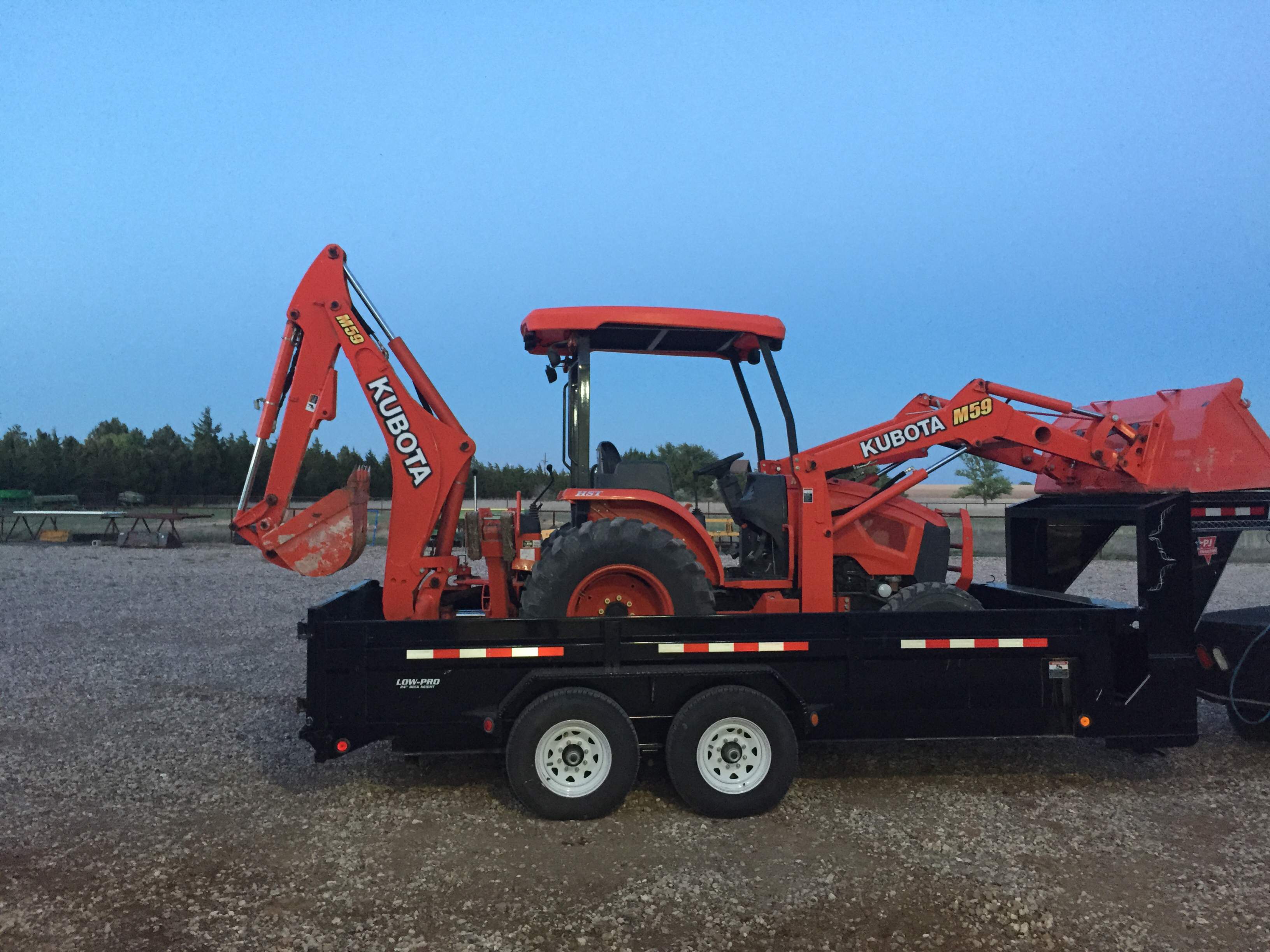

Bought a 16' PJ gooseneck dump today. I really like it so far.
Only thing I need to learn is to know when I have too much weight on it. The 16' is nice because it fits my machine and you could load it plum full of branches or debris or mulch but it has a 8.2 yard capacity with the 24" sides. That would be roughly 18,000lb of dirt. The trailer weighs 5,000 empty so full of dirt it would be 23k and it is only rated at 15,680lb. I filled it nearly full today just moving some dirt across my property and you could tell the tires were not liking it but it dumped it like a champ. I guess one should not load over five yards of dirt in it which is probably a good amount anyway because you don't want a heaping load going down the highway.
My M59 fit and loaded with ease. The trailer is low enough I bet I could load it without ramps using the bucket to lift the front.

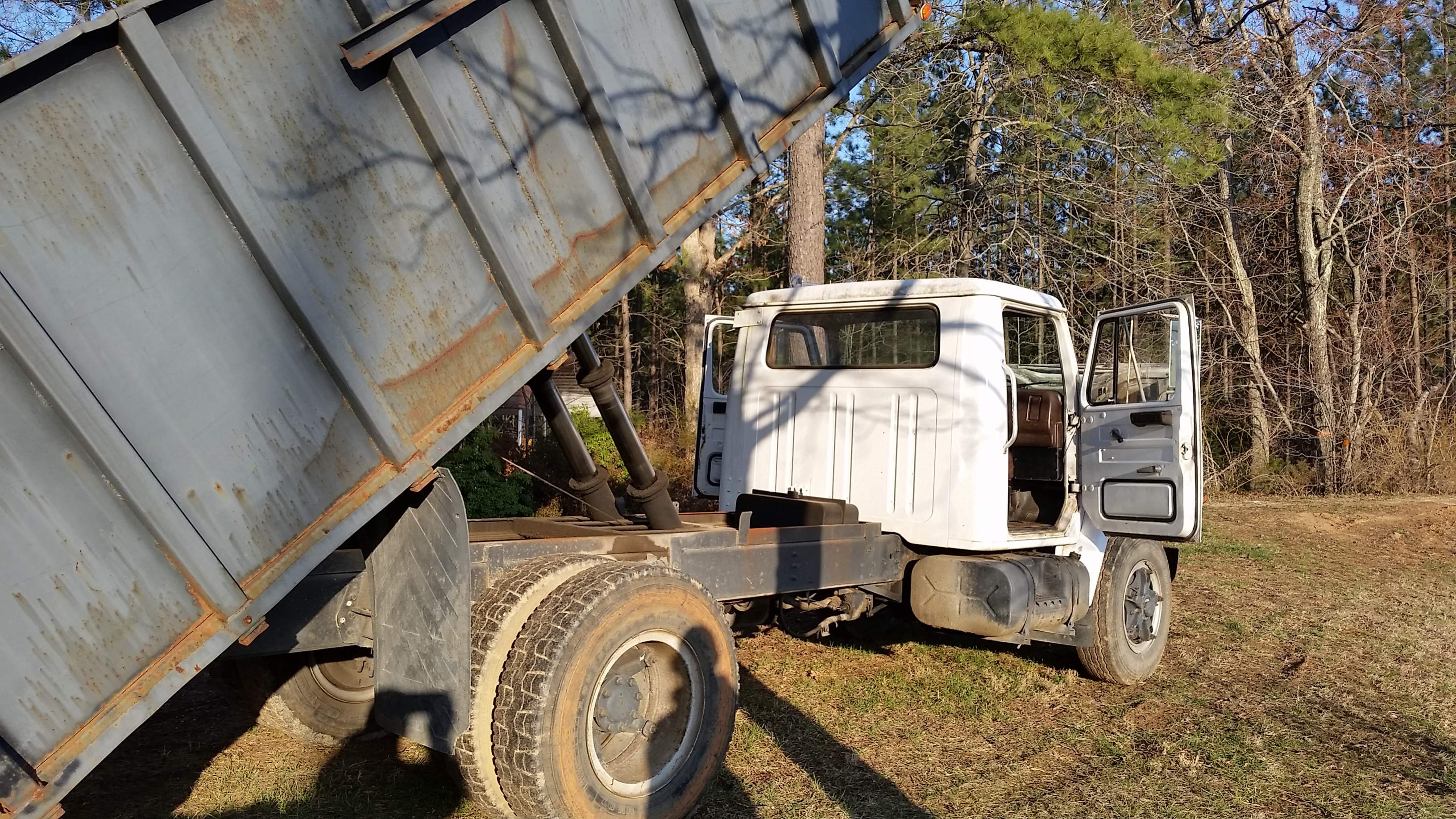

Here is my new 'trailer' :)

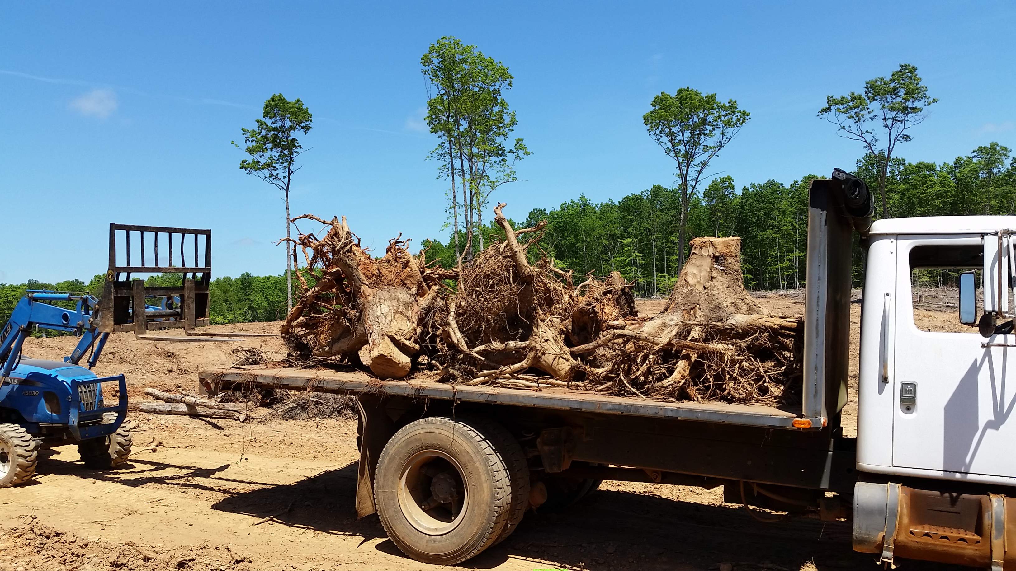

I spent 6 months on Craigslist (or more) pondering the truck or trailer options; seeing what things sold for etc., and I chose an old dump truck. A good heavy duty trailer doesn't turn up used around here often and if it does you can't get to it fast enough to beat someone else to it. If I did get one, it would of cost more than the dump truck I got and my F-150 wouldn't have been able to pull it so a HD pickup + dump trailer was way more expensive than the route I went.
This is a 1982 International S-1900 that started life as a VEPCO power truck. Was auctioned off at 69K miles and converted to a 16ft. staked dump body dump (twin dump cylinders!) with 54" sides that a guy bought and used in his landscaping business and then sold it to his nephew who I got it from (3 owners in 33yrs - not bad). It's got 201K miles on it. It has the legendary DT466 (inline 6 cyl. diesel - 210HP @500ft. lbs. torque) engine in it.
My tractor can't dump anything in it with the 54" sides on (which makes it 9ft tall) but I'm going to cut a 6-7ft. section on each side and hinge it to swing out like a barn door so my tractor can load it with the sides on.
For now I've been using it without the sides ... the excavator guy I hired has been loading me up with stumps and I've been carting them to the corner of the property. Next job is to spread gravel with it building my 1/4 mile road ... something that can't easily be done with a dump trailer.
For my use, an old dump truck was the best option ($5-6K range).
Edit: Oh yea, forgot to mention ... it's a class 7 truck but not registered (is titled) ... Farm Use tags on it ... so no CDL required in Virginia.
