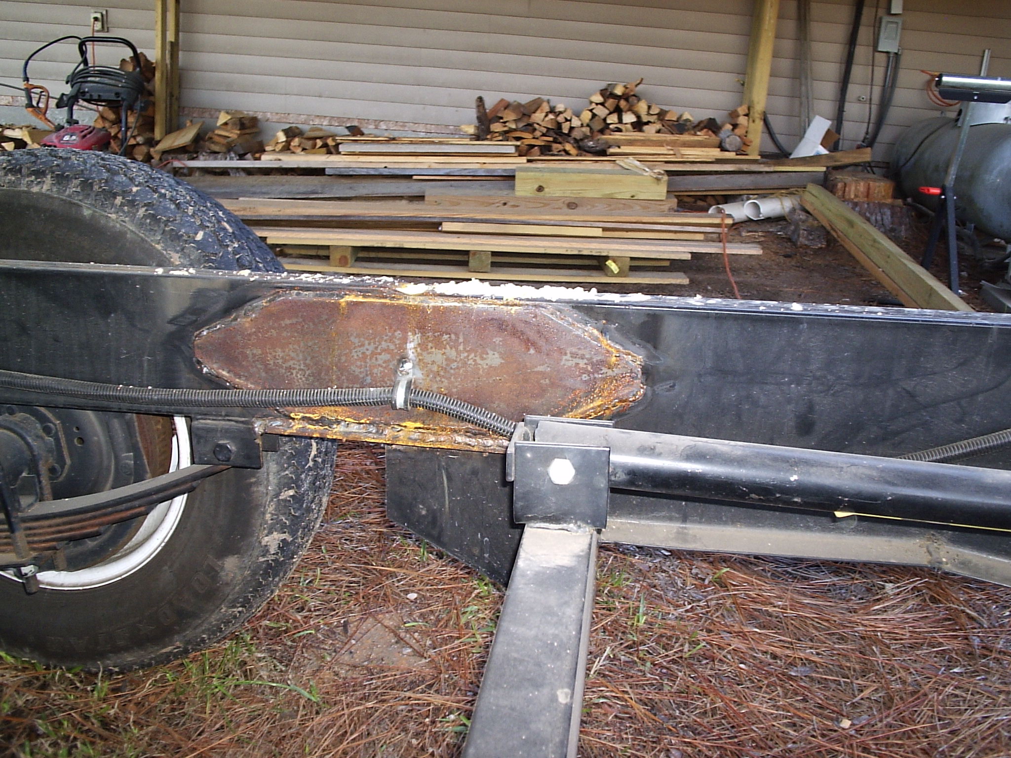

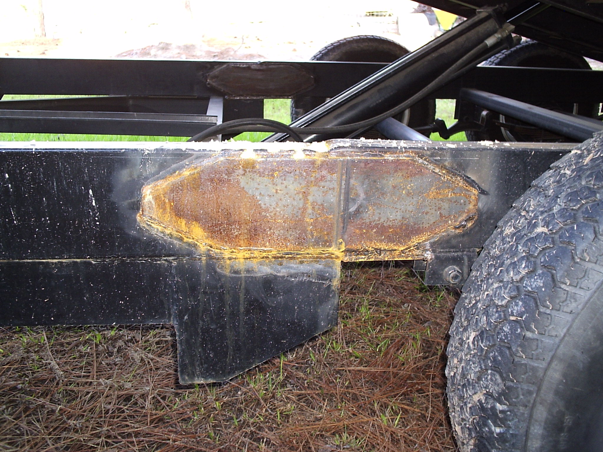

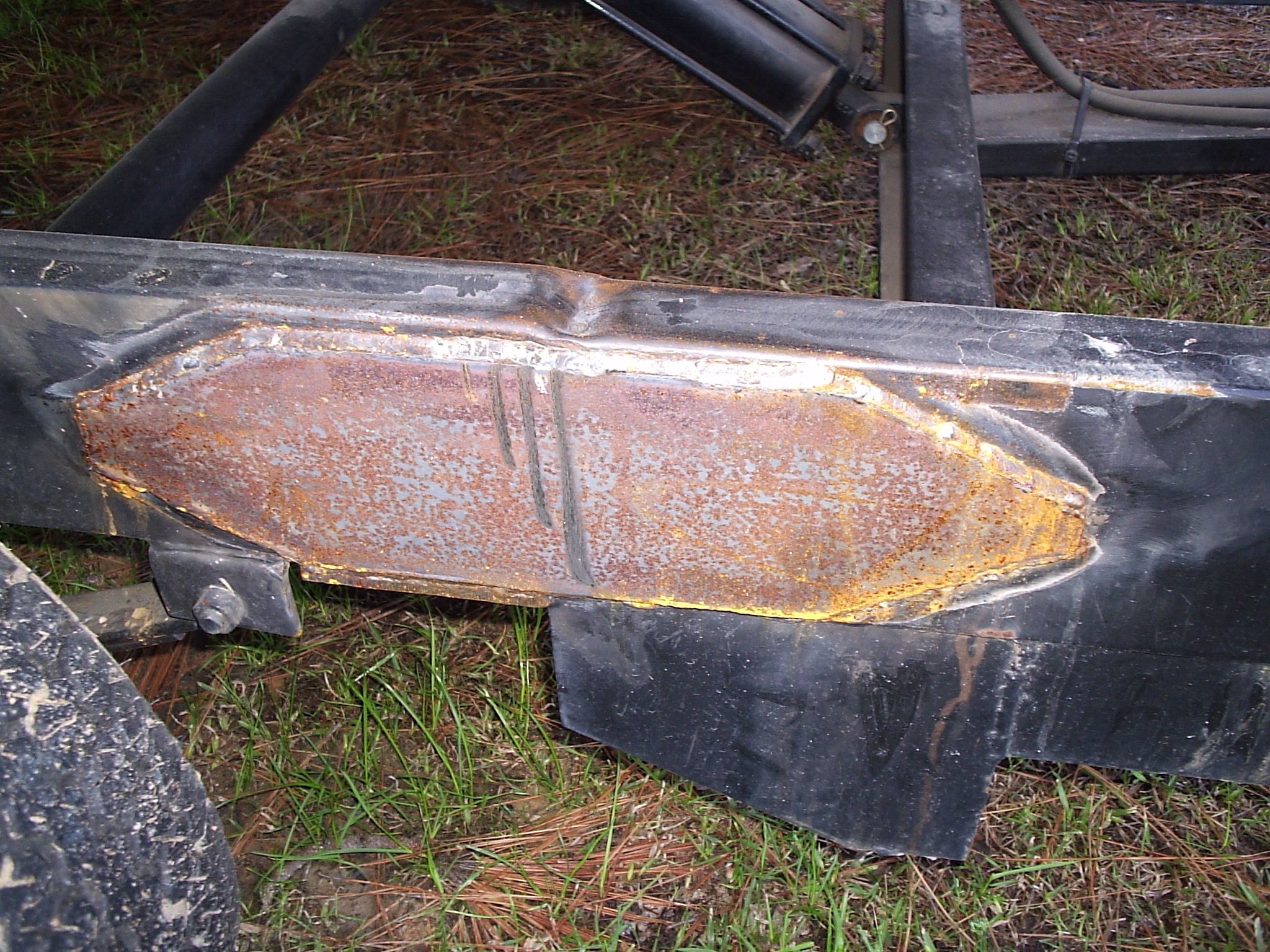

Wish I had taken pics of the broken frame but heres after the repairs. I dont think I have really overloaded it or abused it enough to have caused this but...:confused3:

When the fame cracked, was it cracked on the bottom, causing the top to buckle inward? Also, from the pictures, it appears that the frame is constructed from box tubing, correct?

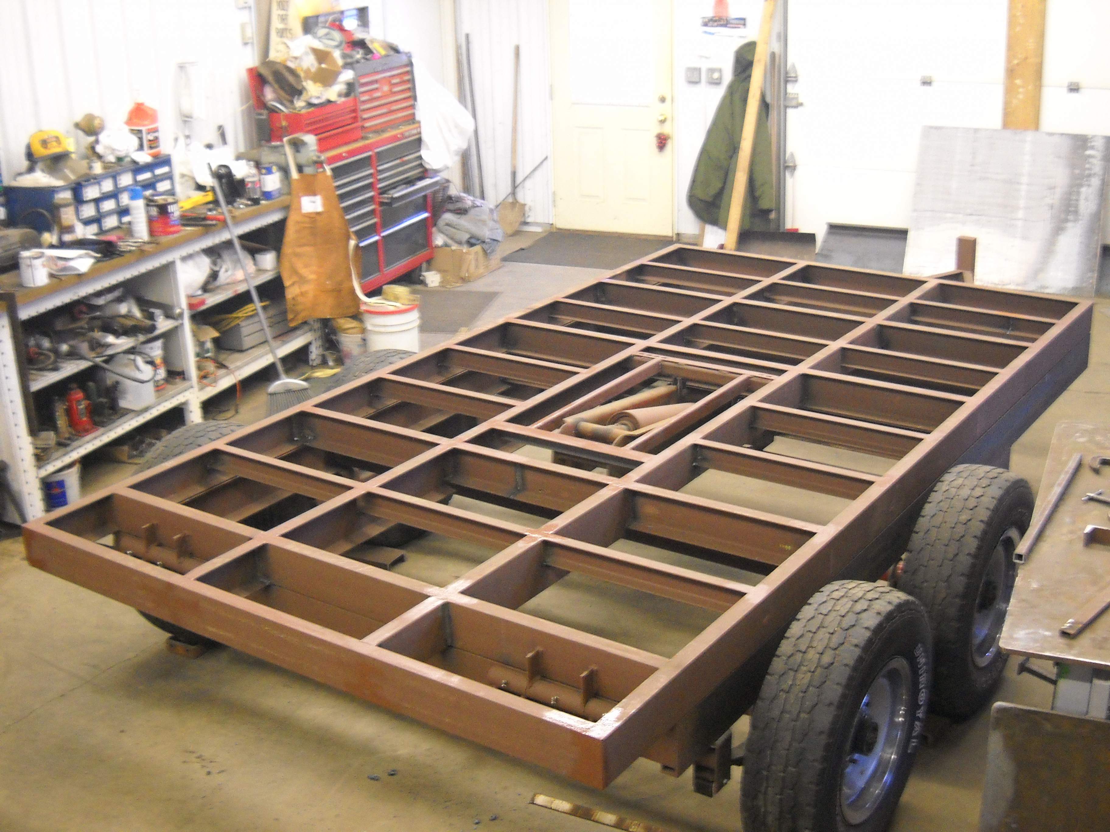

I am building my own 80" x 12' dump trailer. I can't see where they get their 6k plus price tag and some use such lite duty metal they are bound to fail. Mine is 6" channel frame and 5" cross supports. I have 10 guage 5x10 sheet steel bent for the floor / sides. Sissors type hoist and Dexter 7k axles. Materials alone I am looking to get it finished for two grand.

They are not using light material just to save money, it's to save weight. Your home-built trailer looks very solid and rugged but will probably weigh so much it barely has any payload left...

I was thinking the same thing, and having 7k axles will leave even less payload available.

I doubt it will weigh much over 4,000# completed so a 5 ton load will be possible. That is plenty for a dump trailer that size.

I was originally thinking that the combined weight rating of the axles was 7,000 pounds but after looking at his post again, it appears that each axle is rated for 7,000 pounds, for a total weight rating of 14,000 pounds, which I agree leaves plenty of capacity.
