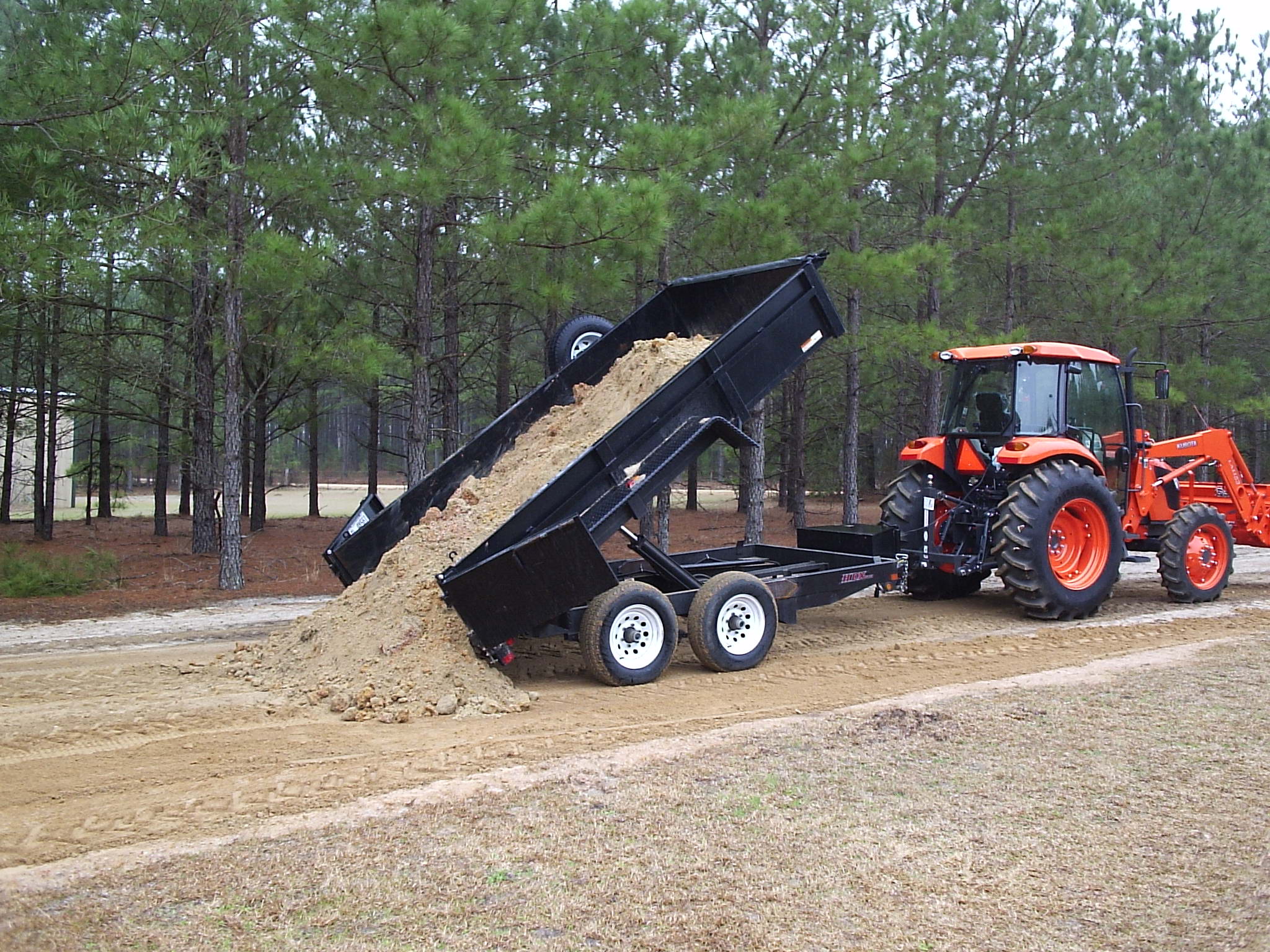

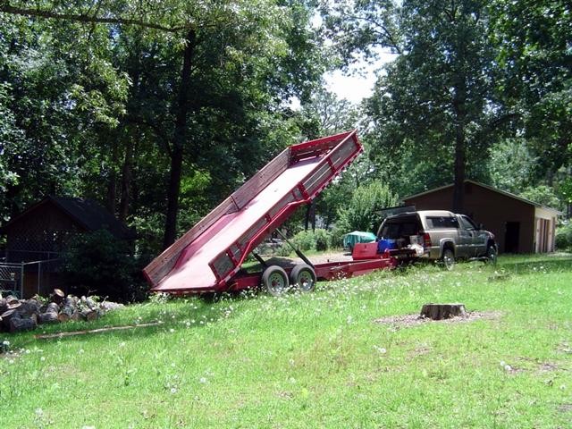

Here's mine...it's 14k. I welded up removable sides and tailgate when I first got it. It has slide in ramps under the back. Good all round trailer.
