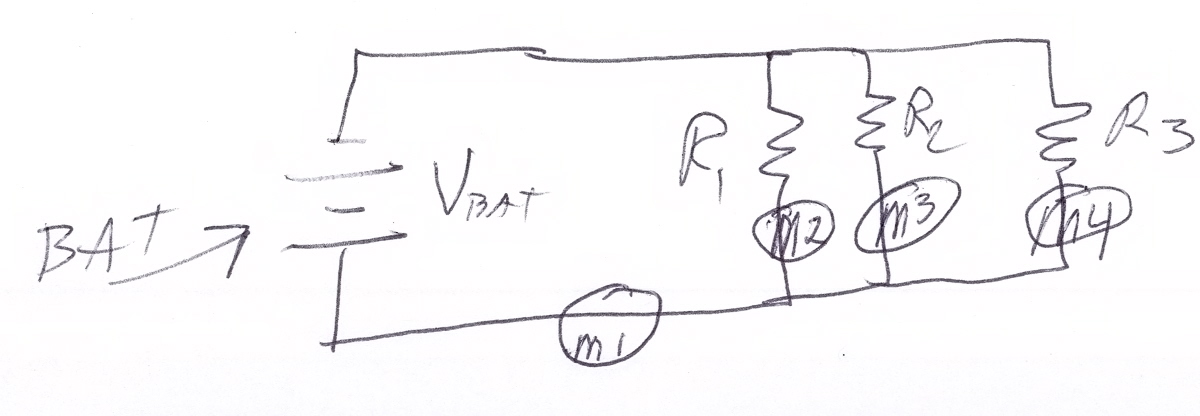

Excellent advice in all respects except one small technical nit which we seem to be hung up on.
The dumb wires and electrons don't act like a computer.
One of my favorite Einstein quotes is: "Make everything as simple as possible, but no simpler. I don't always achieve this but it is of interest.
The statement "Electricity takes the path of least resistance" is often made and nearly as often shouldn't be made and is frequently just not true or is not the whole story!
Electricity takes all available paths, including the one of least resistance but not excluding others.
If electricity "O N L Y" took the path of least resistance then you could only have one light or appliance on at a time because only one of the loads could be the path of least resistance. In a car you could only have one light on at a time and blowing your horn might turn off the radio or ignition coil. This is not the case.
Current flow is proportioned according to resistance in the parallel branch circuits. Similarly both batteries in the setup discussed here make a contribution. The way they share the load differs depending on their internal resistance, and external resistance (connecting wires.)
In the attached drawing (If it got attached) you see a batt and three loads in parallel (typical way they are used.) Meter #1 will register all the amps flowing from the battery which will equal the sum of the amps flowing in each of the three parallel circuits.
You will NOT see the current taking (just) the path of the least resistance. You will see the total current flow divided proportionally between all the parallel circuits in inverse proportion to the resistances of the individual loads.
Resistance total is equal to 1/(1/R1 + 1/R2 + 1/R3)
Total current is equal to the battery voltage divided by the total resistance as figured with the above method.
Similarly if there are multiple batteries in a circuit the current is apportioned according to the resistances. Batteries have internal resistance. This is what causes them to not be able to supply infinite amps.
Deep cycle batts have higher internal resistance and so will supply less amps when heavily loaded. combo batts, i.e. deep cycle and starting rated batts have lower internal resistance and plate construction to support some high current draw as well as deep cycle action. They are neither fish nor fowl neither a really good deep cycle batt nor a really HD starting batt but are sometimes the compromise you need.
With the tow vehicle batt and alternator connected to the dumper batt with some decent wire the dumper batt will be helped during a lift. if the wire used is too small the resistance will prevent the alt and veh batt from helping as much. Between lifts the charge rate of the dumper batt will not be so critically effected by wire size selection (12 ga vs 6 or 8) since the current will be much less.
If it were mine I'd use a couple runs of 6 but 8 will be pretty good. 10 or 12 ga wire won't save enough money to warrant losing much of the assistance of the alternator and tow vehicle batt. Again, use multistrand.
Pat
