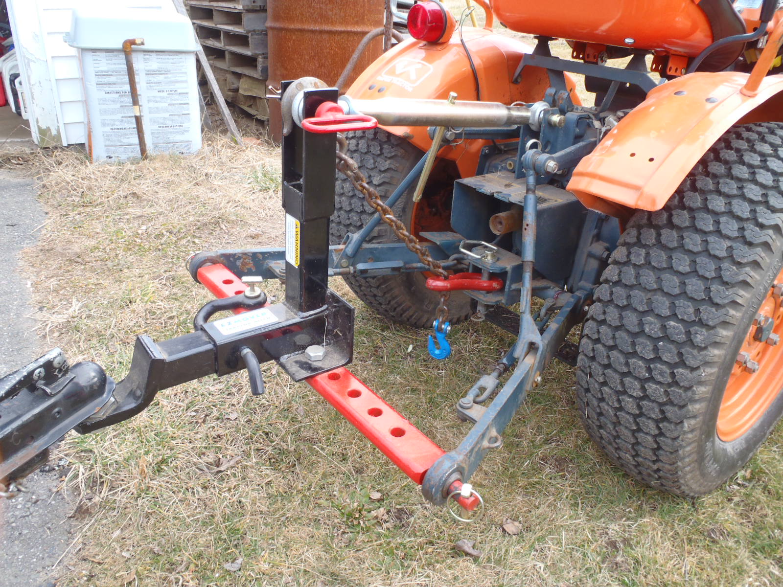

Leejohn makes two good points. When backing up it's possible to bind the drawbar and get yourself into a "jackknife" situation. When this happens, if you keep backing up your inside rear wheel will start lifting and you're on your way to rolling over. Don't ask how I know. As for the 3pt lifting, that can create a whole other set of complications. This happened to me with a load of wood, going uphill, the load shifted aft and the tail of the trailer dug in. The result was a loss of traction that took some futzing with to get the load back in front of the trailer axle. You can limit this tendency by securing the 3pt hitch with a chain. Just make sure you make a good, secure connection between the toplink and the drawbar:
I like the idea in the picture. I took it out yesterday with a lighter load and had no issues. 4wd and medium. On dump, it put some upward pressure on the 3pt, but didn't lift it. I use one of these. Heavy Duty 3 Point 2" Receiver Trailer Hitch Category 1TRACTOR Tow Drawbar Pull | eBay
I'm now thinking of flipping it around so I can chain the D-ring to the drawbar once the trailer is hooked up. If I can keep the 3pt down, the tractor weighs enough to dump a whole load.
