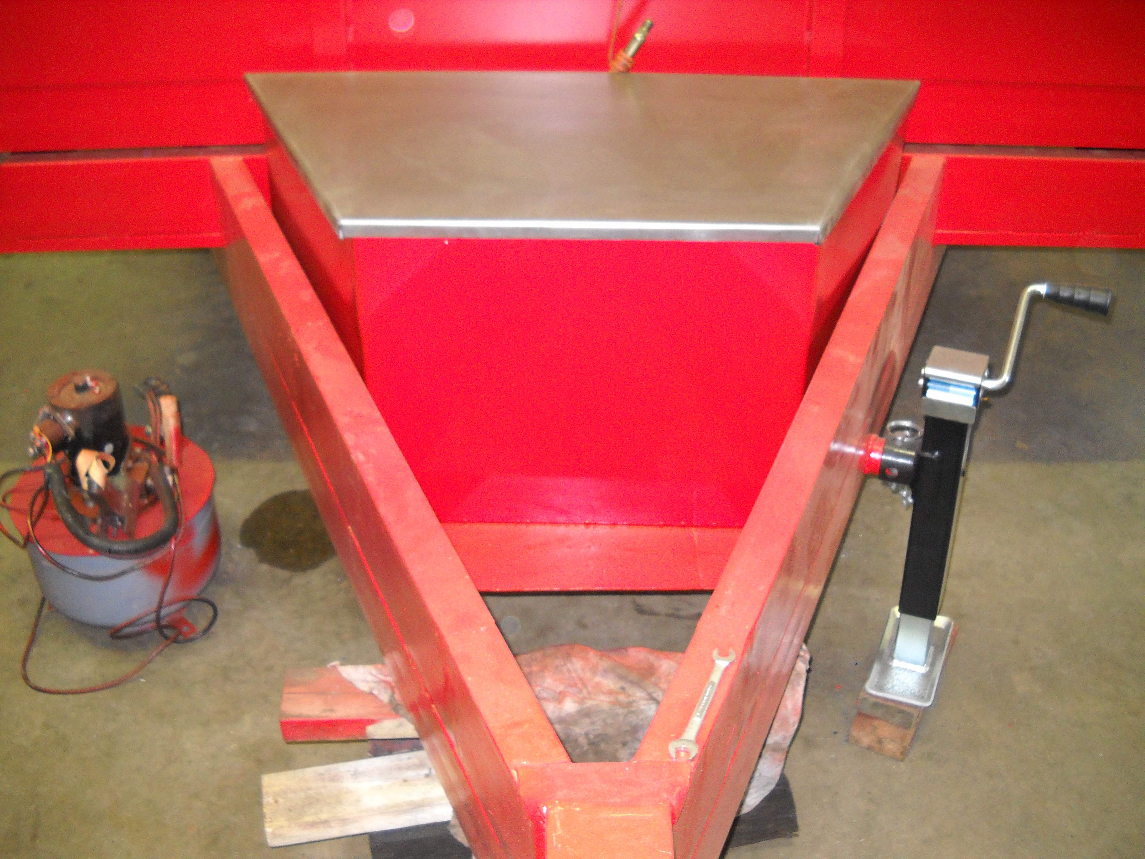

Finished my 12' dump trailer and need to build or buy a container to hold straps, battery, and electric pump. It came out as an odd shape, 27" at the rear to a front taper approx three feet in width. Anyone have any ideas on construction ( tin or aluminum ) and needed features?

I found those pictures also. The problem lies in the limited space I have to place one. I am leaning towards sheet metal bending the structure to the size of the V hitch C channels. I have acess to aluminum but would have to bolt it as I don't have a tig welder.

Solved the battery / hydraulic pump storage box. I built one out of 20 guage sheet metal. I could not find a prebuilt unit with the right deminsions I have that would look like it would belong. The oil reservoir and pump are 16" tall and I needed this distance to make everything fit. It turned out fine and for less than twenty dollars in material. I had enough left over to make a mid mounted mower transition to eight inch flex hose for a lawn vacuum I am building.
