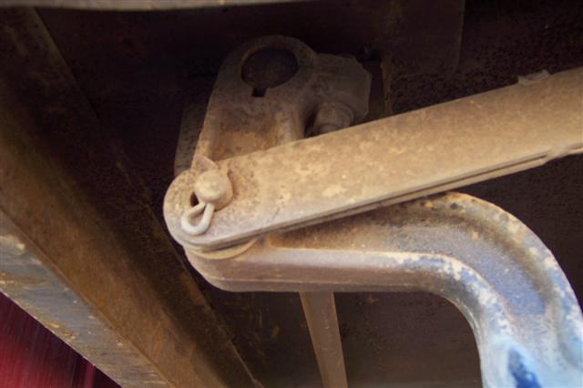

I think I forgot to mention that I plumbed the gate cylinders in parallel with the tilt bed cylinders. Doing it that way has the following advantages:
1. No extra valve needed to operate the dump gate.
2. The gate opens automatically as the bed is raised.
3. The gate locks closed when the bed is lowered.
4. I don't have to get off my tractor or dozer to latch / unlatch the dump gate.
5. I was able to use cylinders I had laying around as leftovers from another project.
6. It's a two way tailgate.
The only time I have to operate it by hand is in tailgate mode to load / unload building material, and normally one would do that by hand anyway right?

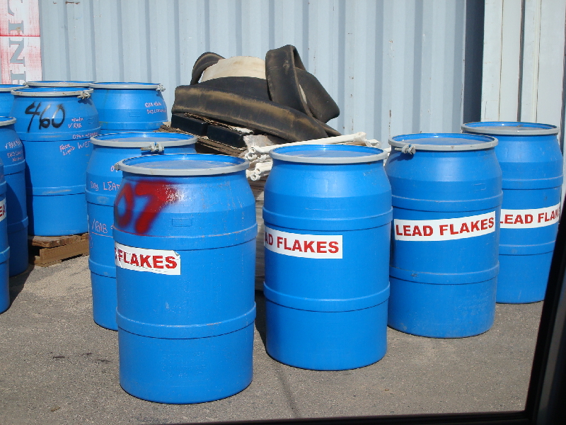

I don't have any lead bricks or wet cement to haul around and dump, but how about these barrels of lead flakes? does that count?
Larry

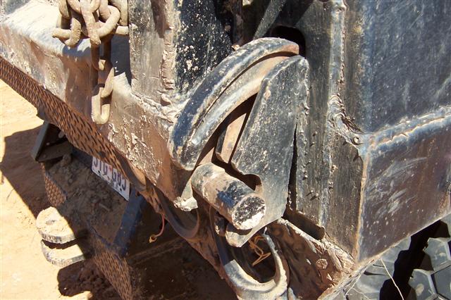

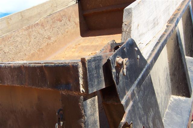

The only thing I would say is that the rear corners look like a potential weak area. It wouldn't take much to make mincemeat out of your precision gate assembly should some idjit mistakenly twink a corner inadvertently.
If you go by a model such as the good old Army M150 (or is it 105) trailers, they all have an external gusset that braces the sides. I'm sure you've though of this, but I just wanted to put that out there as a suggestion. My experience is that no matter how nice you make something it will get messed up with use.

Thanks for the gusset idea. I think I have a good understanding what your referring to. We shall see how this new "precision" (thank you very much) :D tailgate holds up over the long haul. You may have noticed from the above pictures, so far I've already used the heck out of this trailer. If I somehow manage to tweak the tailgate, then back to the drawing board for sure with the "o2batsea plan B" gusset reinforcement idea. I'm pretty sure though that if I tweak anything while hauling it with the dozer, the entire trailer will be a piece of scrap :eek:. At that point fixing the tailgate might be the least of my worries. This trailer was made from scrap to begin with, so it wouldn't be a total loss right?
