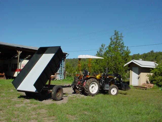

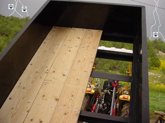

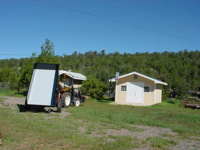

My wife and I took the new trailer up our hill and loaded it up with about a 1/2 cord of cut firewood.
Well I could not help myself. This is the very first time we have used the new dump trailer. And I wanted to see if it would lift a real load. I didn't want to dump the wood just lift it a little to check it out. It lifted it like it was empty.

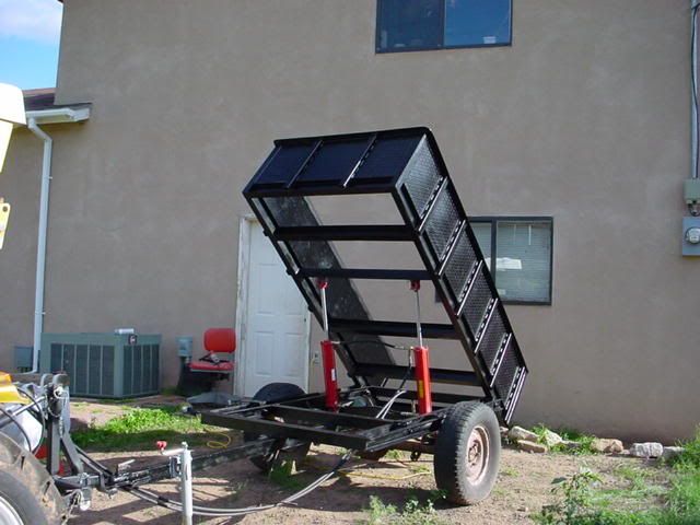

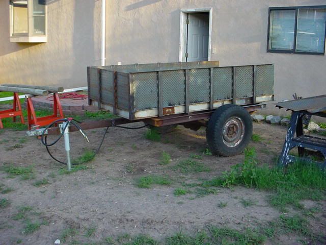

On your leaf springs, it looks like both ends are rigidly connected to the frame. I think one end has to float lengthwise to let the springs flatten when loaded.
Also you may have considered this but some cheap structural insurance would be to weld a diagonal strut between where the top cylinder attaches to the floor joist, and the side rail. (I couldn't see how you did the other end of the cylinder) I think the stress on those points is very high at first when lifting near horizontal and mostly wasted trying to stretch the trailer. On a related note, I noticed on my commercially made dump trailer that the cylinders didn't seem to move any faster when disconnected from the bed than when under a full load. I think this is because they use flow restrictors to keep from pounding the trailer when the cylinders open too fast. And that's even with a little 12v power pack and not the high flow from a tractor. This trailer also reinforced the cylinder attachment points on the frame. They put a strut from the attachment points to the next floor joists.

The leaf springs being rigidly connected - yes that is one of the issues I struggled with in my mind for a long time. As you are so observant to notice, I mounted them rigid. My decision to do it that way reduced the height of the bed by at least 6" and of course allowed me to use the end of the spring for the tilt hinge. But of course the draw back was loosing a lot (most) of the spring action. I have seen quite a few commercial trailers where the springs were rigid mounted, as well as most all Semi Trucks.
Top bracing for the cylinders - good point too. The angle iron that they are attached to at the top is 3-1/2" x 3-1/2" x 3/16" (very stout), plus the floor is bolted to it and the cylinders are close to the edges where the I beams and the diamond plating for the sides are. I figured it would work, and so far so good. As far as bracing for the bottom, the 3" channel does not even budge when the bed is lifted. The bed ID is ~ 50"X100" and the load capacity is around 2500# max. In the video there was about 1500# of wood in it.

Yep Jimi is right on. You need to go look at a dump truck latch. Uses an overcenter lever at the front of the bed that operates a latch on both sides. Very easy to build for someone that has the ability to build a trailer. You don't want your latch at the back of the trailer. If you are trying to dump into a ditch or ravine for example, you will be trying to unlatch while trying to keep from falling into the ditch. Put the latch at the front of the bed and it's easy to trip without risking getting behind the bed. You could even fasten a rope onto the latch lever and release it from the tractor if so desired.
Sorry, had to edit here after going back and reading the thread. You will probably survive having your springs rigid at each end simply because you don't plan to load it heavily. If you do start loading it heavily and towing that load some distance you will eventually break the leaf springs. You are making them function stiffly which they are not designed to do You won't find any semi trucks or trailers with their springs fastened that way. What you could have done to prevent height gain would have been to build sliders at the front end of the springs and let them slide to flex. But then you may have found that your springs weren't designed to carry the amount of weight you are trying to haul. Not sure what they are rated to carry.

...........What you could have done to prevent height gain would have been to build sliders at the front end of the springs and let them slide to flex.......
That idea seems to be a good one, it's still do-able with minimal effort. I will seriously consider that for a not to distant future modification.

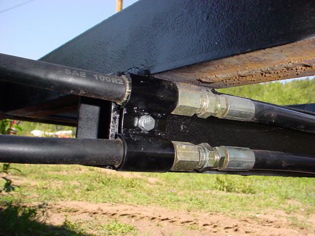

Nice work , nice trailer, I especially like your "bracketry" for the hydraulic lines. Excellent job of documenting progress, and posting descriptions. You may be proud!! Visited Albuquerque , & Santa Fe last year in Oct. nice area and good sites to see.
