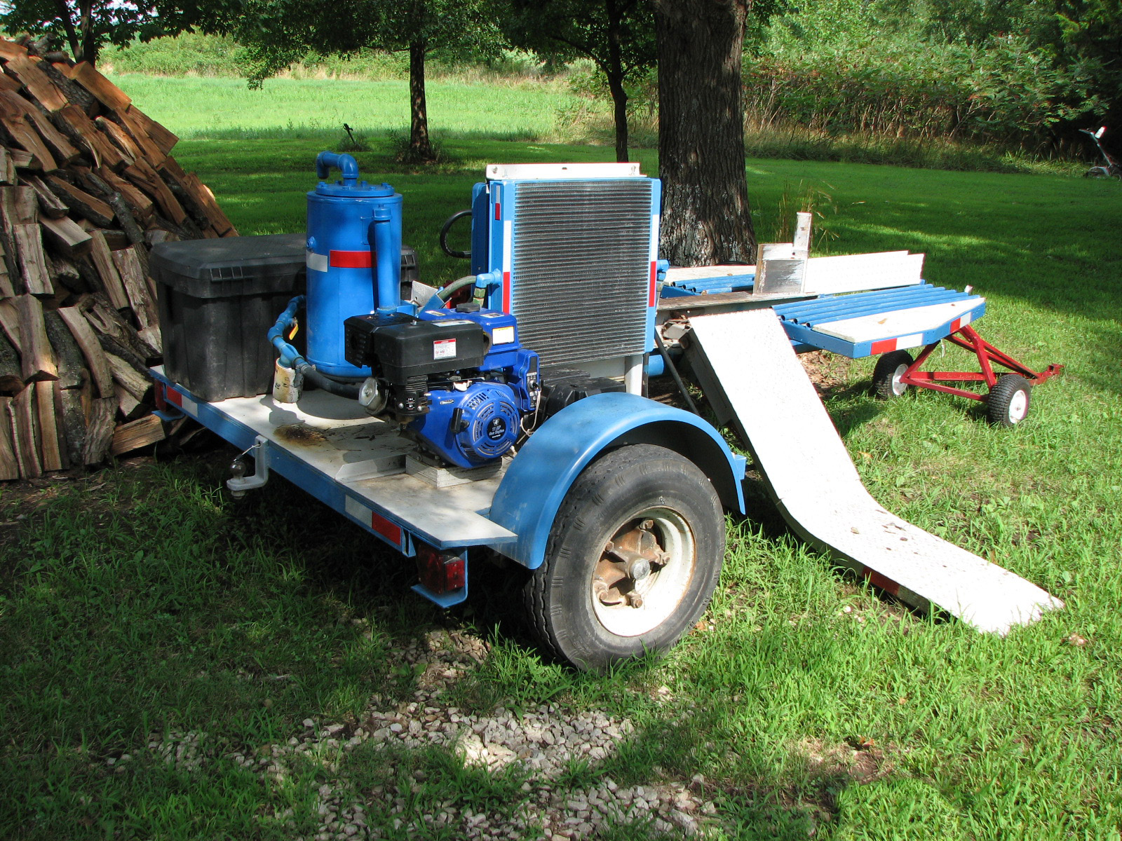

Has anybody ever heard of a dump trailer log splitter all in one?
I have a wood furnace and only one tractor, I don't want to have to drag my trailer back and then have to drive back to get the splitter out of the bush.

/ Dump Trailer Log Splitter? #6
For smaller jobs:
- My splitter has a 5 foot wheel base, 7,000 lb mobile home axle with 14 ply tires is mounted approximately 2' from the rear of splitter. The splitter is heavy enough I can pull a trailer behind it.
- The trailer is just under 16' overall length. It has a 4'x8' bed with 2' high sides (half a cord) and a p/u bed tool box mounted in front of it which contains my chainsaws & accessories. It has a single axle (7,000 lb mobile home axle with 14 ply tires) which is mounted approximately 4' from the rear of the trailer. With the two linked together (splitter first), I can go the speed limit while fully loaded very safely - NO SWAY! The trailer does not have enough tongue weight to pull the splitter behind it safely. This setup has been reviewed & approved by the highway patrol . I am not required to license the splitter even though I use it to pull the trailer.

Yeah at the moment I'm loading my splitter into my trailer(No easy task) and then driving it to the woodlot but when I fill up the trailer I've no way to get the splitter home unless I want to make another trip.
I'm looking for suggestions to build an all in one splitter and trailer, I'm handy with a welder if anyone can help me with some plans to build one I would happy to.

I saw pic. somewhere that had a log splitter as the tongue of a trailer and the guy used the splitter cylinder as the dump for the trailer. Wish I knew where I saw it.
Maybe this is it?
Picture is a little fuzzy but it will give you some ideas.

I put my own design horizontal splitter across the A frame of my 3 cub m3 trailer,Works at about chest height,comfy for me,no bending,loglift/bench holds about 400 lb of logs.Unit is on slide,out in work mode,in when mobile.Catch tray for splits straight into trailer.Only bending done is when cutting logs,and to load loglift.I drive to logs,cut,split,load in one operation.I sell about 400 cub m3 of split hardwood per season,and cut ,split landowners timber for them when they can,t process it themselves as a sideline currently charging $50 per hour,works out for them about half the cost of buying in split hardwood firewood.I recommend an all in one unit,had mine for 7 years,cheers.
