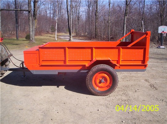

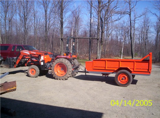

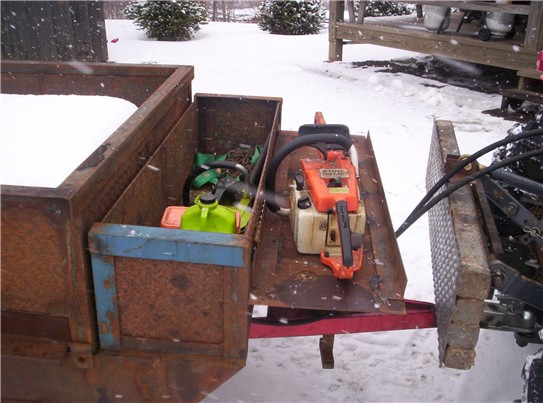

This is my dump trailer. 4 x 8 all steel 1/8 in steel floor 3/16 diamond plate sides. 4 inch bore hyd. cylinder; I use this primarily for firewood and hauling rock. Extended the gate height so the wood/rock comes out without hanging up. Have not had any trouble. Can stack the wood as high as the gate. With the steel floor whatever I am hauling, slides out with great ease. Also have a tool box at the front for my chainsaws, gas, tools, etc. The lid opens level toward the front making a table to work on the saws, fill them with gas and oil.

That looks nice.

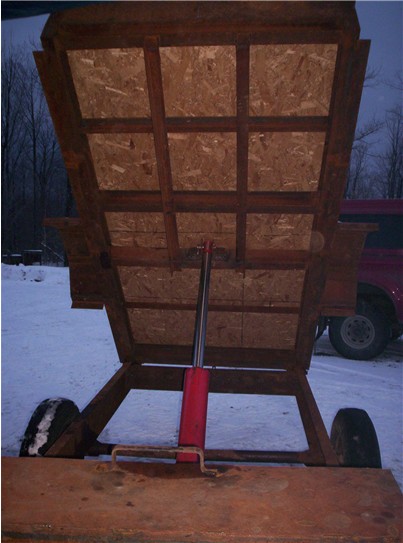

Would love to build something like that. Even the way I treat stuff, that looks like it would hold up. What is the bed frame made out of?
/ Dump trailer for cord wood #7
That's a pretty trailer (and I mean that in a nice way!).
How heavy are those axles?
Did you add the tool box yourself?
.... oh yes ... did you build it or buy it?
Thanks for the pics!

this is when i was building it. the bed frame rails are if memory is correct.(cant measure its buried in snow)4''x 2''x 1/8'' I beams reinforced down the outside web with 3''x3''x1/4''angle. the cross members where the cylinder attaches are the the same way the rails are. the rest are 3''x3''x1/4 angle.the two long angles running back to the the lifting rail are 2''x2''x1/8'' to help spread out the pulling pushing forces. l then got a 4'x8'x1/8'' sheet of steel and stitch welded everything together. i have filled it many times to the top of the gate front to back with rocks picked from my food plot & never had any trouble when dumping. dont know how long the tires will last probably the weakest link.

i built it from scratch. if you could see it up close most of the steel is scrap pieces 1'to5' a friend gets me from work (favor for favor)that i have to weld together to make long lengths. takes extra time but for free steel im not complaining. not sure how heavy the axle is. its a Rice horse trailer axle. the paint was most expensive!!!!!! i knew it would be outside all the time so i used automotive paint so it would last longer. still shines a few years later, with some dings of course.
