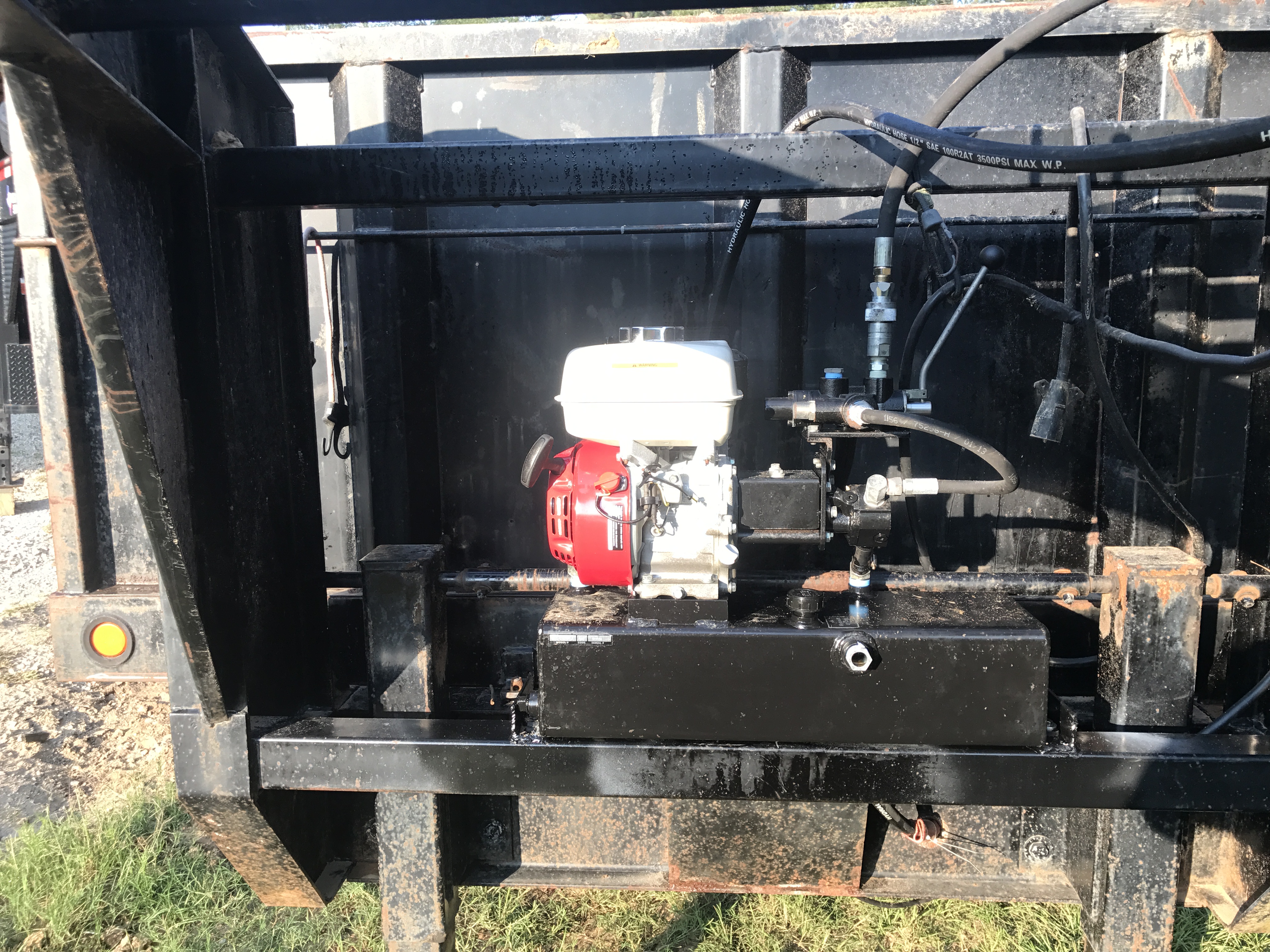

Does that system power your woodsplitter also?? :confused:
It could. It's just a power pack. At 2gpm might be a little slow for a wood splitter but for this it's not bad. Considering putting this one on my deckover and add some hyd trailer jacks and order one with a bigger pump for the dump trailer
Brett
/ Dump trailer batteries )(*&^%&*()(*&^%&*()(*&^ #22
Brett
If you get a two stage pump (11/2 GPM) and an adjustable orifice, you will have the 2 GPM ,
then open the orifice, and have 11 GPM for the splitter.
I accidentally did that on a splitter build, the industrial cylinder had adjustable orifices built in.
