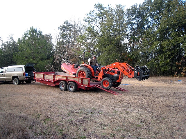

I've got a 20 ft but not tilt, If your thinking that little bit of tilt is gonna help off load material, I doubt it, you'll have to use loader to pull it out. It may help a little and if you were getting a tilt anyway, but I wouldn't spend the extra for tilt just for "dumping"
I've heard about all kinds of Redneck tricks for unloading materials from non dumping trailers, along the line of those crank out, roll up bottoms, some guys put down ply wood under load and pull it off with chain tied to tree, that also works with a length of chain link fence from what I've heard.
If you have a loader which I assume you do with a BH then just screw down some cheap plywood and get in there with the loader to unload. Build up some nice sides they wouldn't have to be very tall at 20 ft long, maybe 18"
That's a really tuff question on what to get, at first I was gonna say get a long dump, but to get all you want in there, I'm not sure but if they do have 20 ft dumps they're gonna be costly.
I also have a 5 ton dump, only 10 ft long, I'm still kicking myself for not getting a longer one, but at the time I thought it was big enough.
I can put tractor in there even with loader, Sticking over the front. but no rear implements.
I use my dump way more than the equipment trailer, but I really wanted the flat bed and I found a great deal on it so it doesn't hurt me to see it sit there doing nothing.
For that budget of yours and a little searching, if you don't need new, you could pull off 2 used trailers. would not be unheard off to find a dumper 3500. and a flat bed for 2500. your not gonna get the latest and greatest of course.
I bought this f equipment trailer cheap in decent condition for around 2 grand, I did pay 6,000 for the dump new.
Good luck, JB.

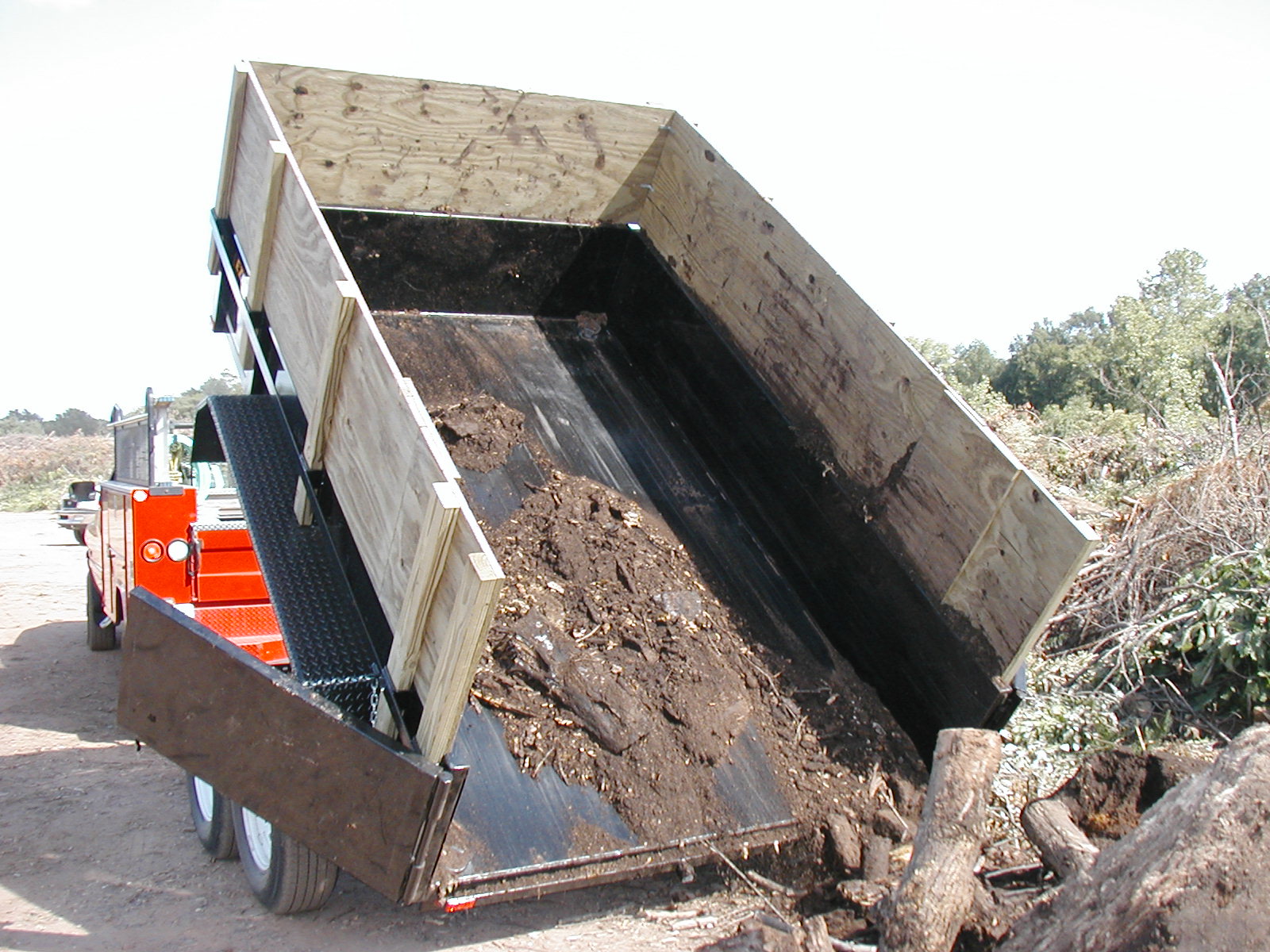

I still have it and LUV it! It is a BMF trailer which is now called Big Lug. I got it several years ago. I made the removable sides and tailgate...
