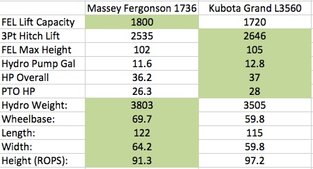

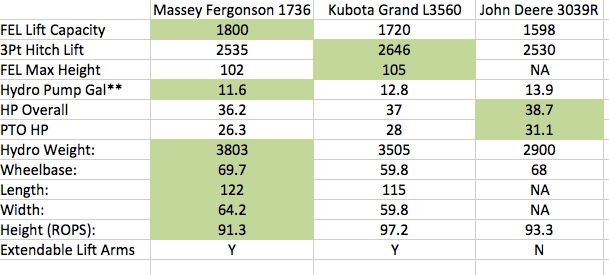

Here is some comparison information that may be of help to you. I too have been looking at a tractor that can lift some sizable logs for a potential sawmill. I am trying to keep costs down so the smallest I am considering is a Massey 1736. But you may need larger.
View attachment 455985View attachment 455986
