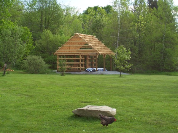

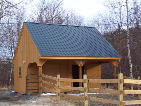

shvl73 said:
I've been thinking of a small dug well ever since I built the little barn for her cows.
You may have posted some pics already, and I just didn't see them,
But do you have any of the little barn you built?
/ Dug a small well this weekend
#23
Here's a couple.

Afternoon Torin,
Nice job on the well ! I didnt see this thread until today, that backhoe sure did a great job !
BTW, how did you make out with the Belgians pastured with the cattle ? Everytime I walk by my neighbors place I look at the Belgians grazing with the cattle and think of you ! ;)
BTW, nice job on the barn ! :)
