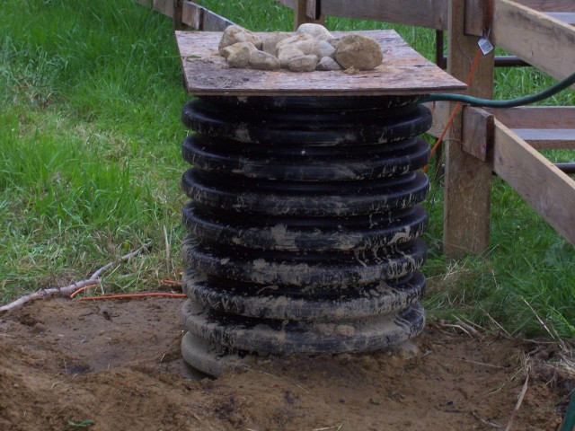

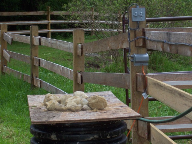

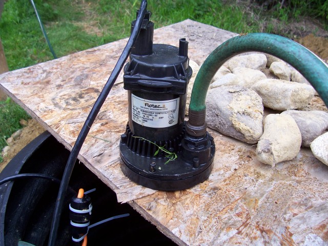

I got a deal on a 24" plastic culvert. Had some ideas on where I was going to use it and never got a round to it. I've been thinking of a small dug well ever since I built the little barn for her cows. This weekend was time for action. I used my backhoe and got down about 7' before I hit some real hard stuff. That was close to max depth anyway so I stopped there. Cut the culvert to 10' and stuck it on end in the hole. The water comes up about 4' from the bottom. I wired in a switched outlet (GFI protected) and used a small submersible utility pump. I put some washed stone in the bottom to keep the pump out of the muck. Works well so far, the water seems really clear and recovery is good. If it doesn't freeze this winter, it'll be a success. It sure beats hauling water from the house.

I'd like to see some pics if you have any. How big was the pipe? Did you backfull around it? Does it fill only from the bottom or does the pipe have holes in the sides?
/ Dug a small well this weekend
I'll try to remember to take some pics tonight. The culvert was a 24" x 20' that I cut to 10'. roughly 3' above ground with just a piece of plywood on top for now. No danger of something falling in and the culvert is made to be driven over so, no danger of a collapse. I didn't drill any holes in the side so, it fills from the bottom. I counted on the water find its own level. Now that its done, I'm thinking I could have excavated around the hole 1'-2' down to give the hoe some more depth and to get more reserve water but, it should work fine for what we need. If not, I'll just re-do it.

Some pics for Slacker:

There you go, what do you plan to do when the "W" word comes to keep from freezing?

I'm waiting to see if it does freeze. I most likely will make an insulated permanent cover. The pump doesn't have a check valve so, it drains back to the source. The hose will be open ended with no slack, so it will drain also. If it does freeze, oh well.:)

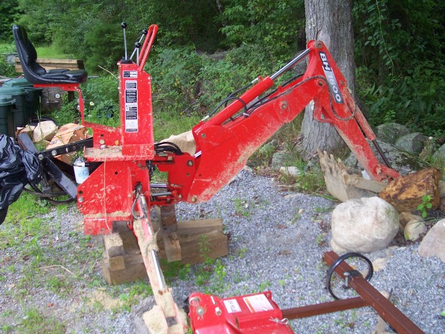

By the looks of the attached picture of the BH you need to make another purchase. Say a pressure washer. LOL :)
The Gotcha Man
Got one. The mud is there so people know I actually use it!:D

I would have to go larger in diameter and deeper to water my garden. There isn't a quick enough recovery in this little well. Also, this little pump isn't made for pressure.
