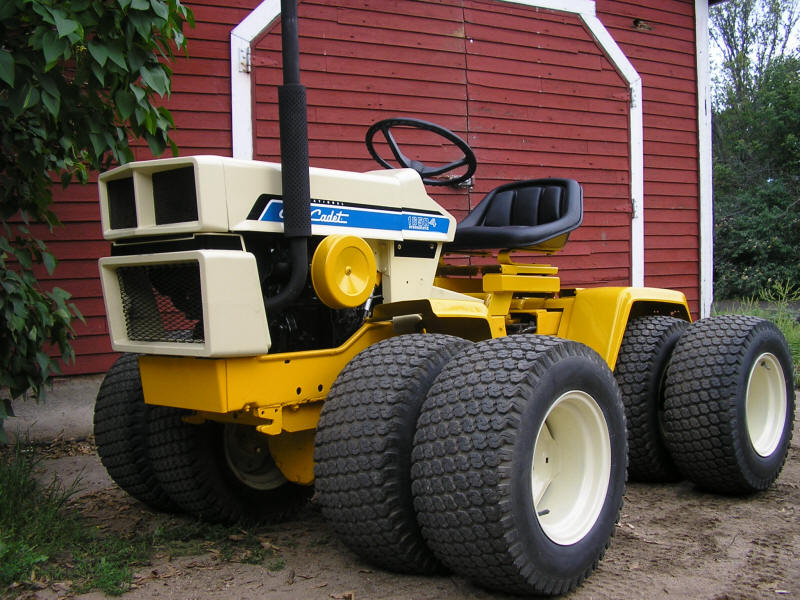

I have a 6x4 Gator TH. It is already relatively wide and stable, low COG, but I would like to widen its stance even more for a specific cross-slope towing situation that I have. There are folks making wheel spacers and also adapters for bolt-on dual wheels. Some say good things, others say it is asking for a bent transaxle or worse. Well, I have another "parts" Gator and I am fighting the impulse to pilfer the back wheels and weld up some dual wheel adapters for the rear (all four wheels). Despite the cautionary tales out there, I am thinking that it might be different having two sets of duals per side, since it would distribute the load better than a single set of duals. There might be other reasons not to do it... even saying "10-wheeled Gator" kinda makes me cringe... but I wonder if it might not achieve my purposes and not be that much worse than 3" wheel spacers. Thoughts on this? Specifically, I have yet to see any load stress calculations for these kind of mods, only anecdotal "it does great" or "that's crazy" or "try it and see". Is there a good way to determine, for starters, bending force of the axle or how much force does it take to damage a transaxle? If I could find the ratings for these parts then we could do potential load calculations and get a sense of how utterly stupid it might be. Thoughts on this?

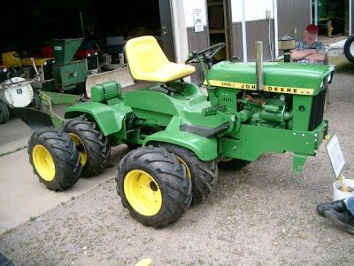

Some of the older tractors and adjustable rear wheels. I know my old farmall appears to have enough space to get well over 10 ft wide. I would think somethign like that might work and be easy on the budget but may have too much ground compaction for your needs.

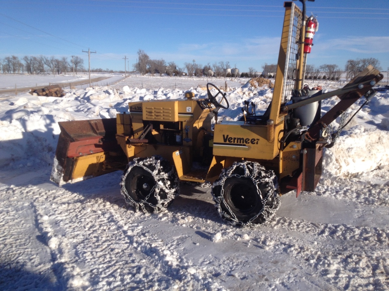

My little skidder would work perfect for this application. I foamed the tires and its' works really well on slopes as it has a low center of gravity much like the gator.

Without pics this is a bit hard for me to visualize. For example, what style tires do you have? If they are turf type I'm guessing you'll gain great stability, but the lbs per sq in will be so low that you'll struggle to stay on a steep side slope without spinning and sliding to the bottom??
I think the concern about bending axle assemblies would be if you were carrying large loads and the weight fell upon the dual tire, which will most definitely happen at times.
