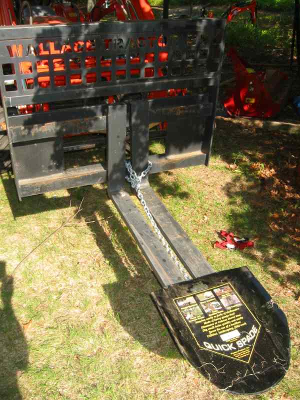

I have an idea for you. Consider rigging a grapple arm to join with a quick spade or set of forks. It would be narrow and have a four or five foot reach. Here is a photo of a quickspade on forks. You'd just need to rig the grapple part to the forks.

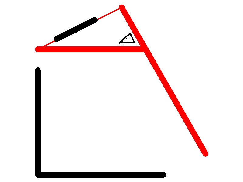

Here is the idea I am thinking about. The cylinder would push on the front claw and curl down as far as you design. When you open, the claw will open part way and contact the wedge and cause the back arm to raise.

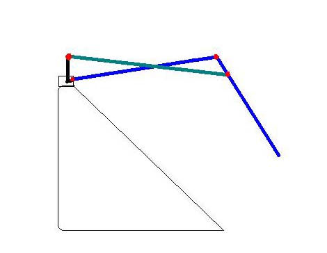

Here is a quick paint drawing that I made to show the basic idea of something I have been thinking of building to get a bigger bite on loose light material.
Your cardboard cutouts reminded me.
You would only use one cylinder and use a connecting link to actuate the tip of the grapple. The Red spots represent pivot points.
When it is open you can see where it would have a wider opening and as it is closed it would tend to pull in toward the bucket. The link would have to be as strong at the grapple itself because it is exposed to the material being picked up.
