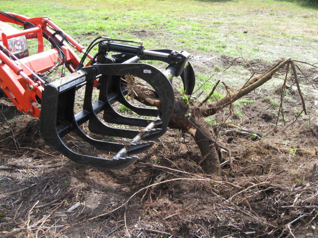

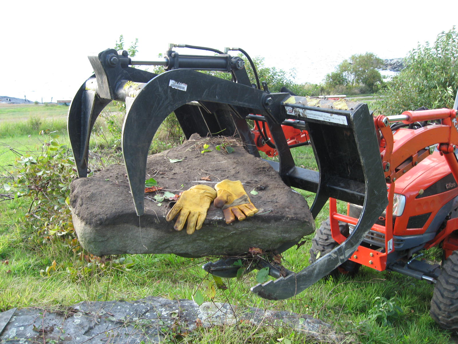

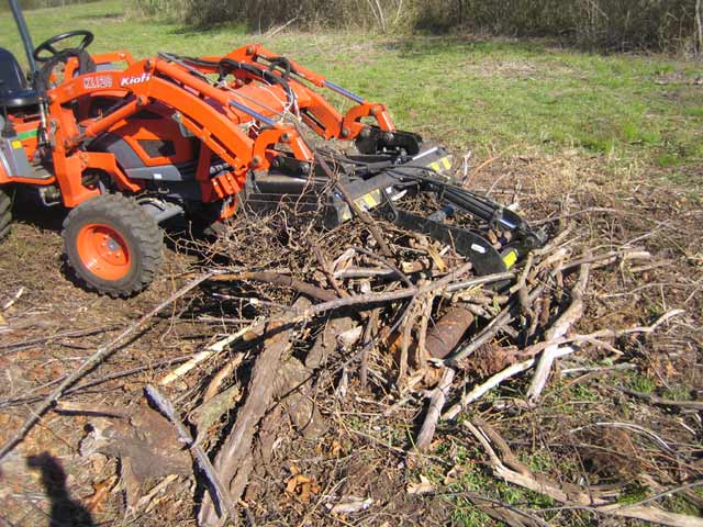

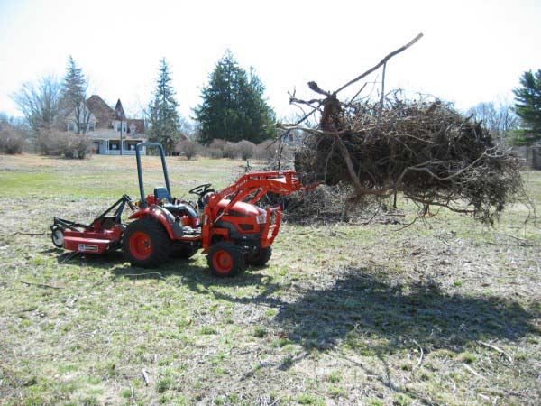

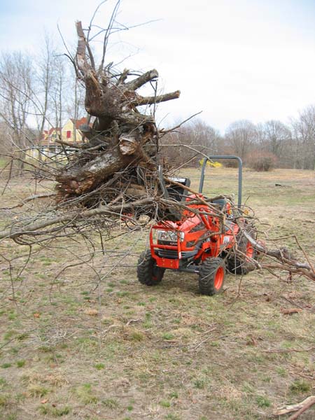

HR3, either you misunderstood my comment or I am not sure you understand how grapples work. I'm not trying to be confrontational I just feel from your statements that you have a false notion of what is involved. Take your example of picking up the rock. It does not involve "sqeezing the daylights" out of anything. One would simply place the grapple over the rock, close the grapple so it cupped the rock and then curl or lift. While the upper grapple arm can be used to crush brush etc it is mostly there simply to hold the load in place. If you are concerned about manuvering a large grapple in confined spaces then you and I share that concern. A narrow grapple, like JJ's, is much more versatile than a wide one. JJ's fabricated grapple would be excellent for getting such a rock as would almost any standard grapple. JJ can get that grapple anyplace he can drive his skidsteer. I can get my 48 inch grapple anywhere I can drive my tractor.

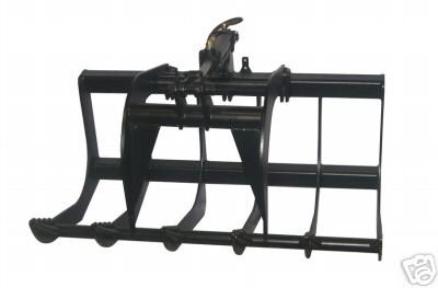

My point was simply that a basic "root" grapple, preferably about 48 inches wide with a single upper arm and weighing in at less than 400lbs about the most efficient type of grapple and best value in terms of bang for the buck. They can be purchased for around $900 delivered. JJ's homemade grapple would fit in this catagory as does my Millonzi and the Markham 48 light duty grapple. My first tractor was a 21hp Kioti CK20 (that is in my avatar) and when I added a QA adapter and a grapple I could still lift substantial loads. See photos below. You really don't need to try to invent a new "mousetrap" to get at rocks, stumps, brush, logs or just about anything else that you can touch with the grapple.

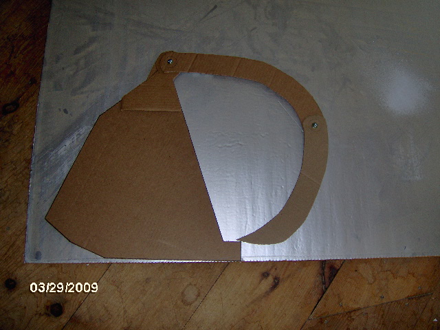

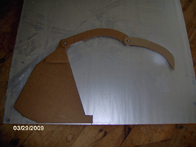

Island.. No I don't take it as confrontational at all.. everyones ideas are important,, I see from your pictures that you have nice wide open areas.. I on the other hand live in Maine and my property is very tight..and being a "Maineack" love to build new things that not everybody else has...just because I can... I do understand how a grapple works,,, I'm not trying to reinvent the wheel...just make it work better for me,,
I've finely worked out how it should go together..what do you think...?? just cardboard for now...:)

How do you intend to rig the hydraulics? Will they be two stage or is the first part of the grapple (the part attached to the bucket) stationary?
   / Dual action grapple
#44
Both half's pivot and there will be 2 pistons run off my front remote,, I plan on a rocker switch to choose between the two to be able to control each one or to float between the 2 in the center position,,,kinda like what someone here is doing with their thumb on a backhoe...

I'd just be concerned about the complexity and potential vulnerability of all those joints and the second ram hanging out in space. Grapples do twist to some extent when clamping on asymmetrical loads so take that into consideration. Good luck.

I think what we are saying is that you don't need the double action engineering to accomplish your basic mission. A standard grapple would do fine. I know you are concerned about operating in the woods, many of us do that with 48 inch grapples and have no trouble. Unless you are planning on building a 36 inch bucket to go with the dual action grapple you will still be basically limited by the width of your bucket anyway. Your design will get you about an extra six to twelve inches of reach at considerable complexity mechanically and leave you with what might be a relatively delicate piece of equipment compared to a grapple. On the other hand, I admire the resourcefulness and independence you are showing so maybe you will teach us all something new.:)
   / Dual action grapple #49
hr3,
Do you plan to pull the grapple into the bucket or just to the front lip? If you grab a log, and close the grapple, and it touches the lip before it closes on the log, the log will still be loose, whereby, if the tip of the grapple continues into the bucket, it will tighten up on the log, etc.
If you are going to build this, and I believe you can, then the geometry of the Cat-Claw grapple would work. In the open mode, you might need a stop point on the back leg for the grapple to raise correctly.

JJ yes the bottom claw will fit eather all the way into the bucket or could be curled under the bucket... when in the bucket there is only a 4" opening so i should be able to grab most anything..
Island.. yes I know you love your grapple...:D and that extra 6 to 12 inches might come in handy,, I'm thinking the whole thing will only be 2' wide so I might be able to reach between the trees...:)
