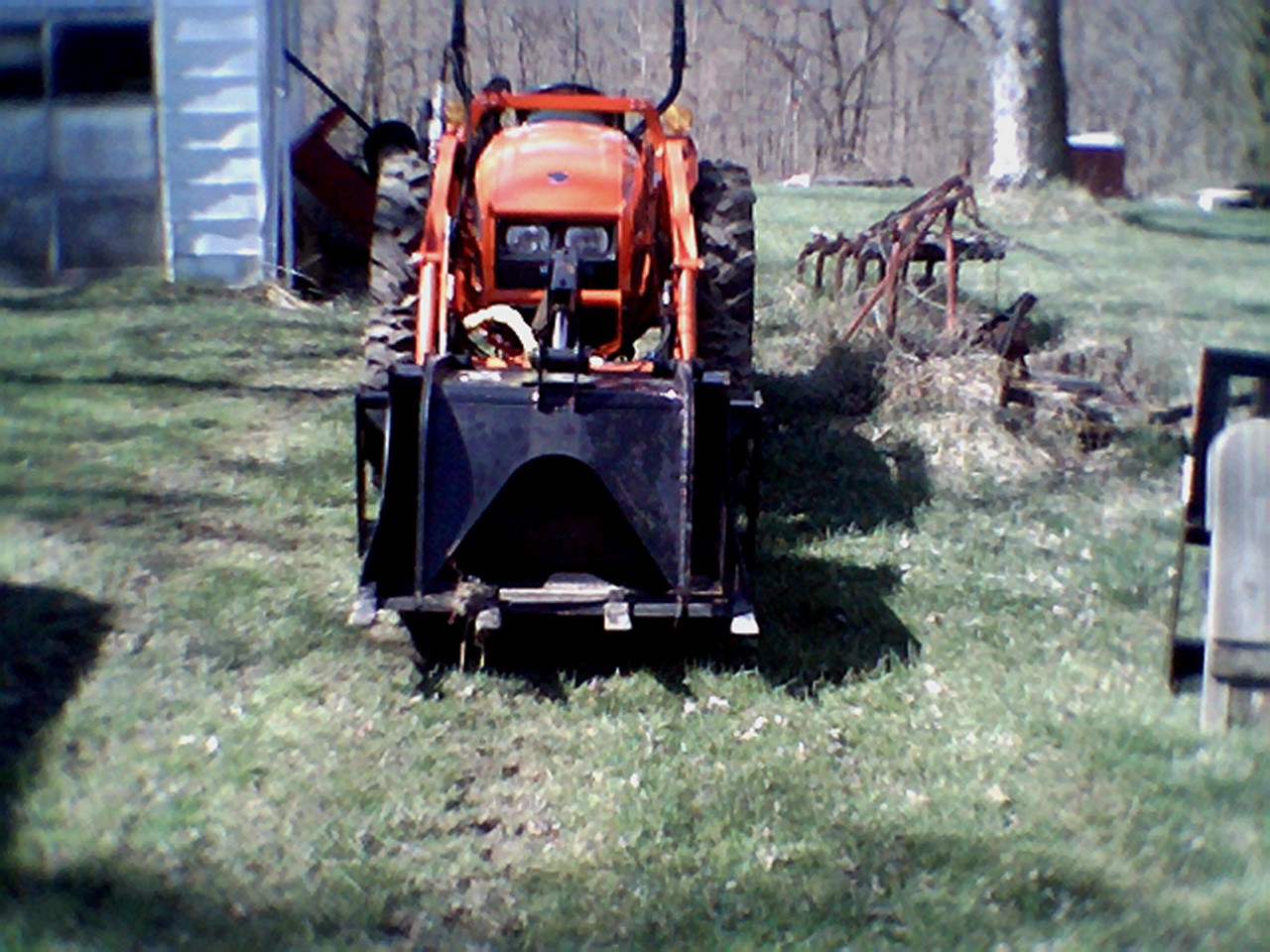

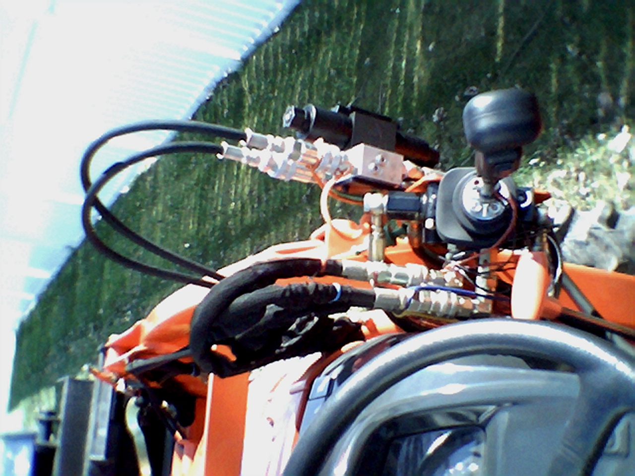

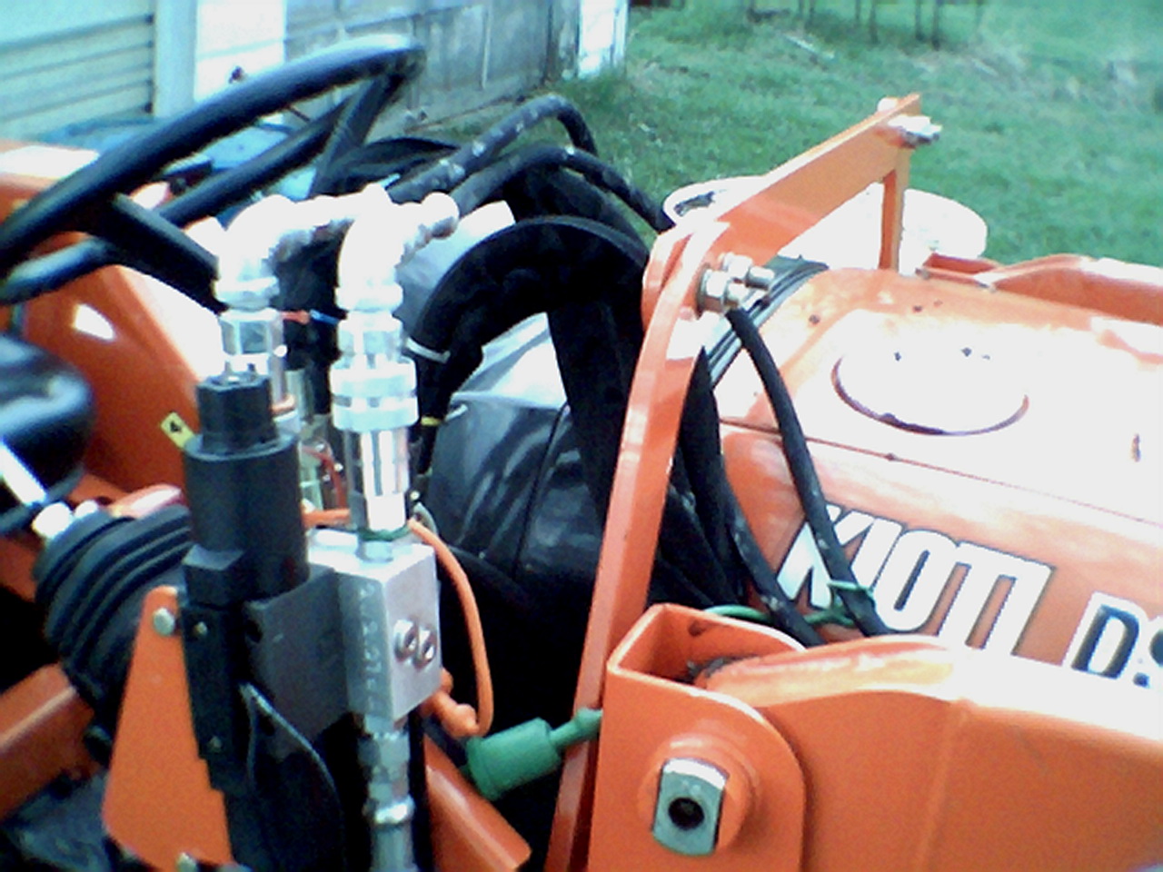

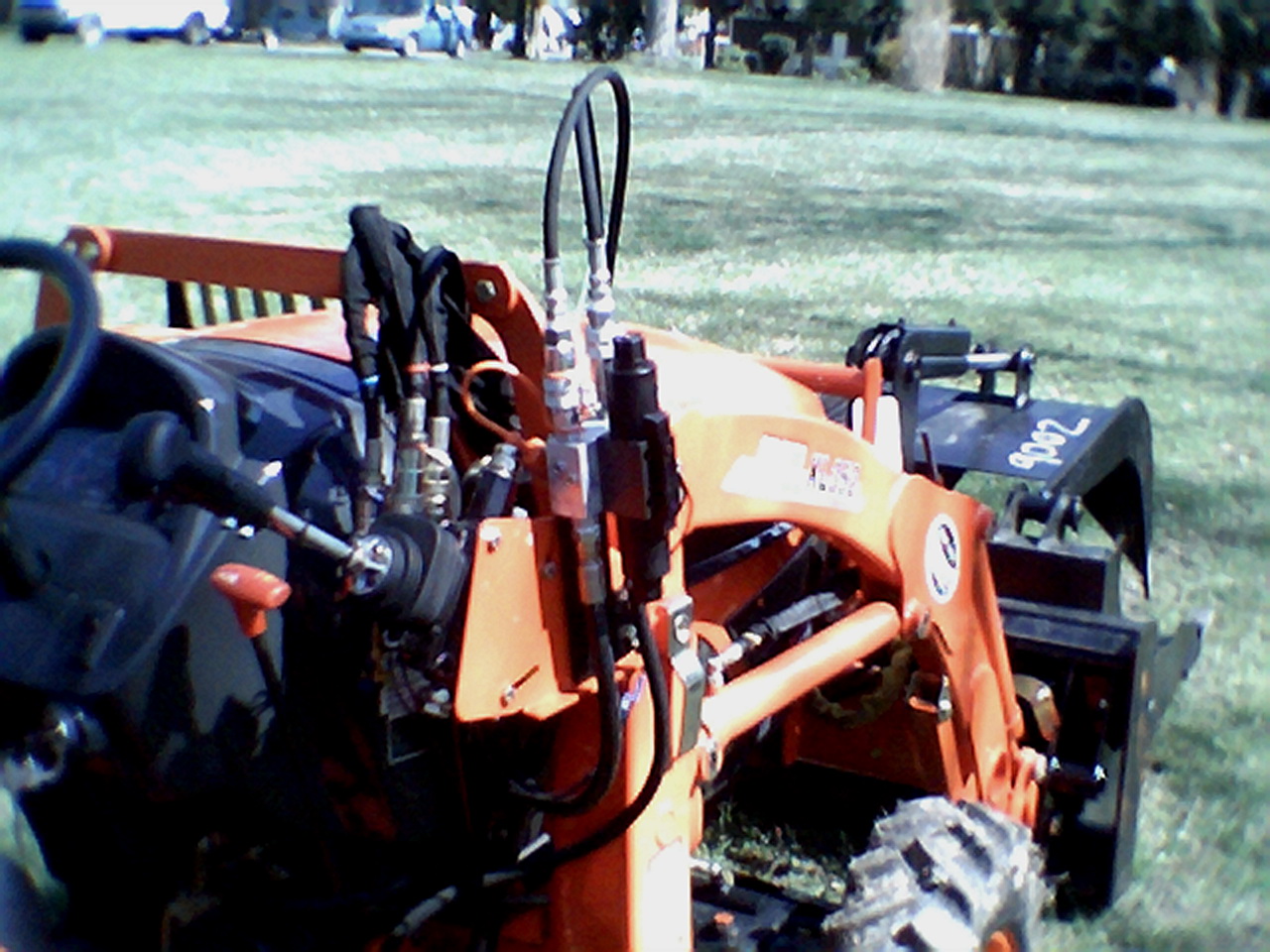

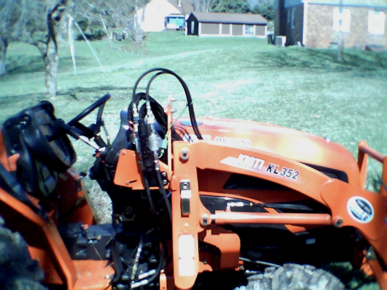

Here are some photos of the installation on my former DS3510. It is a WR Long 3rd function kit. The cast iron fittings were replaced with steel 2 weeks after installation. I had to order them from Surplus Center...
Hope this helps some.
Tom

That's what I was after. Why did you replace the cast iron fittings?
Thanks Geoff
/ DS3510 4 in 1 controls #17
Even tho I pressure tested them to 3000 PSI, I still felt more comfortable with steel hyd fittings. I had access to a hydraulic test stand. Nelson Long has it attaching to the bracket for the bucket controls and repositioning some lines before running the hoses out to the front. I bought them thru Everything attachments. When I wired it up, I attached the wires so the rocker switch would open the grapple when I pressed fwd and closed when I when aft. I really liked the handle and switch setup..
Tom
