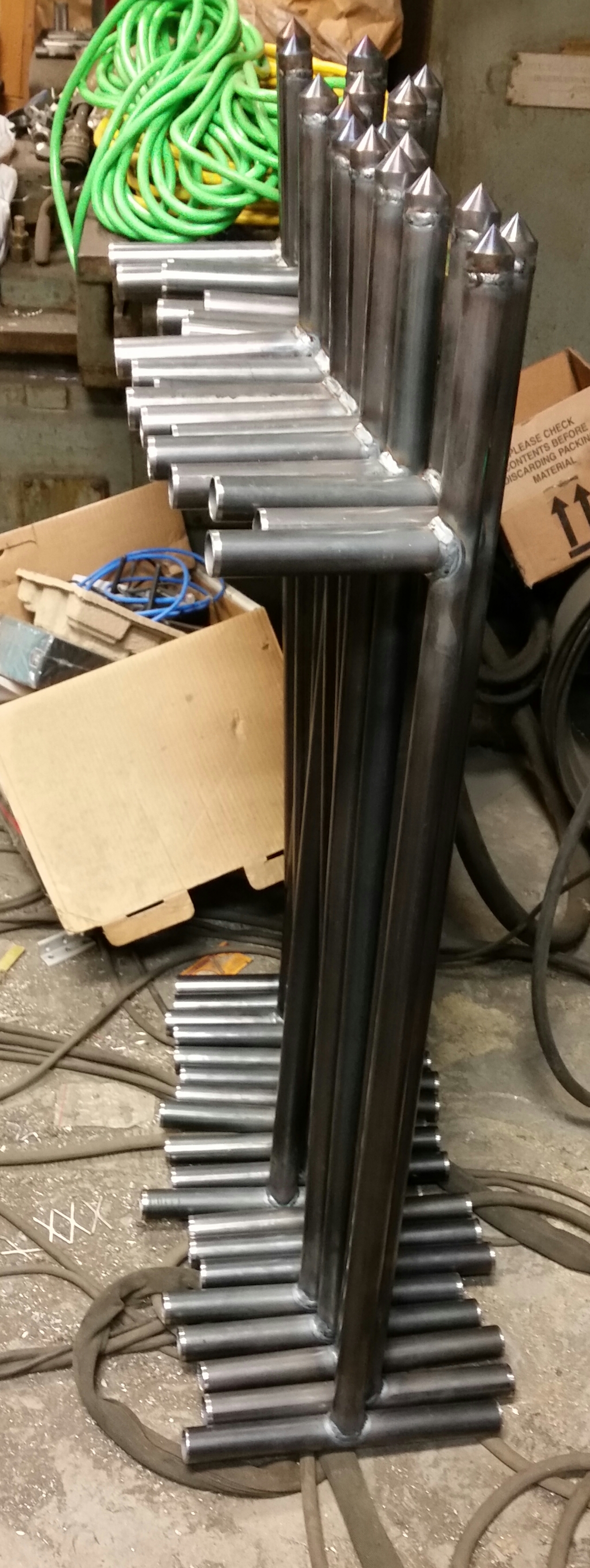

Dollar for dollar, my 4x6 bandsaw (happens to be a Jet - but they're all virtually identical) remains the king of quality for precision cutting and cost per cut on consumables. The only problem with it is how slow it is. If you're going to post-process the cut edge (say; mill it square), then an abrasive chop saw is fast and cheap. But if you're going to weld it directly off the saw, the bandsaw can be set up to make a near perfect end to go directly to the weldment. Grind off your tab burr and you're ready for fit-up.
My bandsaw blades (bi-metal, US made) seem to do well against things like 304 SS, chromed hydraulic shafts and hydraulic cylinder bodies, etc. Only downside is speed - which can be made up by the fact you're not trying to true it after the cut in some applications. Those tree plug planting tools I posted have a weldment on one end of 2 out of 3 pieces, and are fishmouthed in a mill before fitting on 2 mating surfaces. The ends of the handles are clean after deburring with a chamfer cutter and flap wheel, so the textured smooth face left by the dry cut is perfectly acceptable even if not precisely all that square to the axis of the tube.
