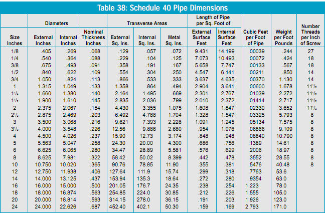

Jay 4200: Actually, the table I posted is for double walled HDPE...sorry if I confused you; I am confused about 4" thick Sch 40 PCV, which you reference.
The attached table shows Sch 40 dimensions and four inch PVC has about 1/4" wall thickness ...even for the bigger diameters, wall thickness gets just over 1/2" ...but, maybe I didn't understand.
My reference to "conservative" was that the info was for HEAVY CONSTRUCTION LOADS, and much less would be required for normal traffic, including tractors such as those normally referenced on this board.
Properly bedded, it is very difficult to deform a circular cross section ...and, of course, pneumatic tires spread the load so that even a heavy truck running, say, 100psi in its tires, only puts 100psi on the ground, as I recall.
Anyway, sorry if I misled anyone
