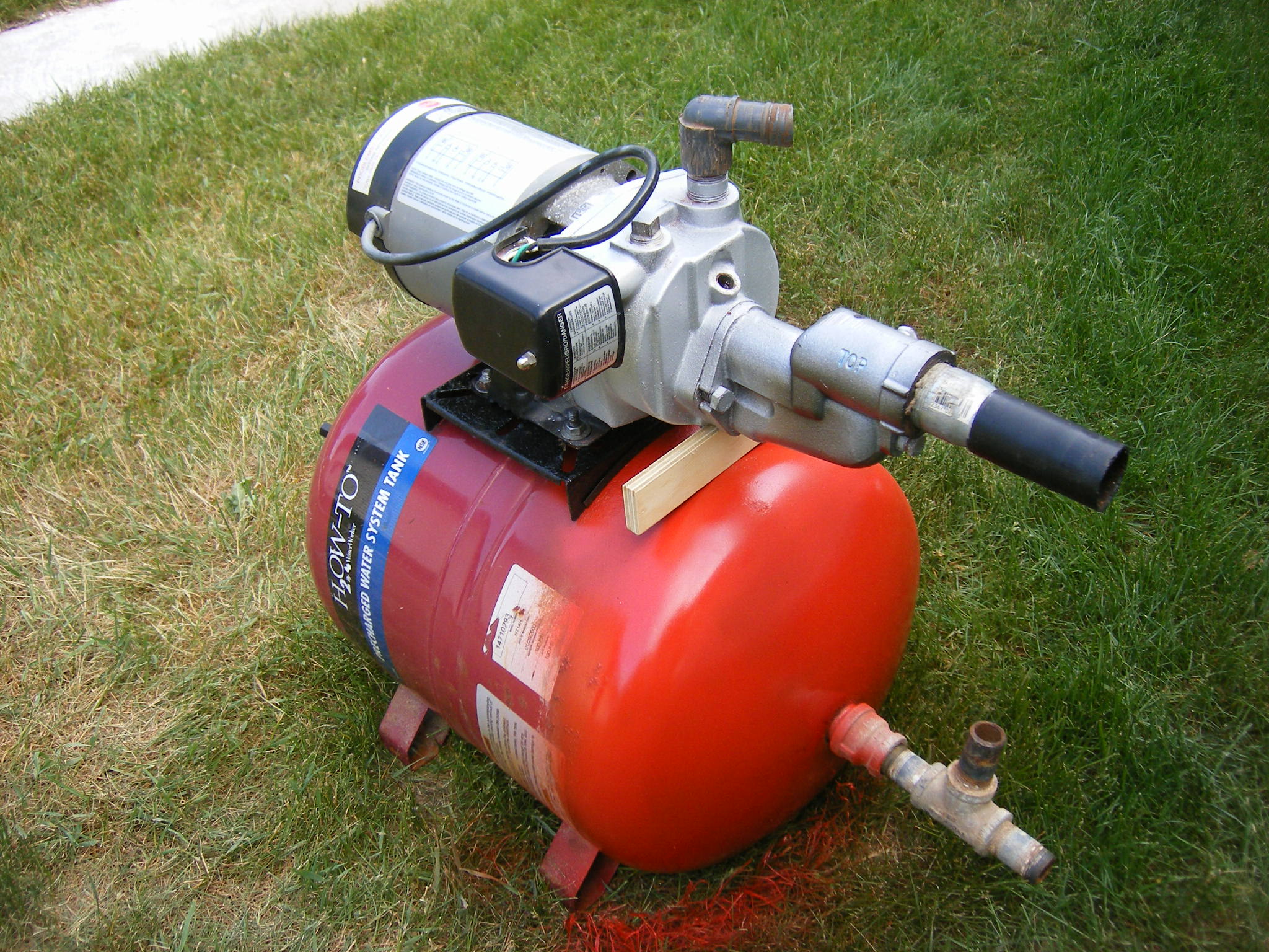

The well is down. The pump has been all cleaned up and all fittings removed and re-taped. I has a small list of things to fetch.
6' of 1 1/4" flexible plastic pipe
3' of 1" flexible "hose"
check valve
barbed fittings
Might go tomorrow and pick these up. Supposed to be 90F which is a killer. Might have to take a ride in the A/C to get stuff. :D:D
   / Driving A New Well #56
That was a great job on cleaning up that jet pump. :thumbsup:

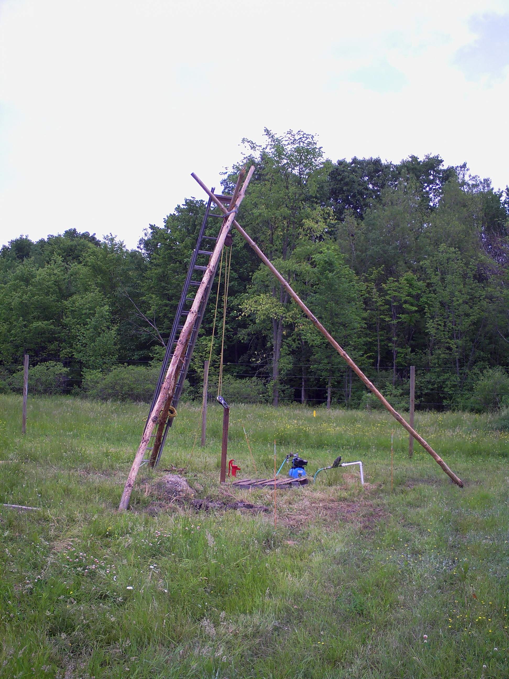

Spent a few hours raising and dropping iron to get about a foot into the shale layer under my orchard. Painfully slow, but not as bad as hauling water twice a day. I have no idea how thick the shale is, but I'll just pound pipe while I pump water every day.
Heat and humidity left me in a stink today, and the black flies did nothing good for my attitude.
The drive weight was made by my neighbor's father. It's a slug of solid axle shaft welded to a section of pipe. I had to set up a gun tackle to cut the weight in half so that I could manage it myself. Fortunately, the weight falls freely when I drop the line!
The same neighbor helped me set up the tripod of red pine poles that he had cut last winter. I have a great neighbor!
My goal is to have a working well by the end of the month, but I hope that God's green earth cooperates!
