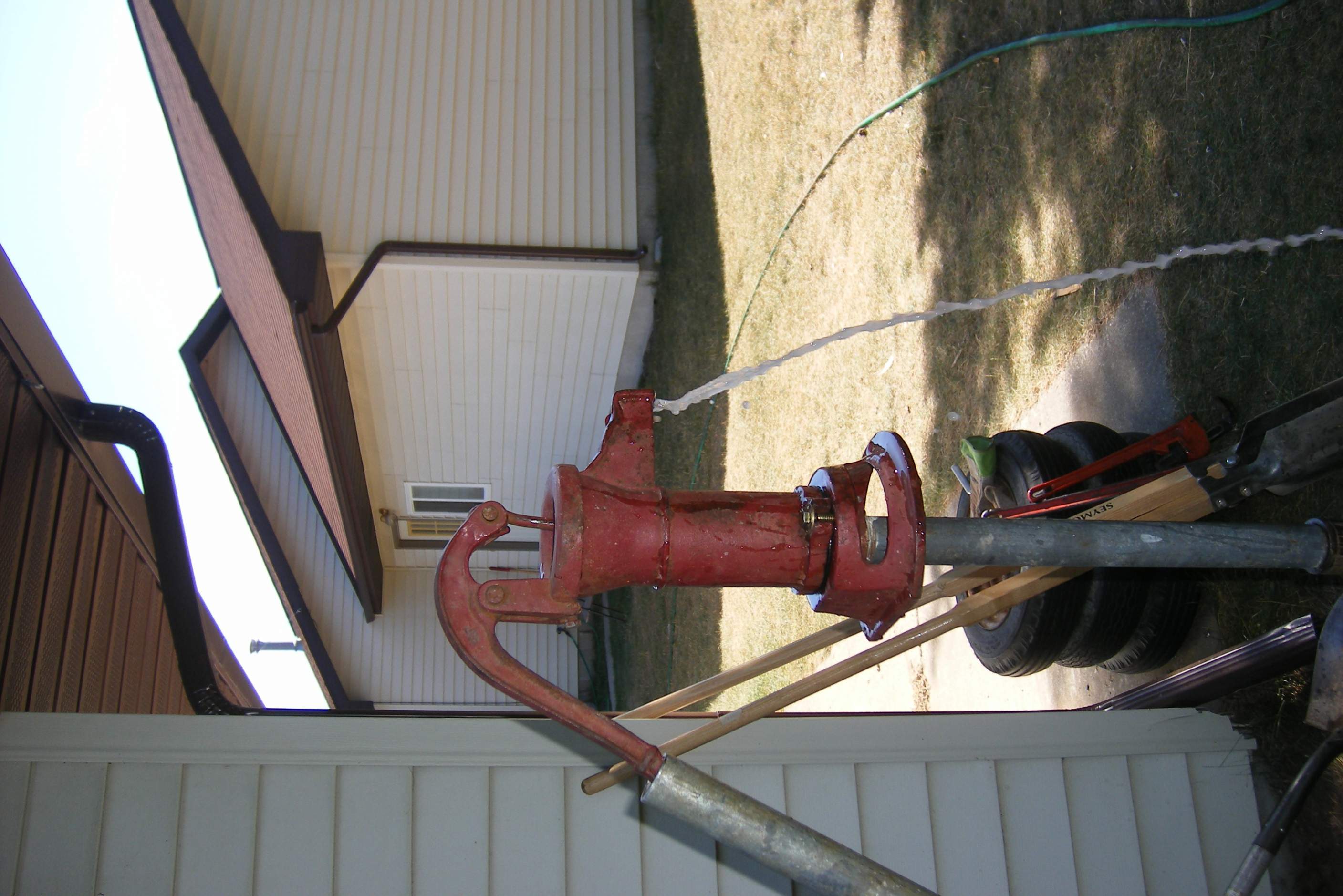

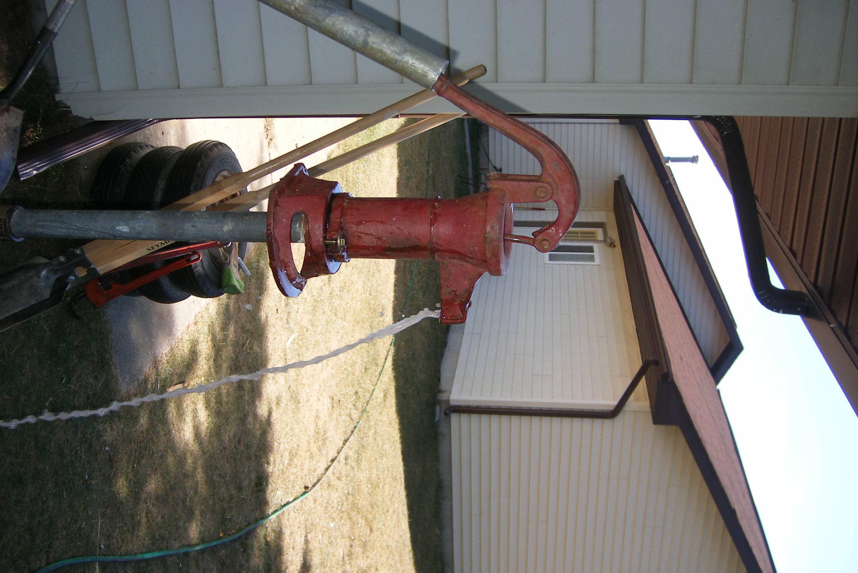

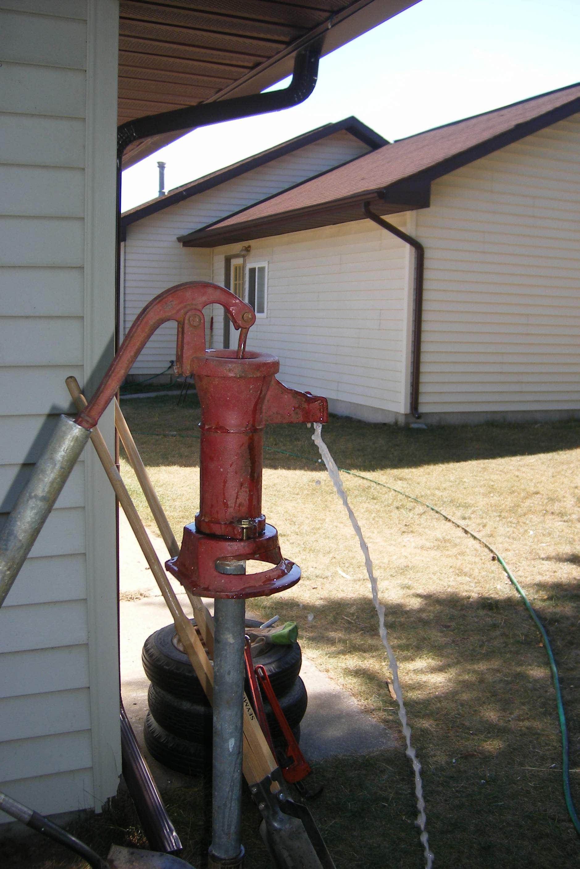

Update
Well, it is a year later, I finally got back to the well. Last year, we got down about 20 feet and the driving was difficult and the water was mediocre at best, in volume.
This year has been an awful drought and record breaking heat. True of most places in the center of the country. This has given me the impetus to get back to making this well work. Got another 5' section and decided to have at it. The longest living resident of our 80 acre parcel, an old fellow who is a joy and who really knows his stuff, said "go to 26 or 27 feet".
So, with a little more pounding, we drove the well point down to 24' and began pumping with the pitcher pump. It pumped very hard, but we were drawing a bit of water. Drove it down another foot and pumped some more. Sure enough, it began to pump easy and the muddy water began to pour out. Stuck a cheater pipe over the pump handle and now it is really gushing and the well is getting developed.
Plan is to drive it another foot or two and clear the well. I am very pleased. There was a definite layer of clay between 16 and 22 feet and the driving was very difficult. Not impossible, but hard. Once that layer was penetrated, the old guy thinks we should be entering a rough gravel layer with good and abundant water.
I'll get some photos up later today, if I can. Can't wait to start putting this well to work.

You guys are sooooo right. No spring chicken myself, of course, but ol' Pete was truly a confidence builder. Been on this land for a long time and just had the confidence I was lacking, I guess. I've driven a few wells downstate, so some or maybe a lot of what I had learned applied, of course. But, there's no substitute for "local knowledge".
Here ya go!!! Felt richer than Jed Clampett. :laughing:
   / Driving A New Well
#88
Let's see if I can get that photo upright.
Now to get the pump hooked up and run it for a few hours to clear things out.

Great Job. Glad you didn't give up and found water. I love those pitcher pumps. I have one that am contemplating driving a well for someday.
