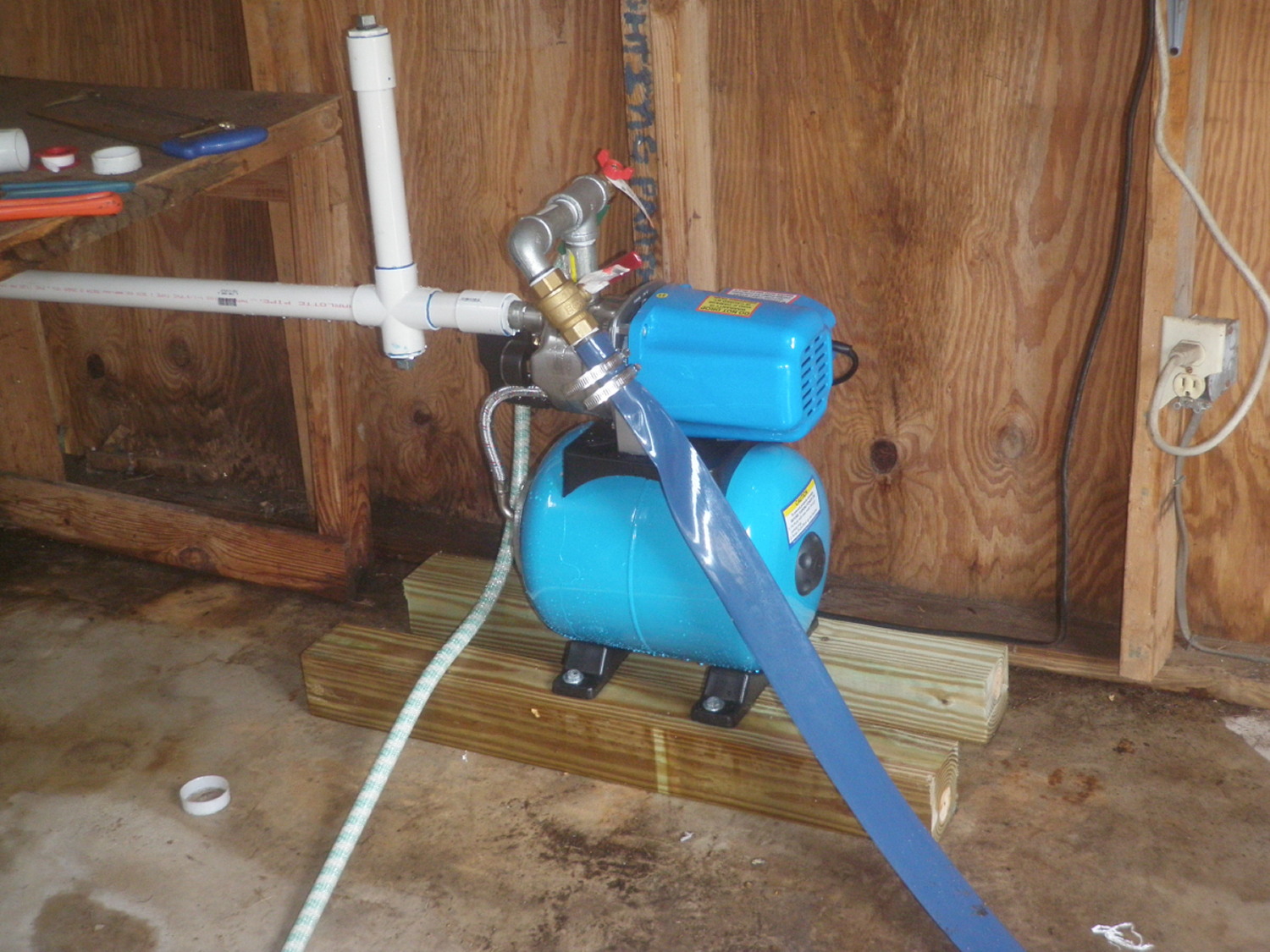

I've enjoyed this thread, had to do some research about these wells after coming back from Florida. All I've ever seen is a big rig grinding through rock day after day to get a well here in PA!
Helped some people set up their place in Florida that had a well to fill a swimming pool. The well was a piece of 2 inch PVC pipe coming out of the ground with a check valve installed. The old pump had been removed with a saw. This is a Harbor Freight pump (with 4 gal storage tank, all one unit) that cost about $90 and worked flawlessly. I connected it up, it took a gallon and a half of water to prime it, and away it went. Over three days, we ran it about 20 hours to fill a 10,000 gallon pull - works out to 500 gallons an hour. The "trick" was to set the pump outlet valve to keep some pressure on the pump at about 30 pounds. The big blue hose went to the pool, it was 1 1/4 inch diameter. The garden hose worked great for other clean up jobs - I did not use both hoses at the same time.
Now this thread has me thinking about installing one of these wells here to use for washing the car, etc.
I have the same pump in my orchard, and it has been a fantastic value! I put on beefier pressure switch and connected it to an external volume tank to keep the duty cycle down.
Excellent value from HF :)
