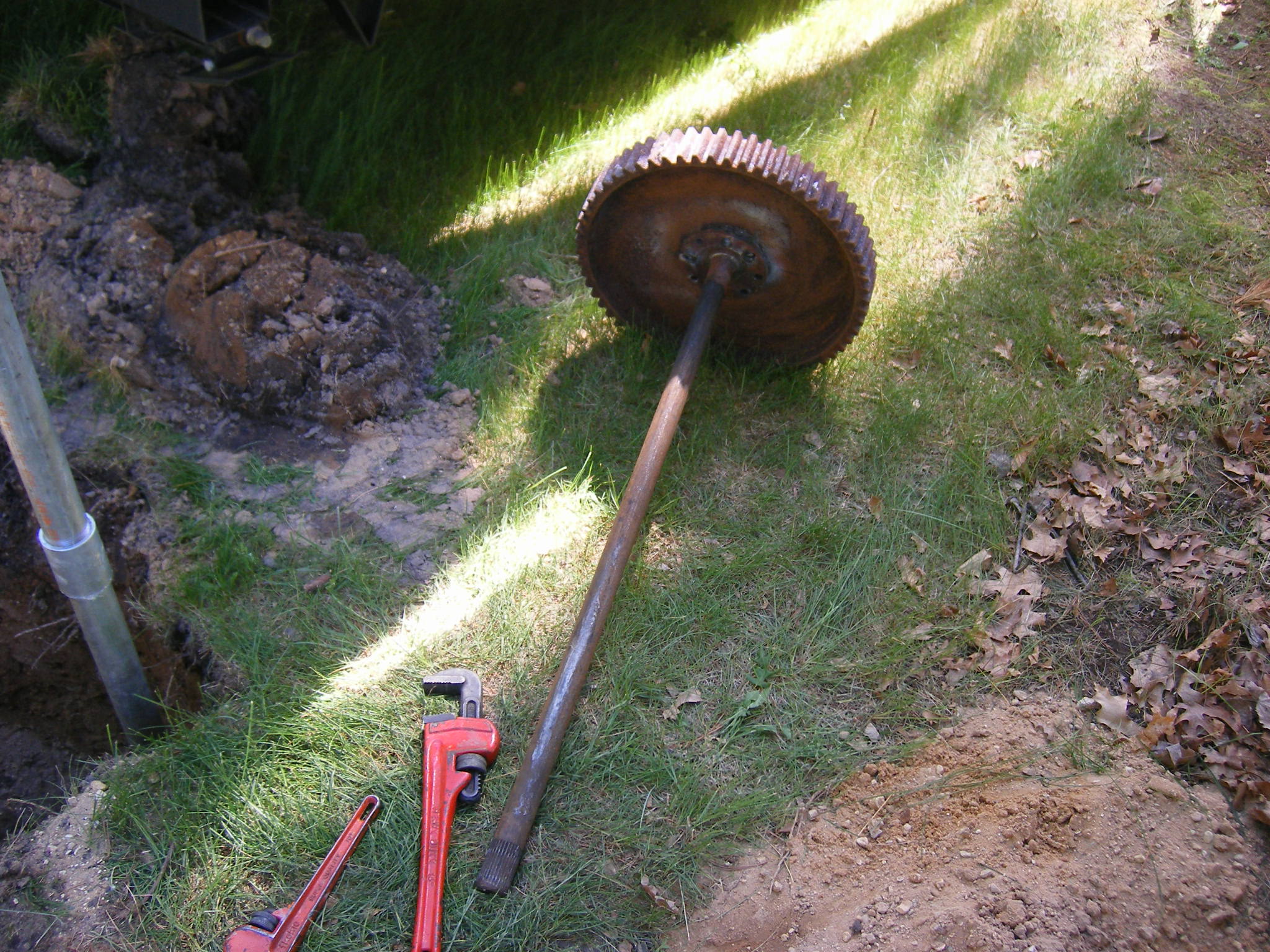

...I also wanted to mention that I find I have to keep the pipe wrench handy. The impact causes the couplings to loosen a bit. After 20 reps with the driver, I re-tighen the coupling as a pre-caution...
All the well guys I know use "pipe dope" or some type of paste sealant on the connections. They never use tape on the well casing. When properly "doped" and tightened, the sections do not come lose from the pounding like it does with tape.
Just a thought ...

After sinking my point in sand, I had a leak in the pipe and my pump would not prime. I ran a black plastic weater pipe down the inside of the steel pipe and hooked up to that. I like it because there is no rust after months of non use.
/ Driving A New Well #27
If you're screwing your connections together and driving your pipe in, it's gonna get loose. You can put a sealant on the threads but this won't prevent them from backing off and becoming loose. If time permits, I would mix up some JB Weld, or the likes, and use that as a lubricate/sealant. Or you can do the liquid teflon and weld a tack or two around the collars so they won't work free. Just a thought. Because hammering the pipe in the ground this way is a one trip. It doesn't matter what you do to it as you're not pulling it back out.

I use teflon dope, not tape, but either would be fine, I think. Yes, the pounding absolutely loosens the joints. Had to re-tighen after each rep of dozen whacks, or risk damaging threads.
Actually, using a engine puller or tripod with come along, I've pulled up almost 90 feet of pipe, in ages past. Don't recommend it, however.
