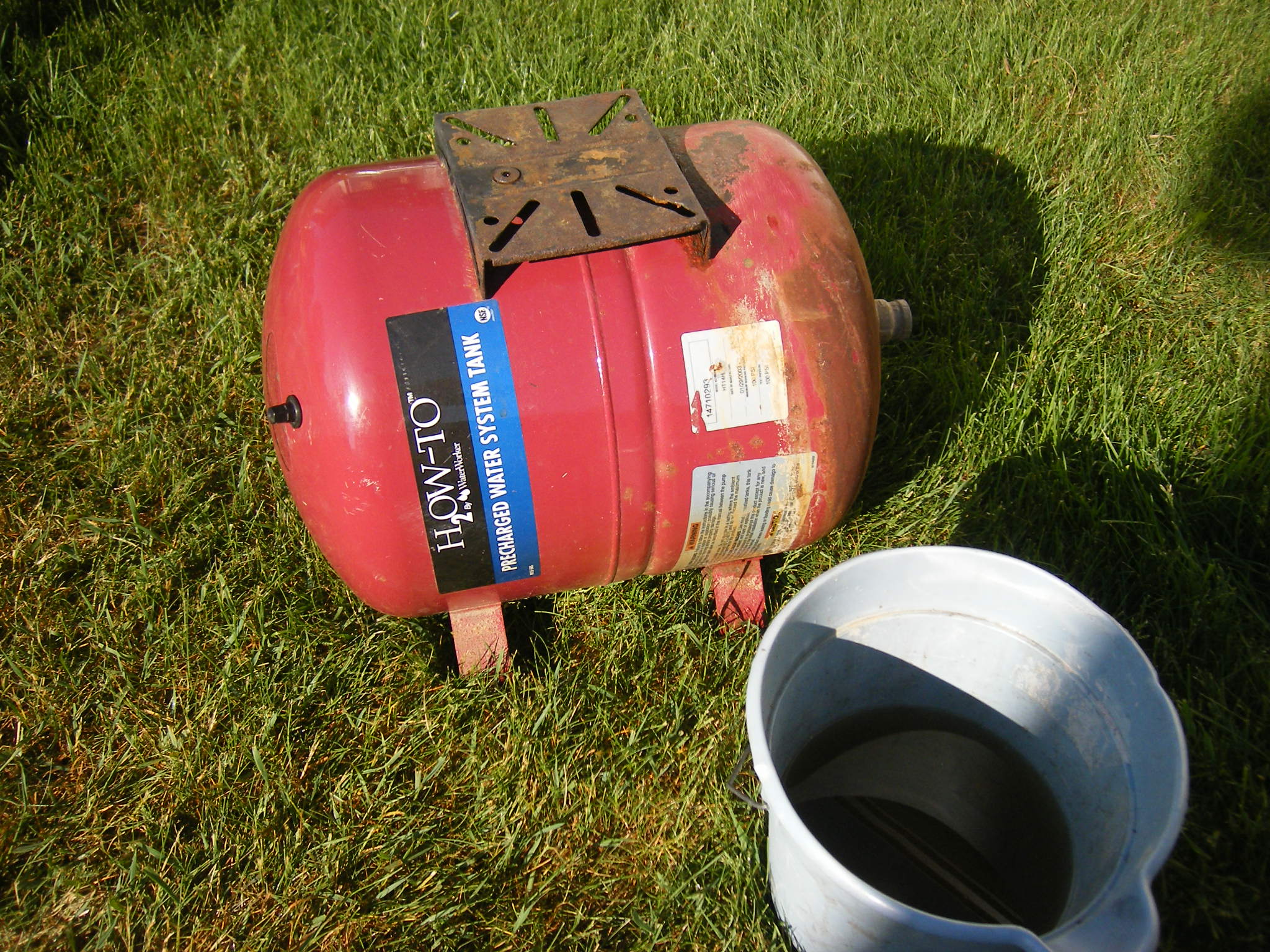

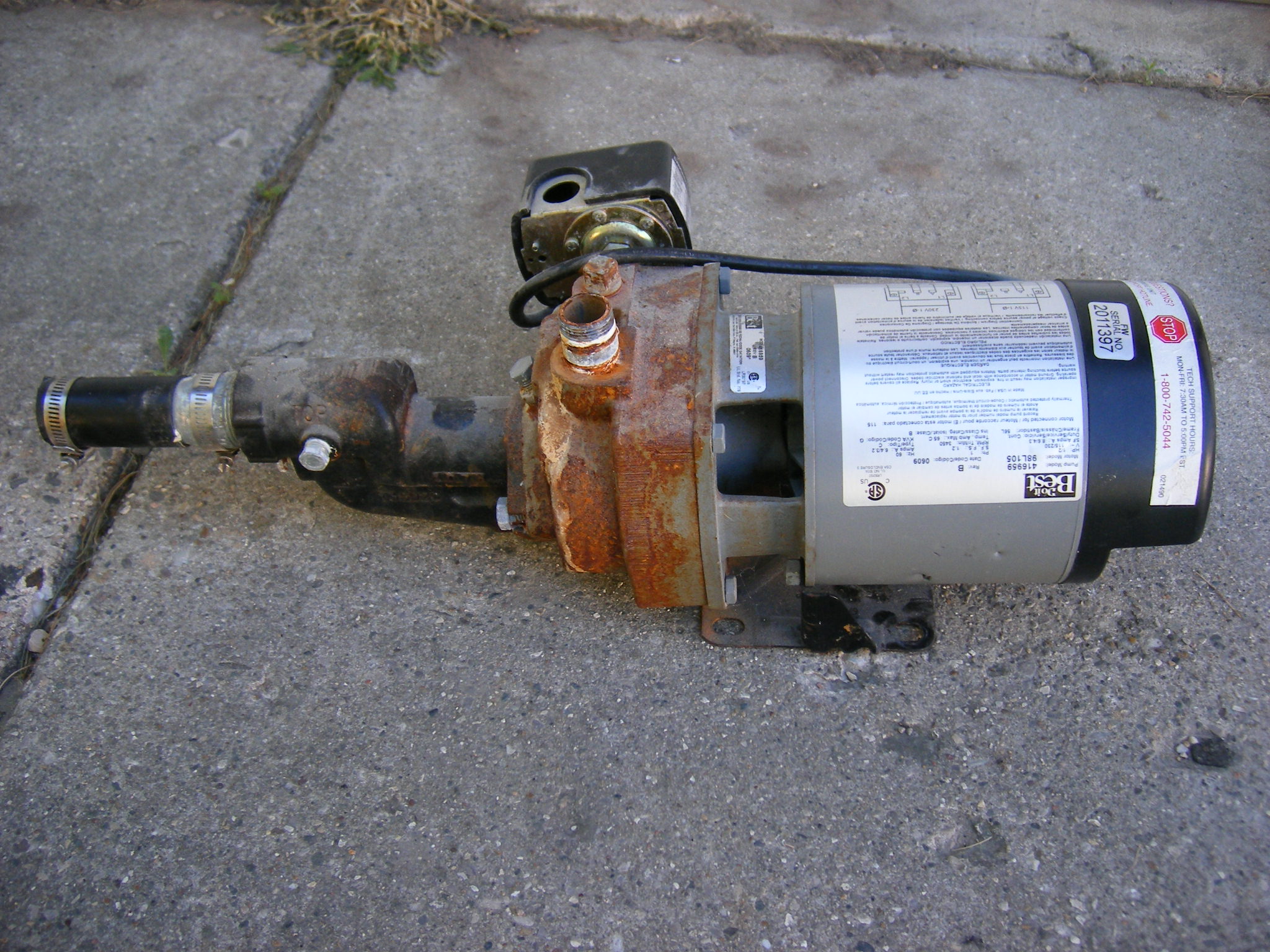

Purchased off Craigs last year for $90.
1/2 horse. Pump, tank and check valve all by Do It Best, a local hardware chain. I've disassembled all the elbows, fittings, nipples, hose clamps and what-not. Might do some cleaning. We'll think about some paint.
I'm guessing you need the check valve at the pump to maintain the prime? There's no foot valve on the well pipe, is there?

That looks a little better.
Sean
You could use a foot valve, or a vertical check valve. Brass or PVC.
/ Driving A New Well
#49
Sean
Chilly, J.J. is correct. You need a check valve, of some kind, to maintain the prime. Since a drive point doesn't have a foot valve, you have to put one in the intake line. The price on them varies greatly from PVC to brass. Turns out, I have to go get a new one as the old one is crud. If this was our domestic setup, I'd no doubt pop for the brass, but on an irrigation pump, I doubt I will. We shall see.

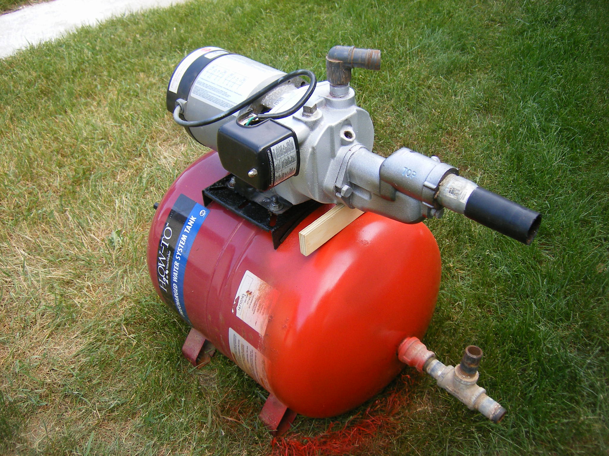

The well is down. The pump has been all cleaned up and all fittings removed and re-taped. I has a small list of things to fetch.
6' of 1 1/4" flexible plastic pipe
3' of 1" flexible "hose"
check valve
barbed fittings
Might go tomorrow and pick these up. Supposed to be 90F which is a killer. Might have to take a ride in the A/C to get stuff. :D:D

That was a great job on cleaning up that jet pump. :thumbsup:

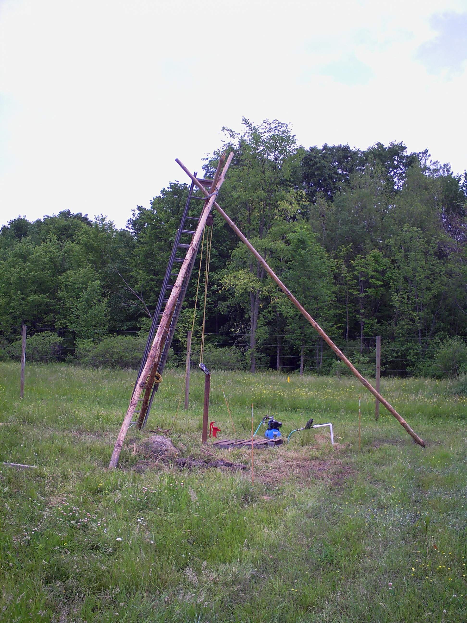

Spent a few hours raising and dropping iron to get about a foot into the shale layer under my orchard. Painfully slow, but not as bad as hauling water twice a day. I have no idea how thick the shale is, but I'll just pound pipe while I pump water every day.
Heat and humidity left me in a stink today, and the black flies did nothing good for my attitude.
The drive weight was made by my neighbor's father. It's a slug of solid axle shaft welded to a section of pipe. I had to set up a gun tackle to cut the weight in half so that I could manage it myself. Fortunately, the weight falls freely when I drop the line!
The same neighbor helped me set up the tripod of red pine poles that he had cut last winter. I have a great neighbor!
My goal is to have a working well by the end of the month, but I hope that God's green earth cooperates!
