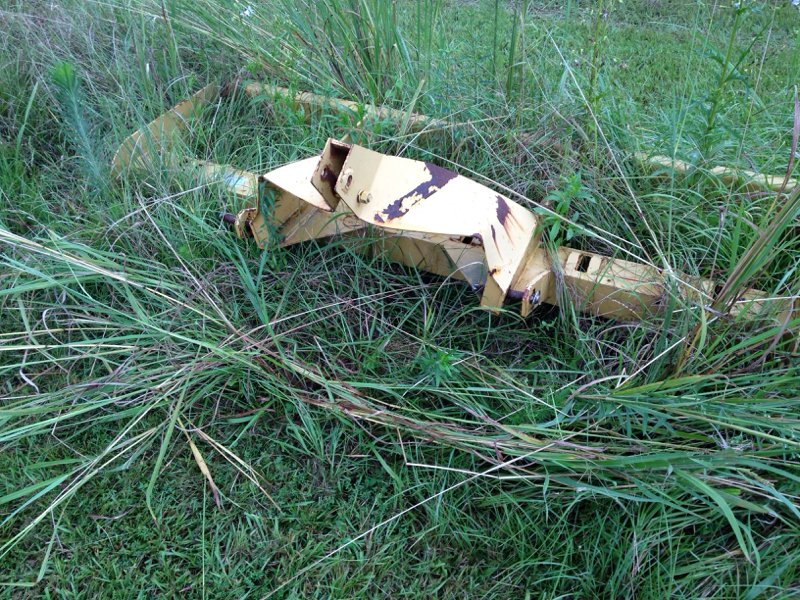

Here are some pictures of a small box blade I folded up because I used it with too large of tractor. You can use them but they give up long before you notice they've been screaming for mercy. I was back into a brush pile to quickly bunch it and found a stump. The tractor didn't slow down but the blade just started folding. The metal bending noise alerted me to the "problem" so now it's waiting for me to get some torch/welding time to fix.

Here's an honest question. I've read in multiple places that you should buy a heavier implement (blade, leveler, etc.) based upon your tractor size. It will work better. That intuitively doesn't make sense to me. Why would putting a lighter tool behind a heavier tractor work less well than the same implement behind a lighter tractor? Or is it just a factor that heavier tools will always work better regardless of the tractor and stand up to the abuse the heavier tractor can kick out?
The light implement won't WORK less well behind a heavy tractor than a light one, but it is much easier to OVERWORK (damage) it with the heavy tractor, therefore it is not as good. And you won't be able to accomplish as much as with a heavier implement.
As an extreme thought experiment, compare a tractor with a rear blade to the same tractor with a garden hoe hitched behind. The garden hoe won't move less dirt than pulling it by hand, but it won't last very long, either. It is no longer a good "implement." :)
