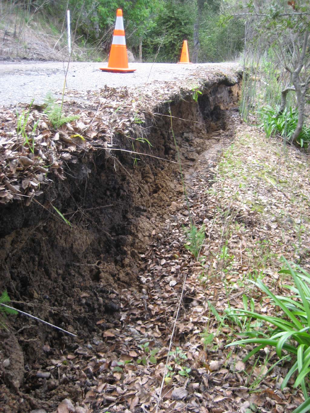

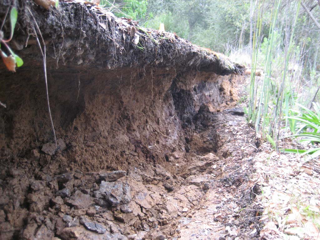

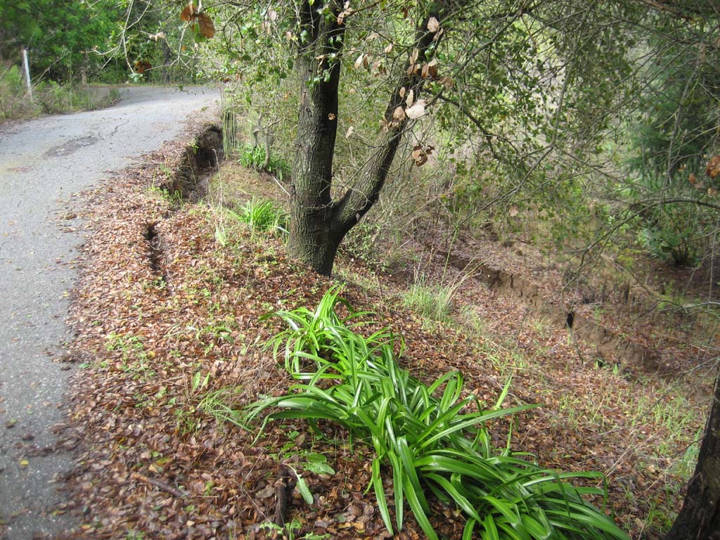

Update:
Measured the void below the driveway edge and it's larger than I originally estimated. About 35 feet long, cuts in about 24 inches, and is 24-32 inches high.
I'm attaching some pictures of the problem area.
A friend locally that does tree and equipment work for me reckons that it might be cheapest to put up some forms and get a concrete truck and a pump in there so we could direct the concrete into the spaces with minimum effort.

Have you considered some sort of stabilizing elements --maybe metal rods?-- pounded down into the ground prior to adding fill or concrete?
That's a pretty steep slope there; I'd be worried that anything placed under the road might be tempted to just roll out and down the hill with a little encouragement....
I notice that tree there seems to be doing a pretty good job of holding things in place on that end of the problem area.
/ driveway edge repair #9
I agree with teg, and looks like stabilizing that slope below the drive is needed first.
Has the appearance that water came across the drive and washe/eroded the hillside away. Is that a possibility?
/ driveway edge repair #10
As per the last two comments; before doing anything figure out what must be done to rebuild the side slope, stabilize it, Get drainage under control and resurface the road.
Hate to say it but it may be a little bigger/costlier project than initially thought if it gets a proper fix.
Forget the concrete and remedial action as that money spent will be lost. The pavement in that area will also be lost when rebuilding starts. :)
/ driveway edge repair #11
From the pictures it looks to me like things got saturated and the whole slope slid down the hill as one piece. I think you have some drainage issues that need to be addressed as part of your fix. If you just fill it in with lean concrete I'm afraid the water will build up behind it next spring and push the whole works down the hill again. I would consider improving or creating a ditch on the uphill side of the drive with a culvert to drain it under the pavement to the downhill side. Then fill the void you have with some well compacted gravel that can allow the moisture to drain without building up behind it. Probably more work than you would prefer, but it looks like water is your enemy and quick fixes rarely cure that sort of problem. Hope that helps.

That doesn't look good to me. I believe I would get an engineer in to consult. Setting forms and pumping concrete would be good but without a stable base it could move again. Might be harder to fix properly the second time.

Here's some more background:
The soil downhill about 100 yards from the driveway gave out and slid onto the county road below. With that support gone, the hillside slide down with it, lowering the level just below my driveway about 3 feet.
There isn't any evidence of water percolating through the the ground immediately below the driveway and the soil in the sunken area isn't that saturated either. There is a lot more water 50 yards or so downslope.
My immediate plan is to widen the driveway on the uphill side away from the slide so that traffic can be kept away from the damaged part until I can get someone experienced to look at it and design a solution.
I appreciate the input. You guys have confirmed what I thought when I took a better look at the situation yesterday which is that it is not going to be a quick fix.

I think what you will end up with is some kind of retaining wall with a good anchor that doesn't rely as much on the hillside below. Around here they would drive I-Beams in vertically, then fill between them with timbers then backfill.
This could be done from the road with the right equipment, probably without even driving on the unsupported road.
The big challenge is going to be locking it into the hillside. Once you have that, supporting the road again will be easy.
