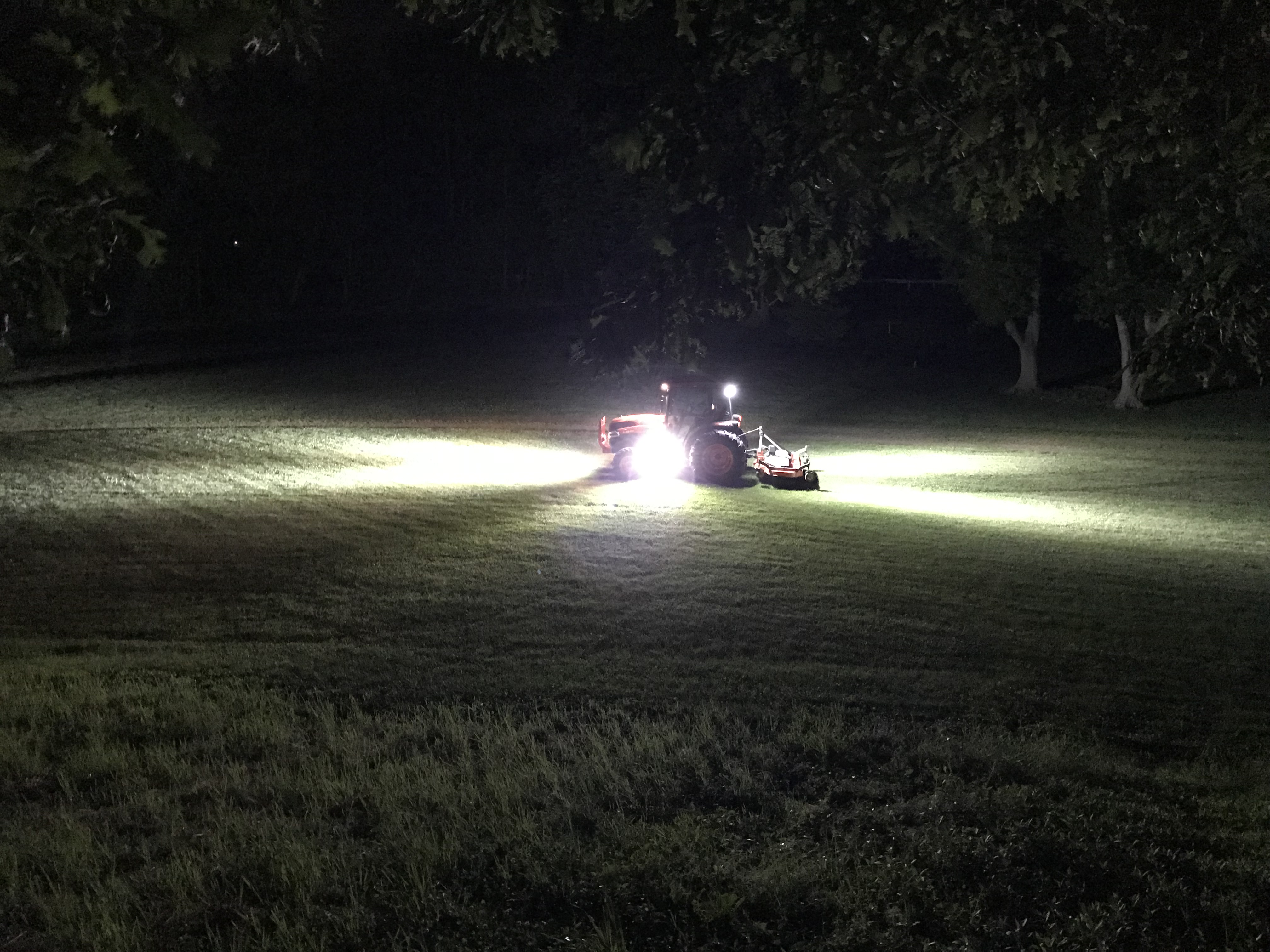

It seems to me that all LED lights are obnoxious unless you are looking at them from inside the vehicle. My work lights are uncomfortable to view from any angle while looking toward the tractor. That includes standing far away in an area that they don't even illuminate.
I travel about a mile and a half each way to clear snow at our church. The LED work lights aren't turned on when I'm on the road. The puny factory headlights, four way flashers and LED flashers mounted on the side surfaces of the roof are used. I do have trucker's (conspicuity) tape on different things. Even found some orange reflective tape for here and there.
The L4240 has 4 front, 2 side and 2 rear LED work lights for night work. The picture below doesn't do it justice. I'm guessing the camera sensed there was plenty of light and limited the exposure. The last time I mowed at night, I turned the two work lights on the front of the roof off because the brightly illuminated hood was annoying. While plowing driveways and parking lots last winter I didn't notice it. While watching the cut/uncut area the hood was in the field of view.
