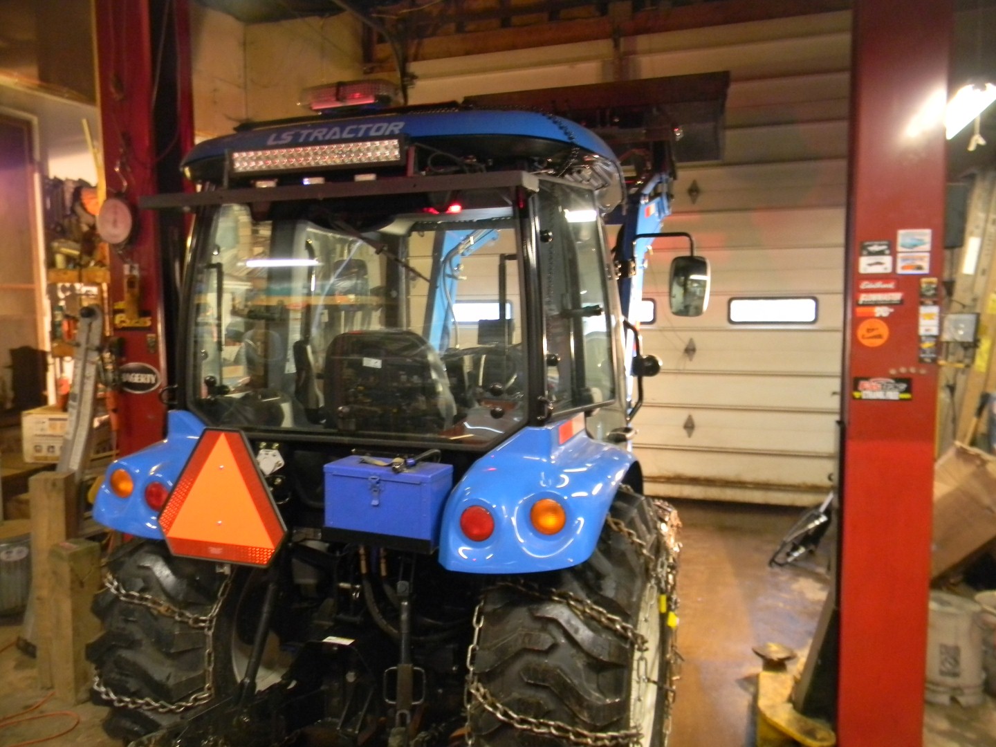

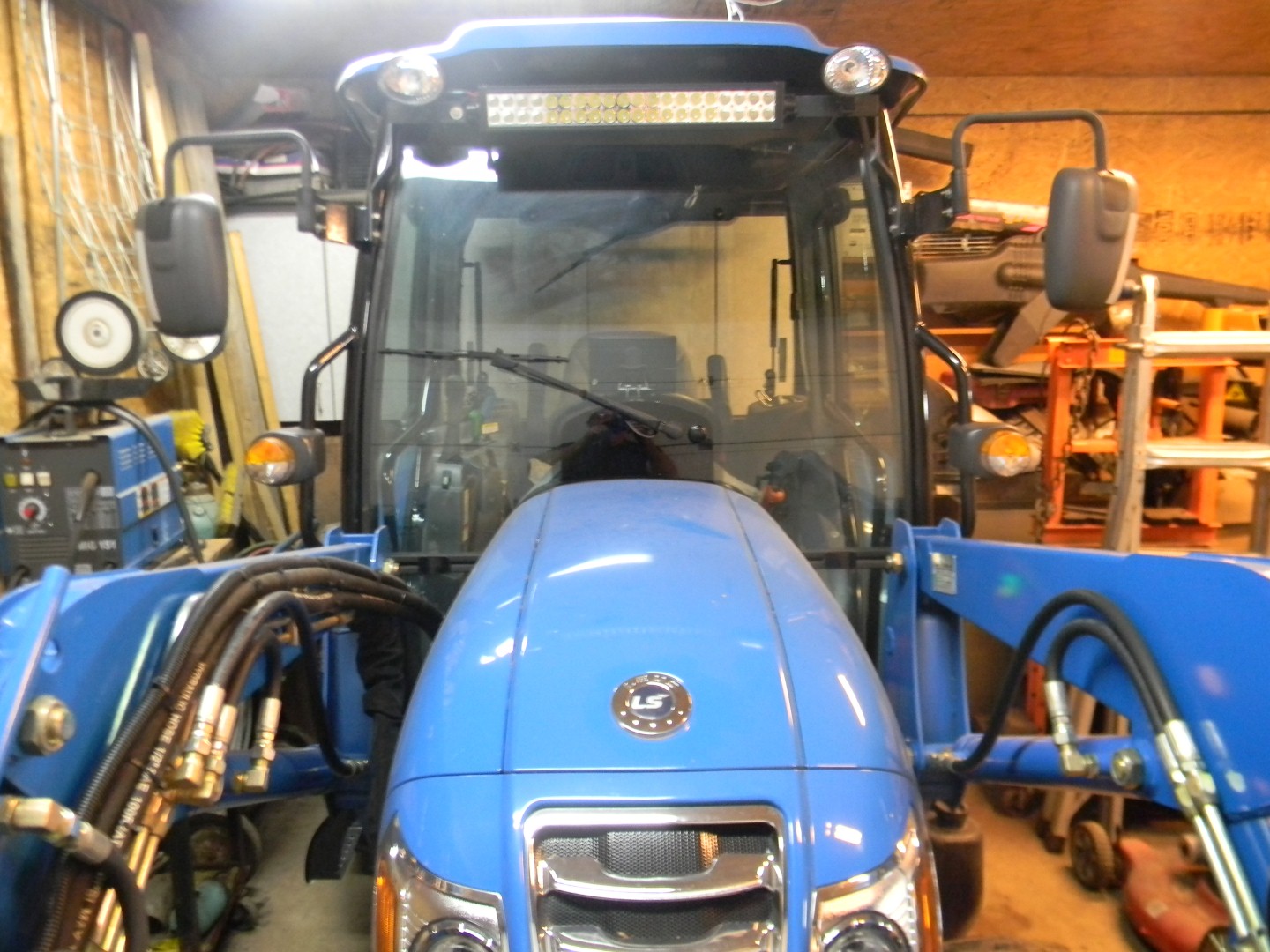

I installed the combo spot/flood LED lights on mine about 5 years ago. Not the curved bar. mine are straight (either 22 or 24" I think). I made brackets to mount them front and rear. They are much brighter than stock lights. They are blinding if you are in front of them. And No, mine don't offer a low/high position.
