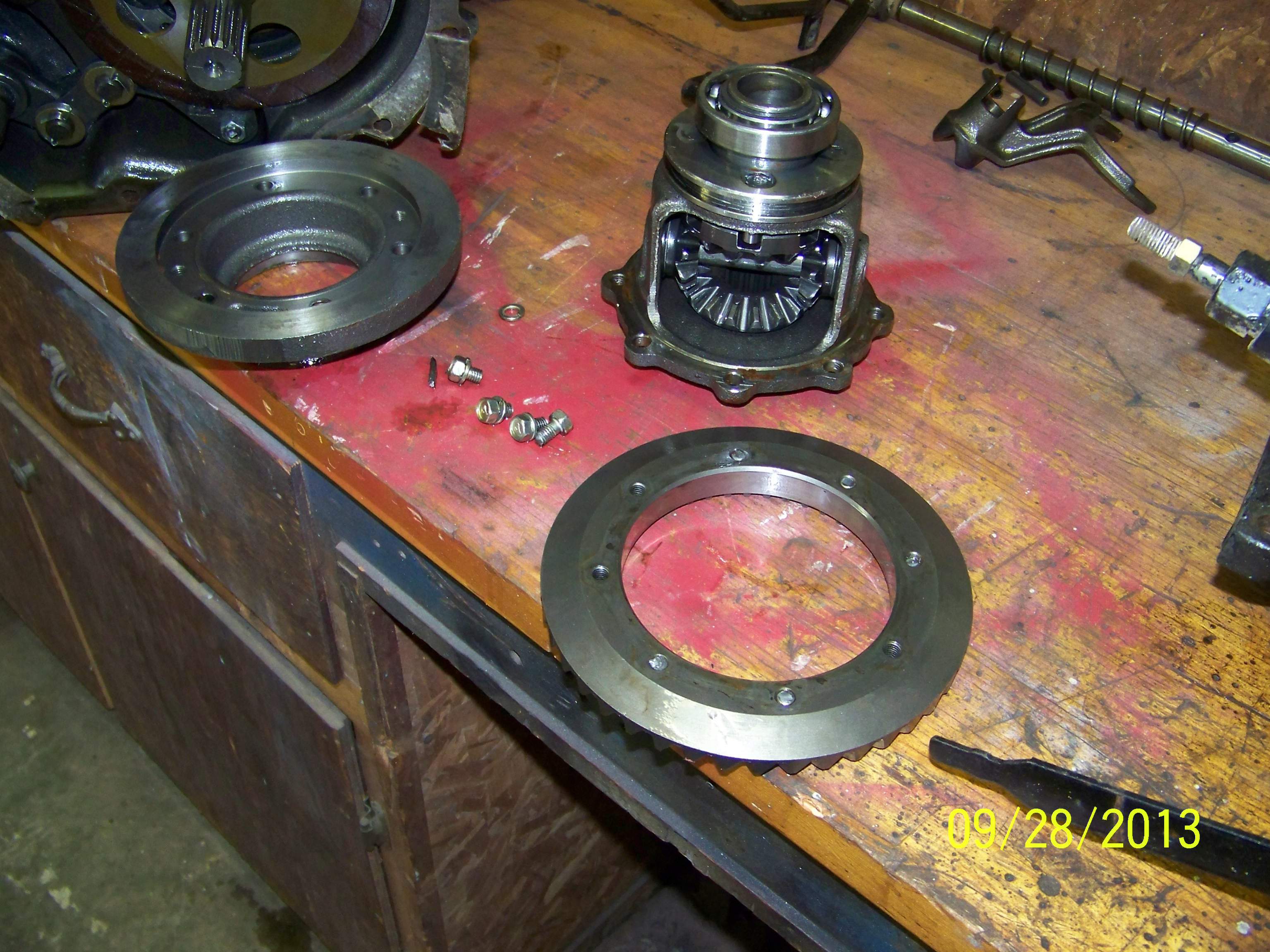

Thank you "all" for the kind comments. I am just going to go with what tractor Ernie has stated in former posts about these models being weak in that area and possibly not using an overrun clutch and shocking things. I have only changed the ring gear. I checked tooth contact with Prussion blue and set the backlash. I did this with GWSMITH's approval. The pinion looks untouched. The original ring and pinion are slicker than a mink. The aftermarket gears both have very noticeable machine marks left. Not claiming to be an expert by any means but I feel pretty comfortable leaving the original pinion because of the contact I am getting. It does come with a Sears & Robuck guarantee. :D Trying to be funny but anytime I do something like this my stomach sort of knots up until things prove out. Hoping to get it all back together and going this next week.

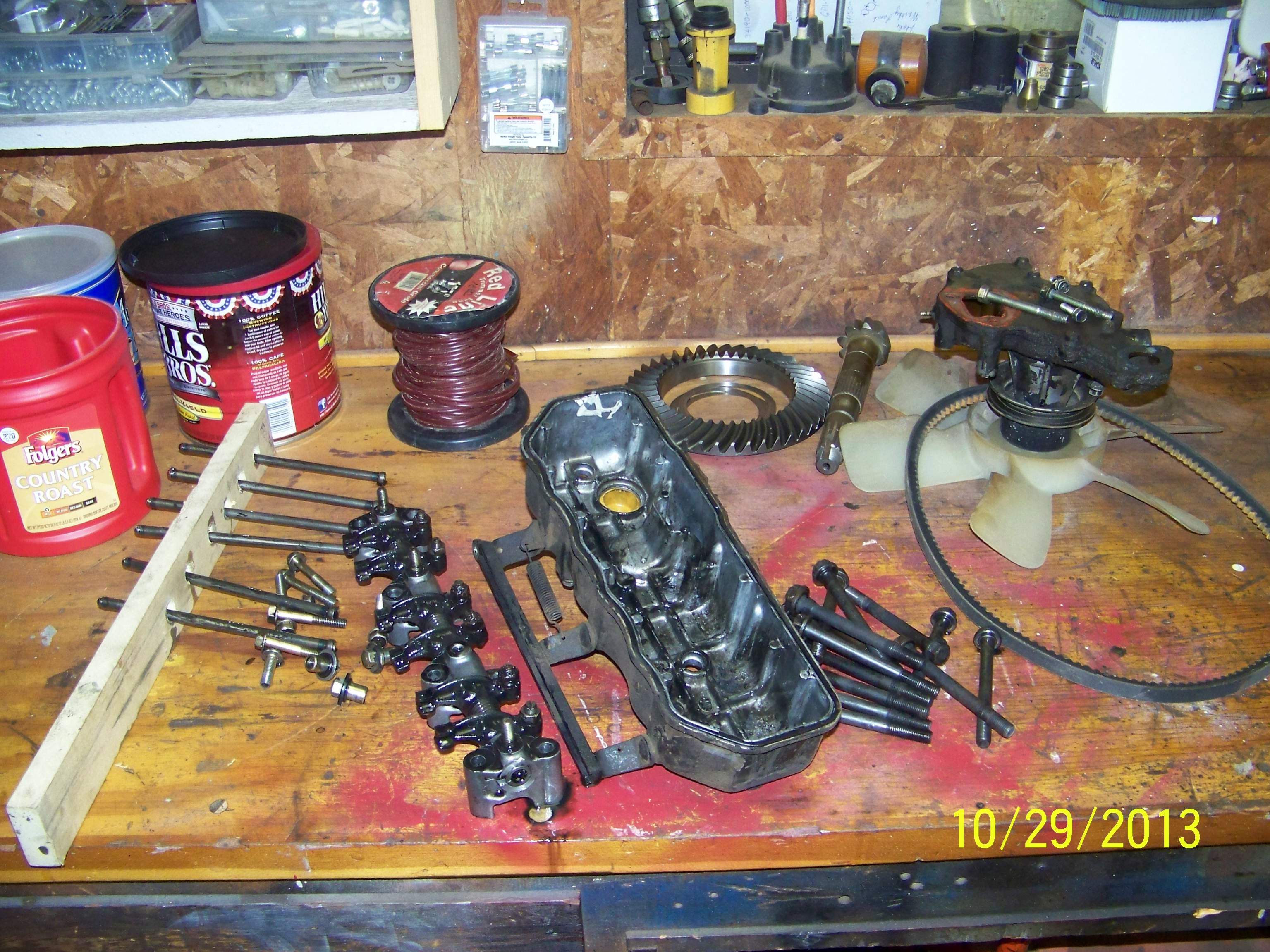

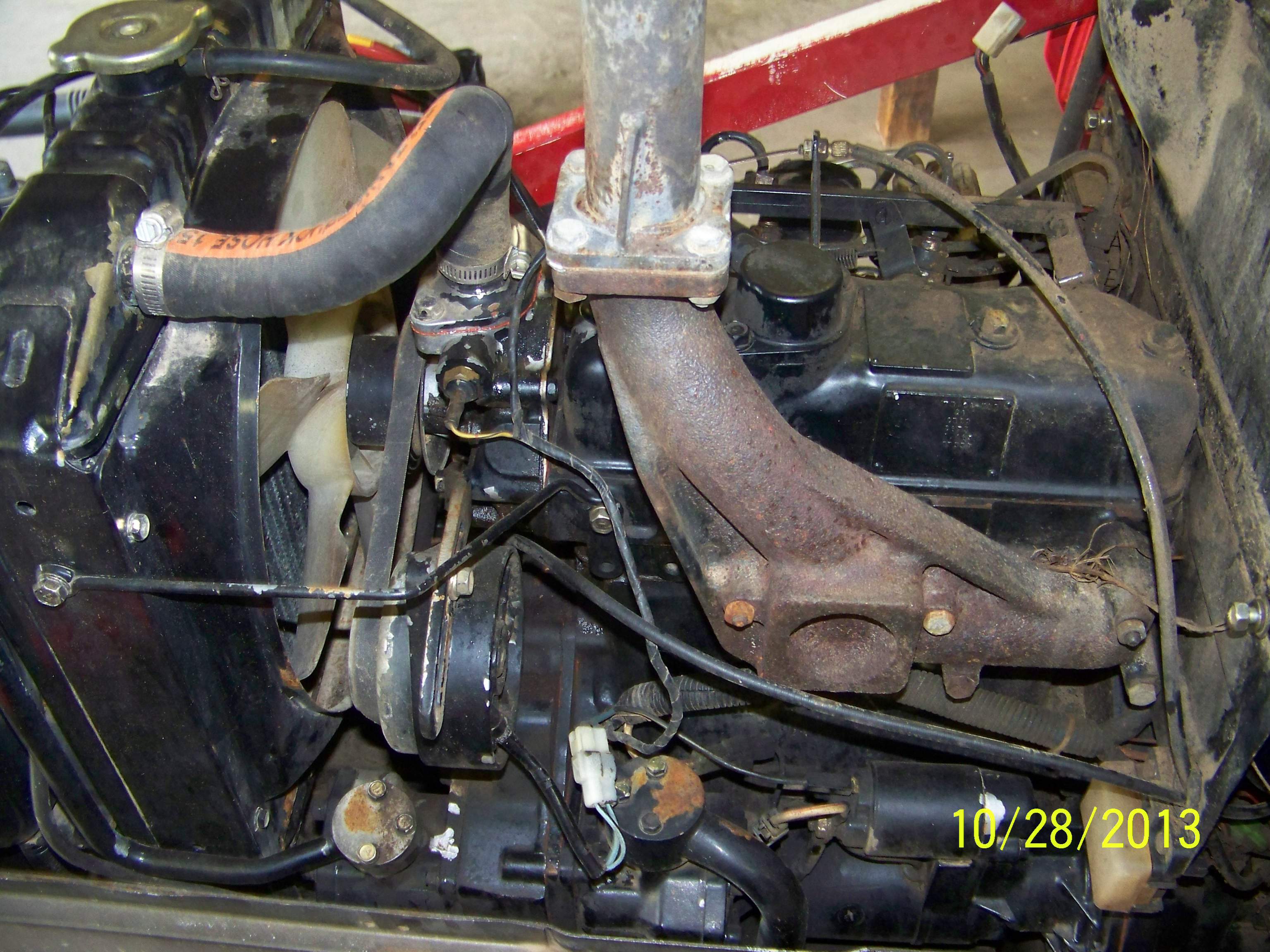

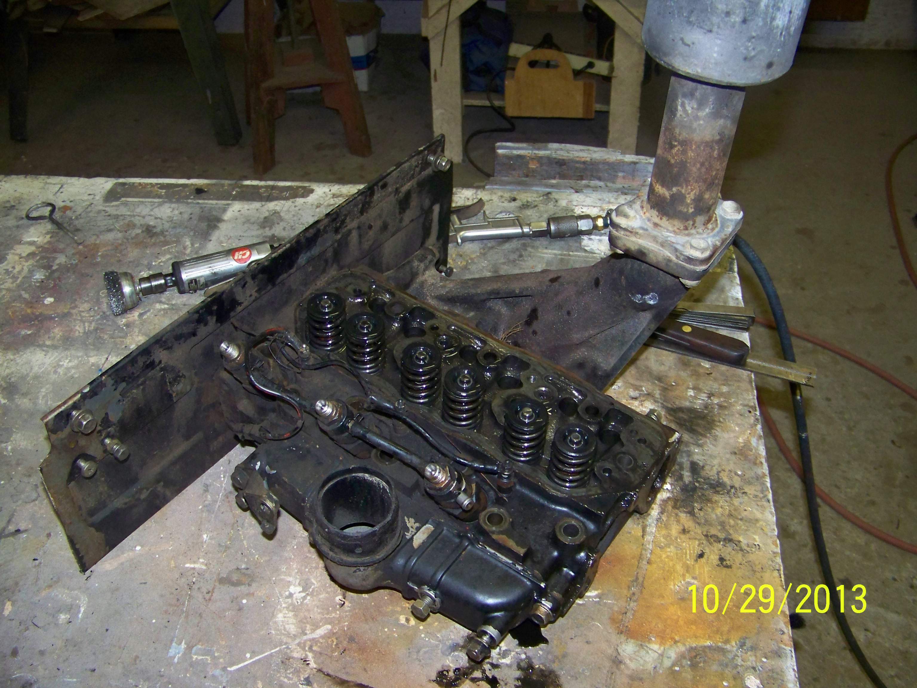

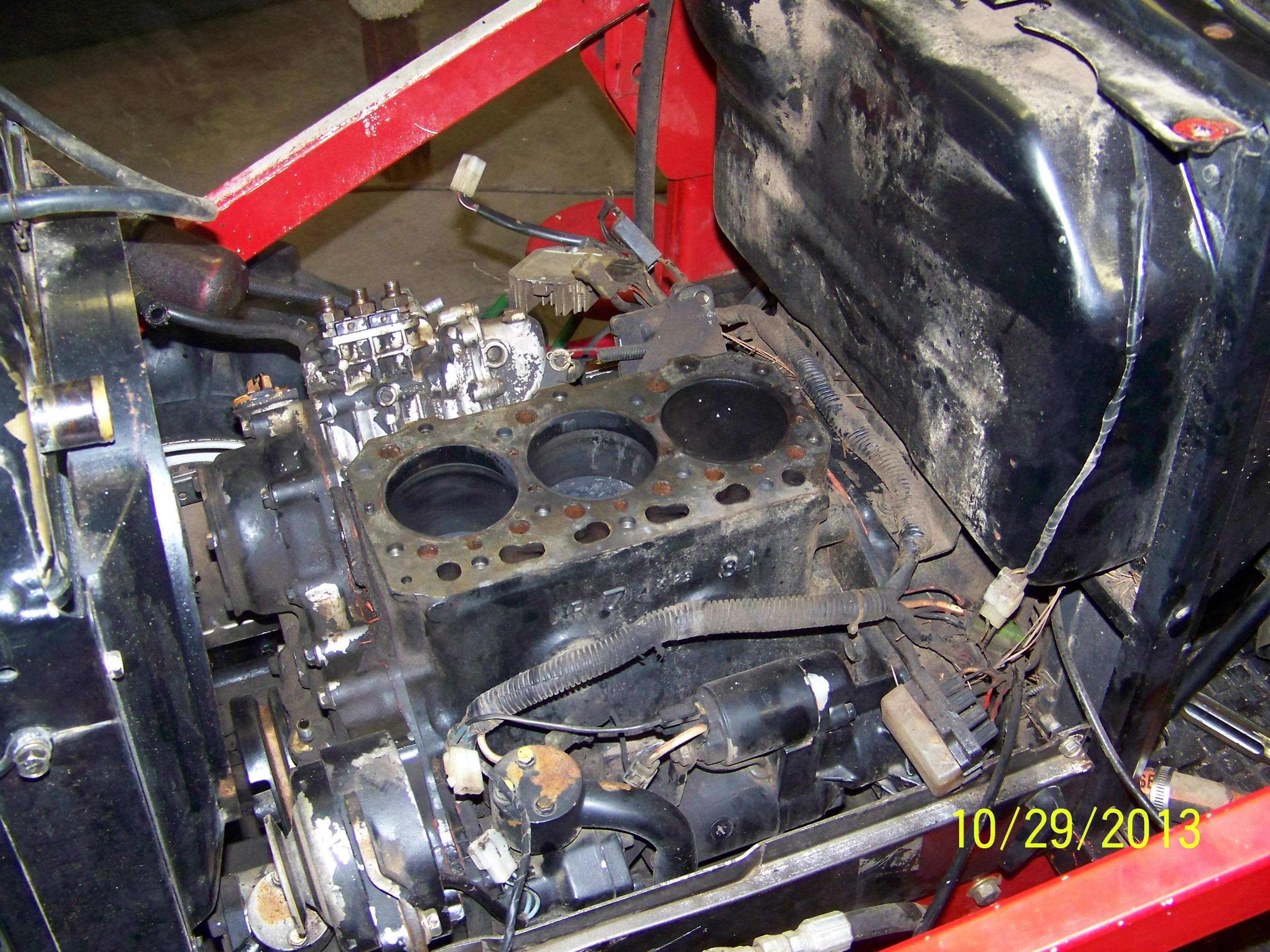

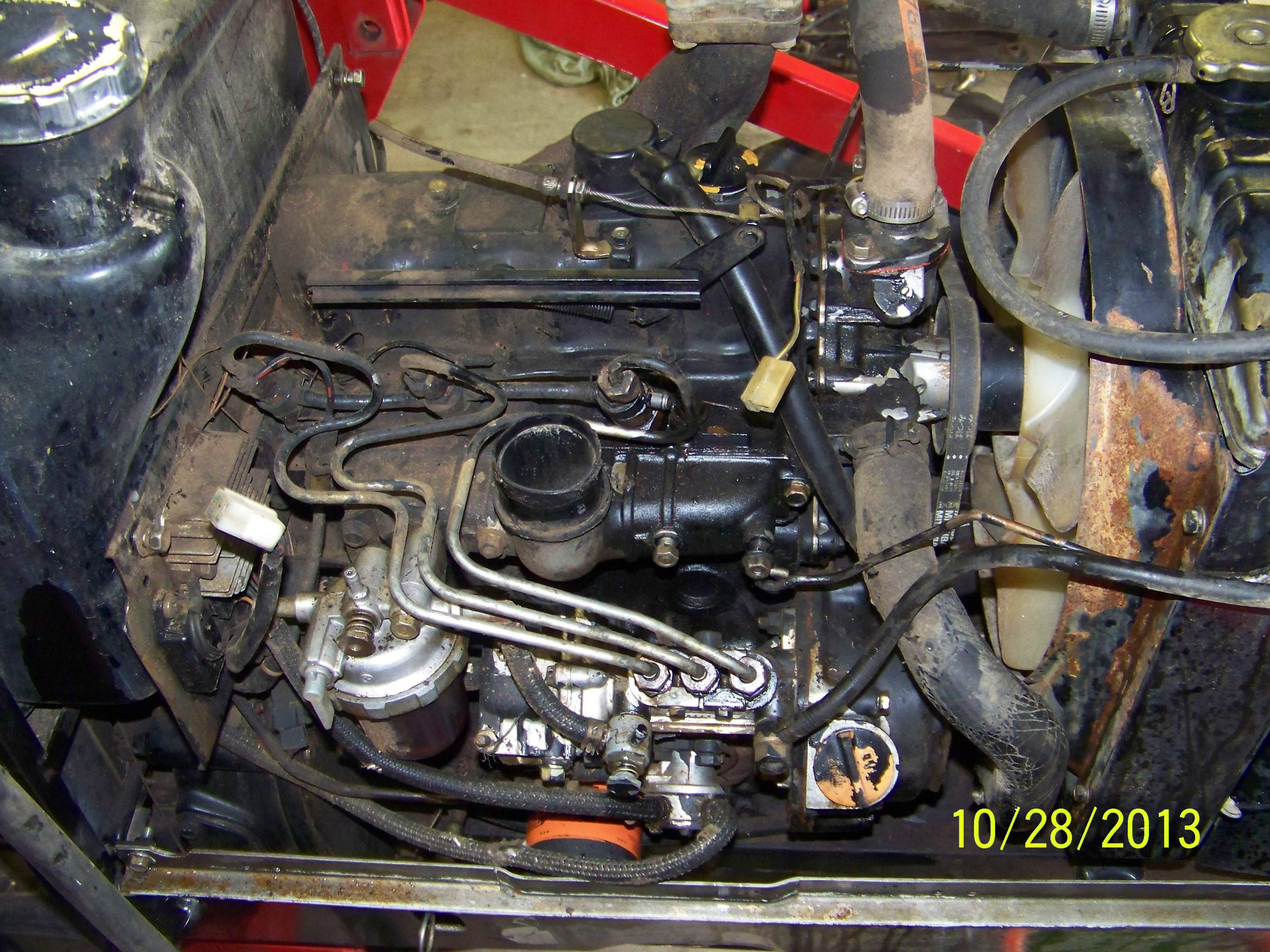

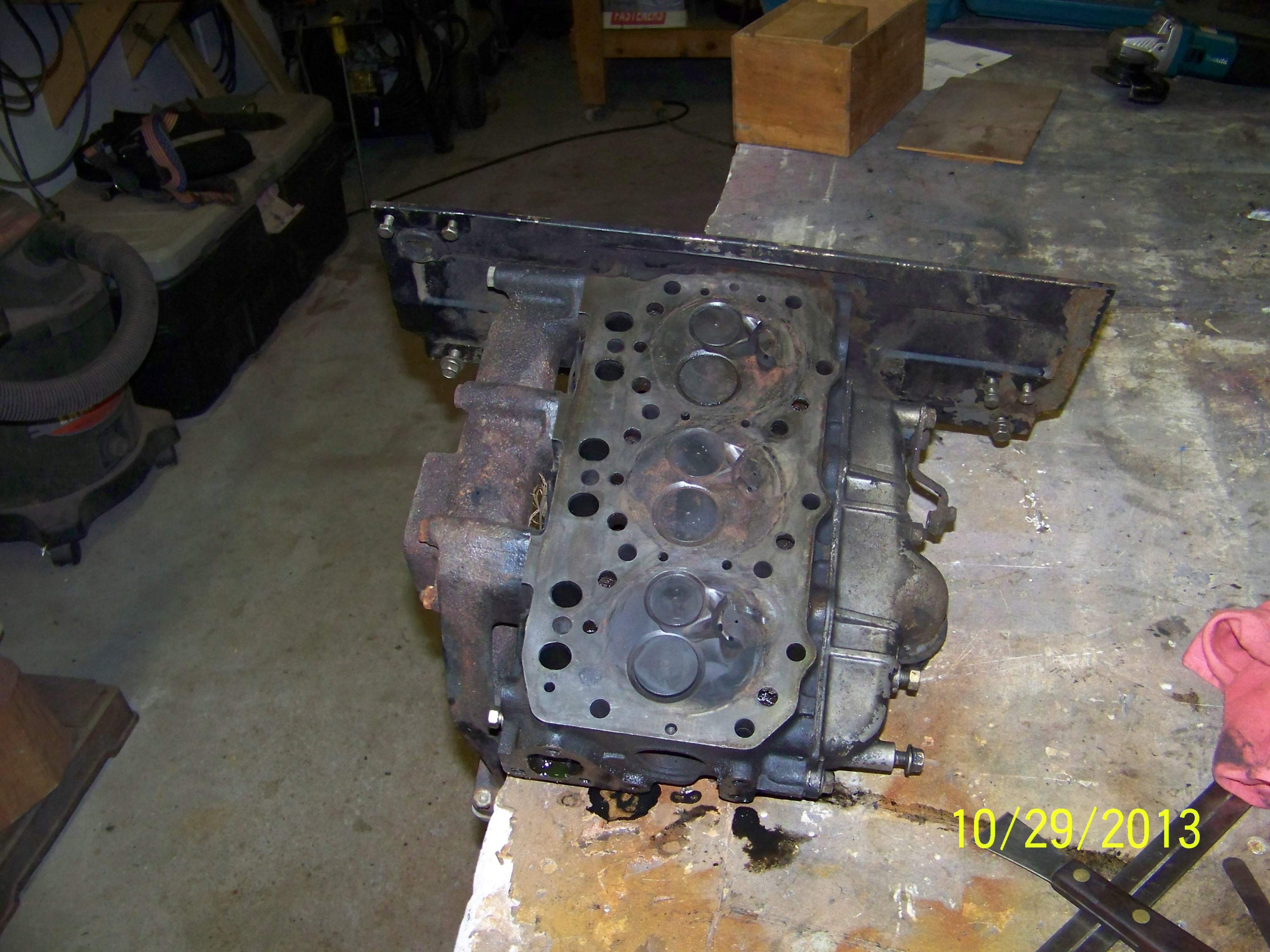

Now the bad news. I should have caught this before but when I picked up the tractor from GW I noticed the coolant level to be pretty low. To shorten the story I topped it off while waiting on parts. Upon cranking up and after running through the gears slowly, I then increased rpm and when I did so, coolant began coming out the overflow bottle. Upon a little further testing there was no doubt the head gasket was blown. Number 1 cylinder, I assume, the one closest to the firewall. Not positive the F series cylinders are numbered the same as the ym series. I'm posting a few pictures, not for instruction, just for those interested in what the FX24D engine looks like. A .002" feeler gauge would not slide under a straight edge in any configuration so parts are ordered to put it back together. Valves look good. You can still see hatch marks in the cylinders. Seems strange, but notice the inner firewall attached to the head. That comes off with the head. I check valve clearance before head removal. They all checked right around .008". Does anyone know for sure what the clearance is suppose to be? The head bolts on this thing are not re-usable and it takes 14 of them. I have requested torque value with my order. I am having problems with my picture program. If I get it going I will add some pictures later.

Winston1, IIRC the valves are supposed to be set at .006. But I too am old and only providing this info from memory.

Some pictures.

how were you able to set the backlash ? As you stated they match up very close and the mounting is such that setting backlash is almost install and make sure its not too tight...?

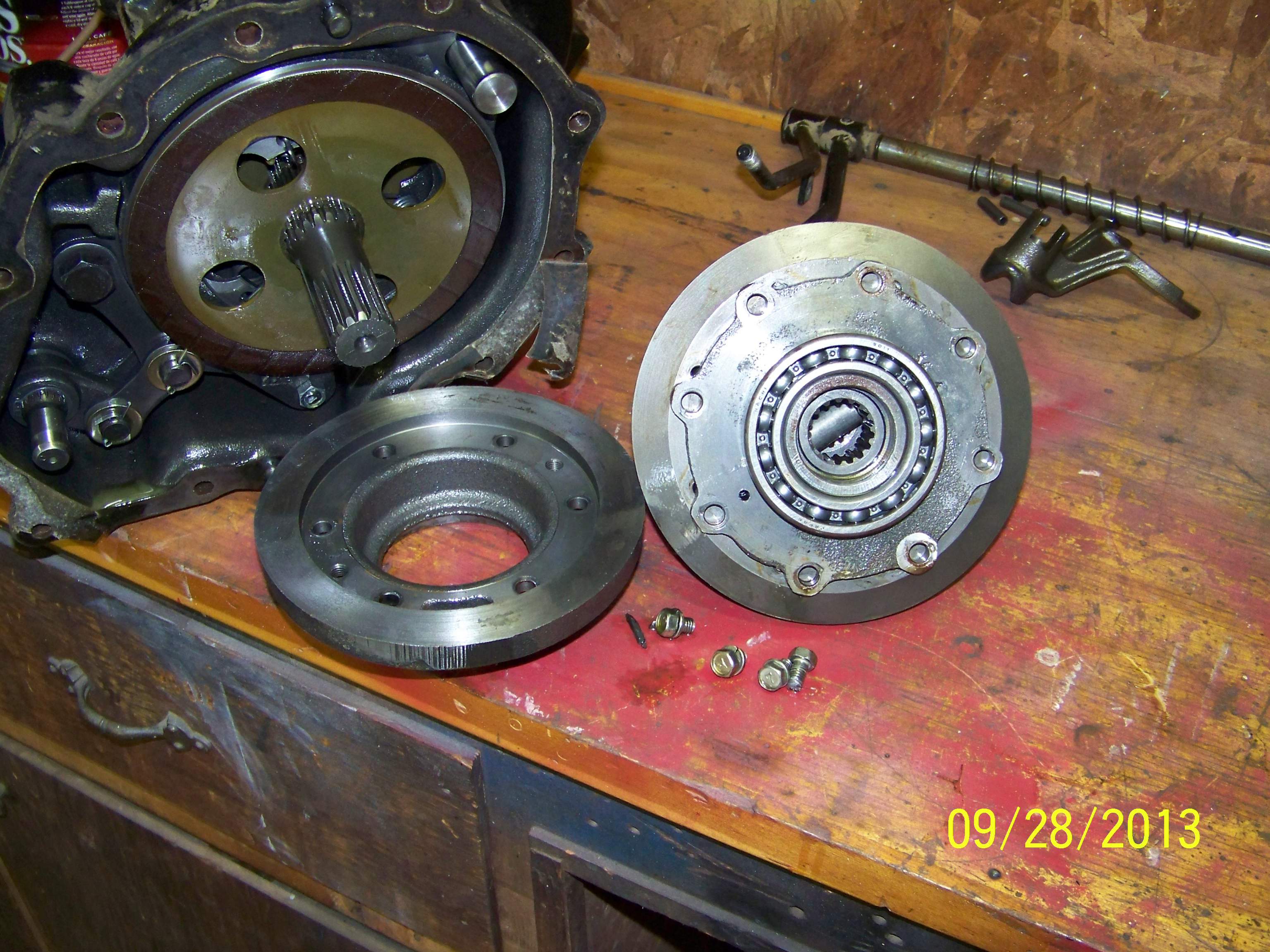

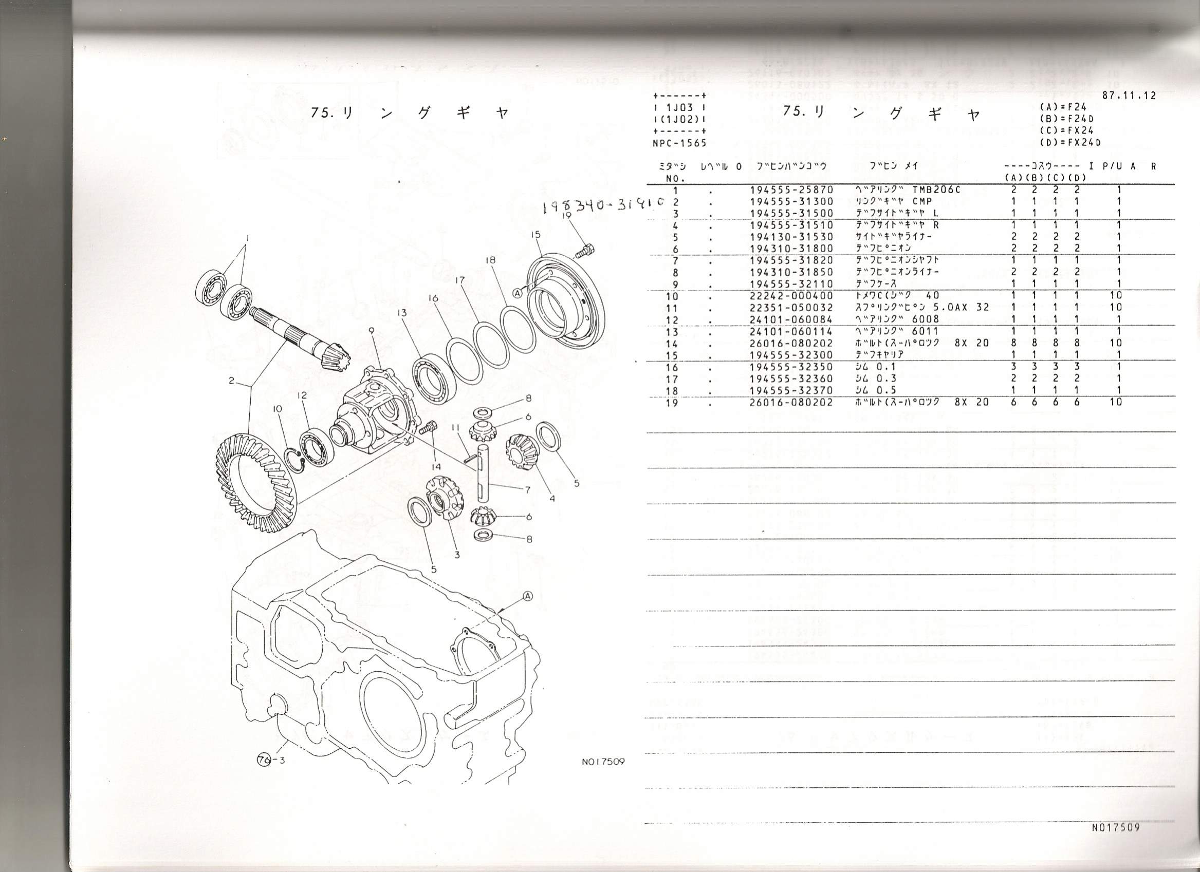

Notice shims 16, 17 and 18. This one originally had 3 of the .5mm shims. To get proper backlash I replace those 3 with one .005" shim. Cut it out of roll shim stock. One of reference 15s jobs is for the brake disc to run against on the outside. On the inside it holds a differential bearing and the shims that push it in or allow it to go further out. Very interesting arrangement. There is absolutely nothing to keep the differential from going toward the pinion except tooth contact. The small bearing (12) is free floating in the housing. Nothing at all to hold the large bearing (13) from coming in other than tooth contact.
The backlash actually varies from a tight .004" to around .008" depending on ring gear location. This run out is on the ring gear, not the pinion gear. I'm gambling this will work. I don't think we want to go looking for a new differential carrier. Checked this with a dial indicator at the tip of the ring gear tooth. This picture shows #15 pretty good. It rolls right up against that brake disc, shims go into the other side to push the bearing shown on the differential carrier toward the pinion shaft. I hope I've made a little sense here. :)
Thought I might add from what manuals I have the backlash should be between .004" and .006".

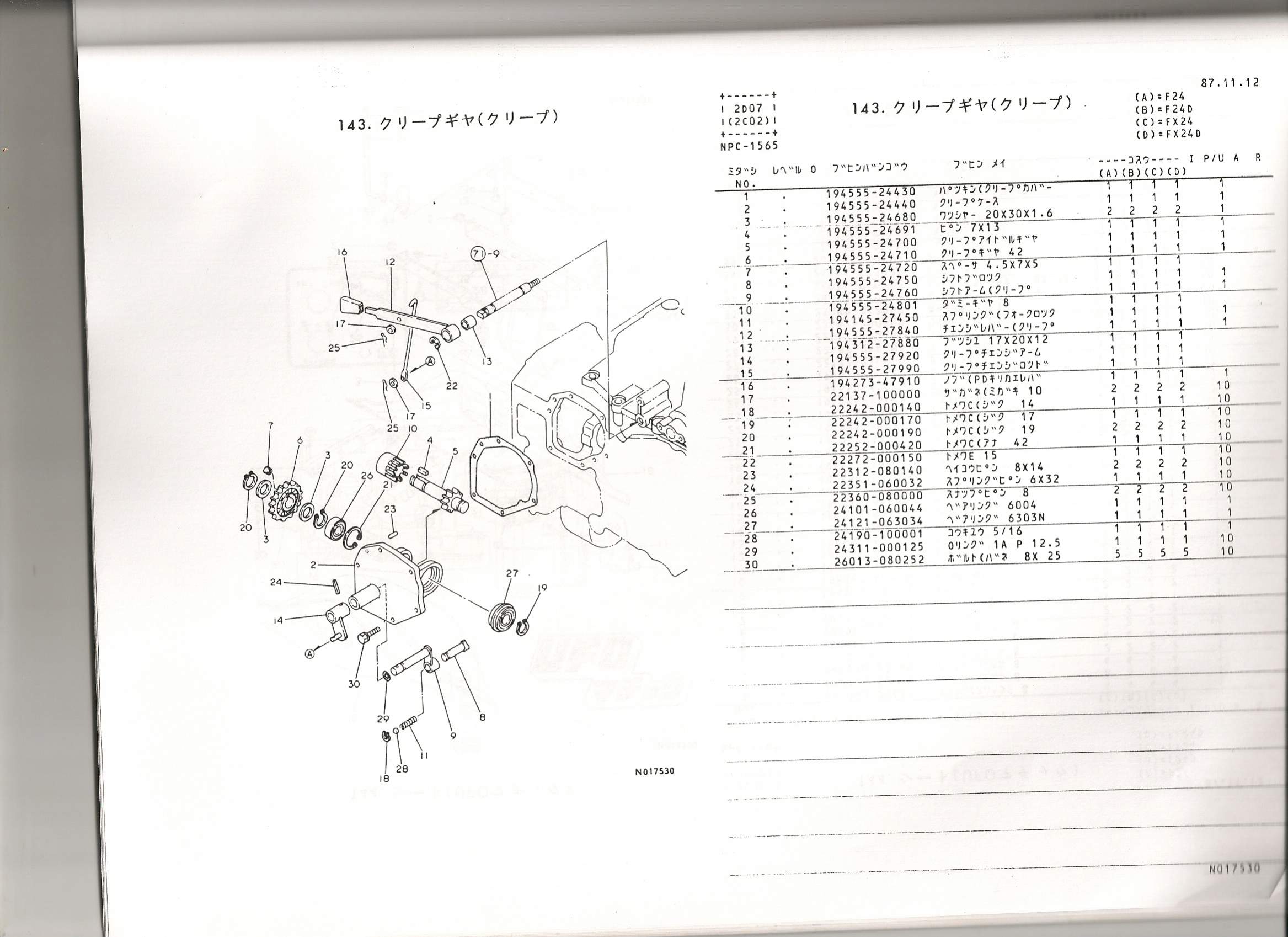

Can anyone translate the heading on this page? :confused3:
   / Drive train YANMAR FX24D #74
I got it translated. It says Creep gear.

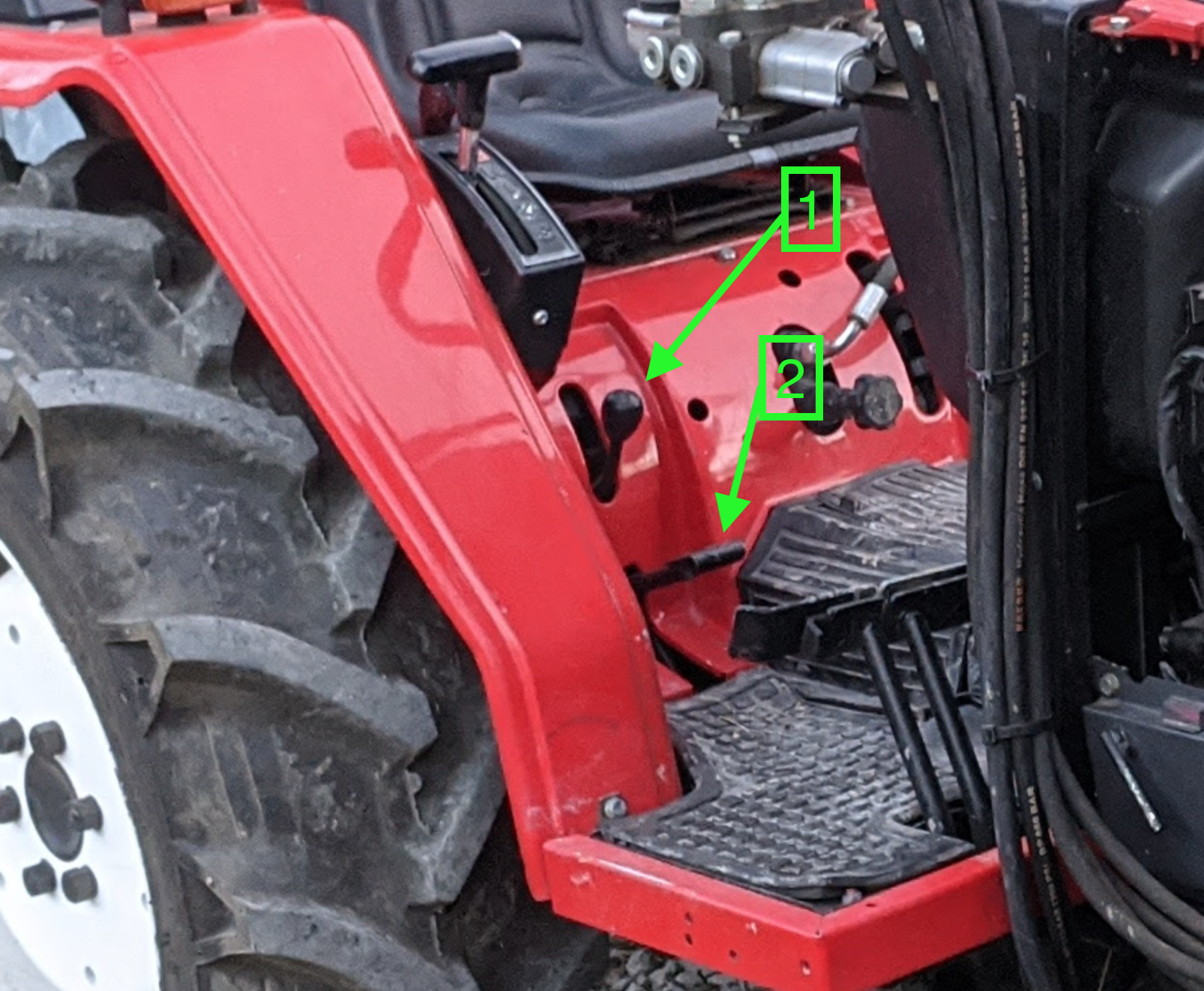

Hello, the thread seems to be quite old, but I'll try to ask a question. Maybe some of you will answer.
I've got Yanmar FX24 and because of the portal axle leak I had to dismantle it and install a new gasket.
After putting it all together everything was ok except 4x4 drive pedal. I mean until the repair I was able to press the 4x4 pedal down and it stood in the pressed position. Right now after pressing the pedal, it comes back to upper position and I can't turn on 4x4 drive. Can anyone explain what could happen that the pedal doesn't stay in down position?
One more thing. To attach the front drive one have to move the shifter (number 1 on the photo) down. But I don't exactly know what this pedal (number 2 on the picture) is for. Can anyone explain that to me?
Thanks.
   / Drive train YANMAR FX24D #80
#2 is your differential lock. you sometimes have to be moving for the pedal to align cogs. It should automatically come up when taking your foot off. However, it will sometimes stay engaged until binding of gears is relaxed. Differential lock and 4 wheel drive are two separate components.
