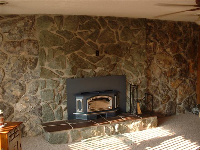

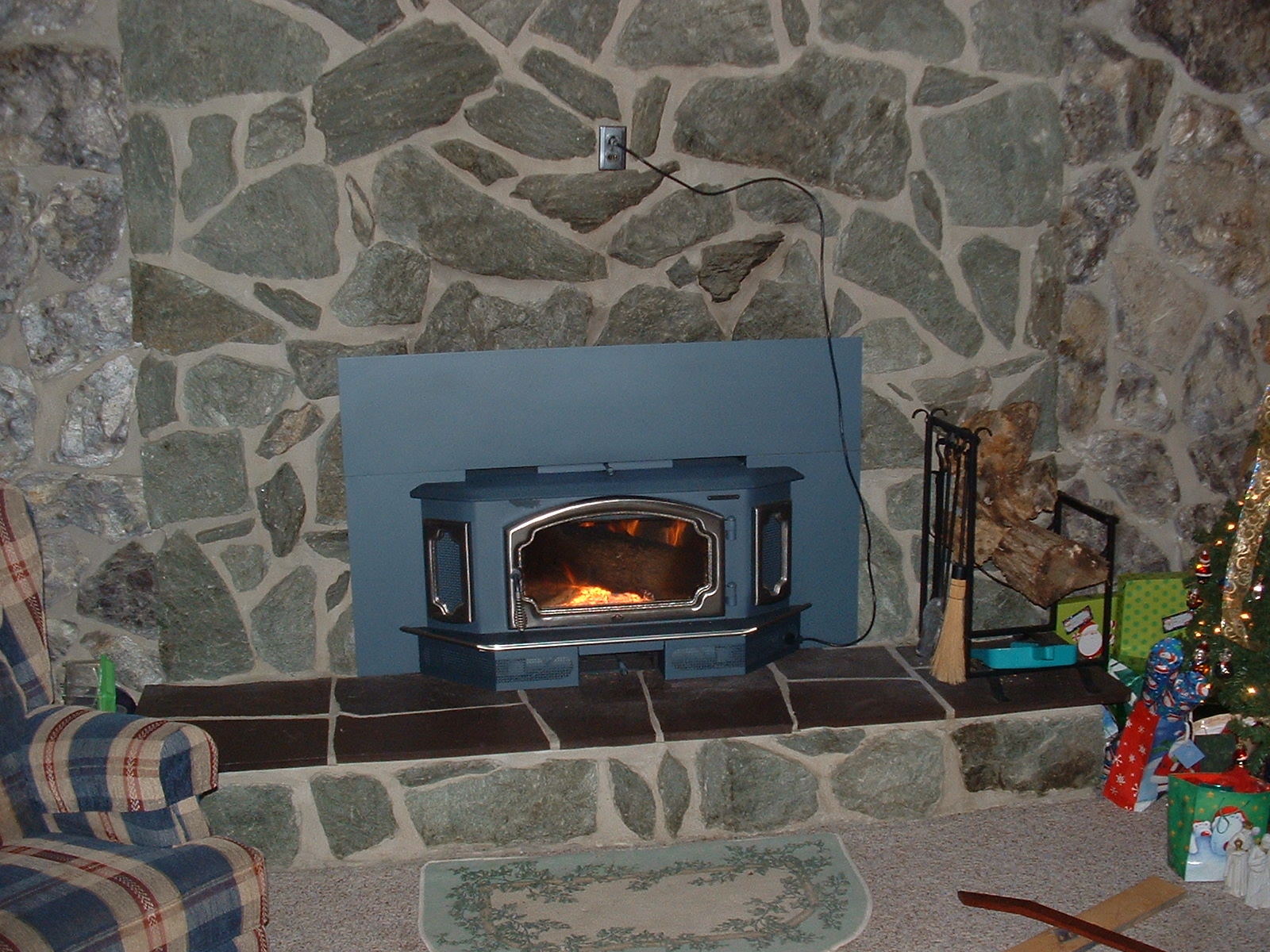

Well, I think these older pics should show the stonework. I dont think it's feaux stonework, these stones are pretty large. Of course we bought the house used so no idea who built it or method used for what's behind the stonework. Luckily, my dad's my go to man for making sure I dont do stupid stuff or at least keep it to an acceptable amount. He's a licensed general contractor with many houses under his belt. But I can't say that he has had to drill through these large types of stones before. I know he doesn't have a hammer or rotary hammer drill.
Pics attached and thanks for the cool links and good advice. Maybe these pics will bring on some more. The one link for the mantel install guide I did google up a few days ago. The piece of red oak I'm using (first post pic) has been drying under lean to shed for over a year. Have planed the top and bottom and moved into garage. I plan to start smoothing front live edge up, cutting butterflies out of walnut for the large cracks, then trimming excess weight off to move it into the house for more drying.

That looks to me like stone veneer. It may be either natural or cultured stone. If it is veneer, it is not structural. You need to drill through the stone, but make your attachments into a stud wall behind the veneer.
Look on the outside of the building. If there are any areas where there is siding opposite rock it is veneer.
/ Drilling Stone for Fireplace Mantle #14
It looks like natural stone, but like others said it may be a veneer, is there a way for you to drill through the mortar only, and see if you can find a stud? That is what we did.
If you can line up a few studs by drilling only the mortar then you would not crack the stone. The mortar is easy to fix but if you crack one of the stones then thats going to make a long day much longer.

The stone wall doesn't go through to the outside of house. The outside is brick. Does that make this a veneer? The stones are very real and very large/heavy. There scattered stones in the yard that I'm sure were just leftovers.

Rent yourself an SDS hammer drill and try to get one with a variable speed trigger. Play around with those extra rocks to get a feel for where you can safely drill and try to go slow without putting too much pressure for the first few holes until you get a feel for it. Drilling in rock is not that bad. But it's a little hard to keep the bit from wandering a bit when first starting the hole. Unlike a steel bit the carbide stone bits don't really dull so you can practice to your hearts content before drilling into your stonework.

that electric outlet might be your way to find out what's behind the veneer.

Yep its veneer, just a surface decoration not a structural component. So Practice drilling on an outside rock to see what it does if it splits then you need to go through the mortar.
With my mantle the uprights (mine are cast concrete that match our stone the local brickyard had them) really dont hold its the lag bolts that go into the studs that do all the holding.
