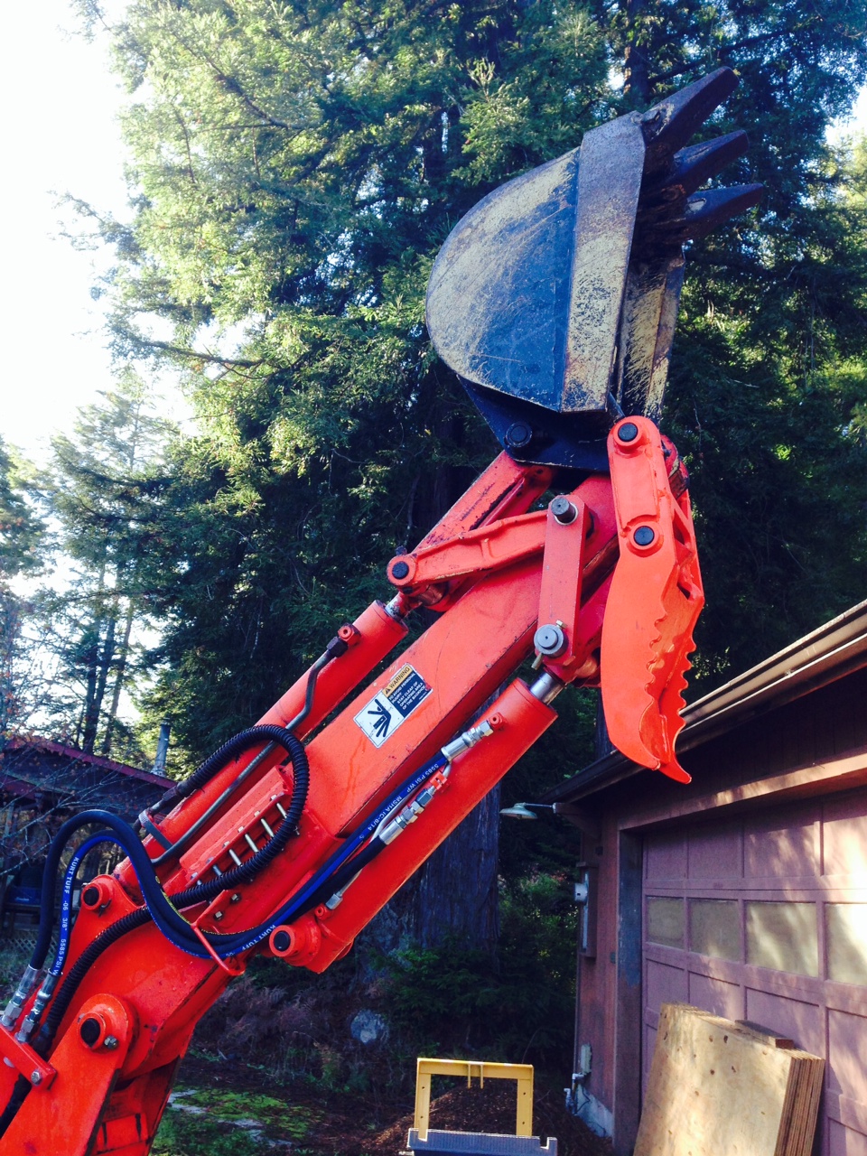

You might be able to piggyback on brackets for the thumb cylinder and for the bucket cylinder hoses. That is what I did. No welding or drilling needed.

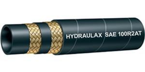

I posted this question on the vendors web site but do it here for benefit of TBN. What is the meaning of single wire and two wire in the descriptions of those clamps Cord gave us the link to at Surplus center?
Single wire:
One braid of high tensile steel wire reinforcement
Two wire:
Two braids of high tensile steel wire reinforcement
