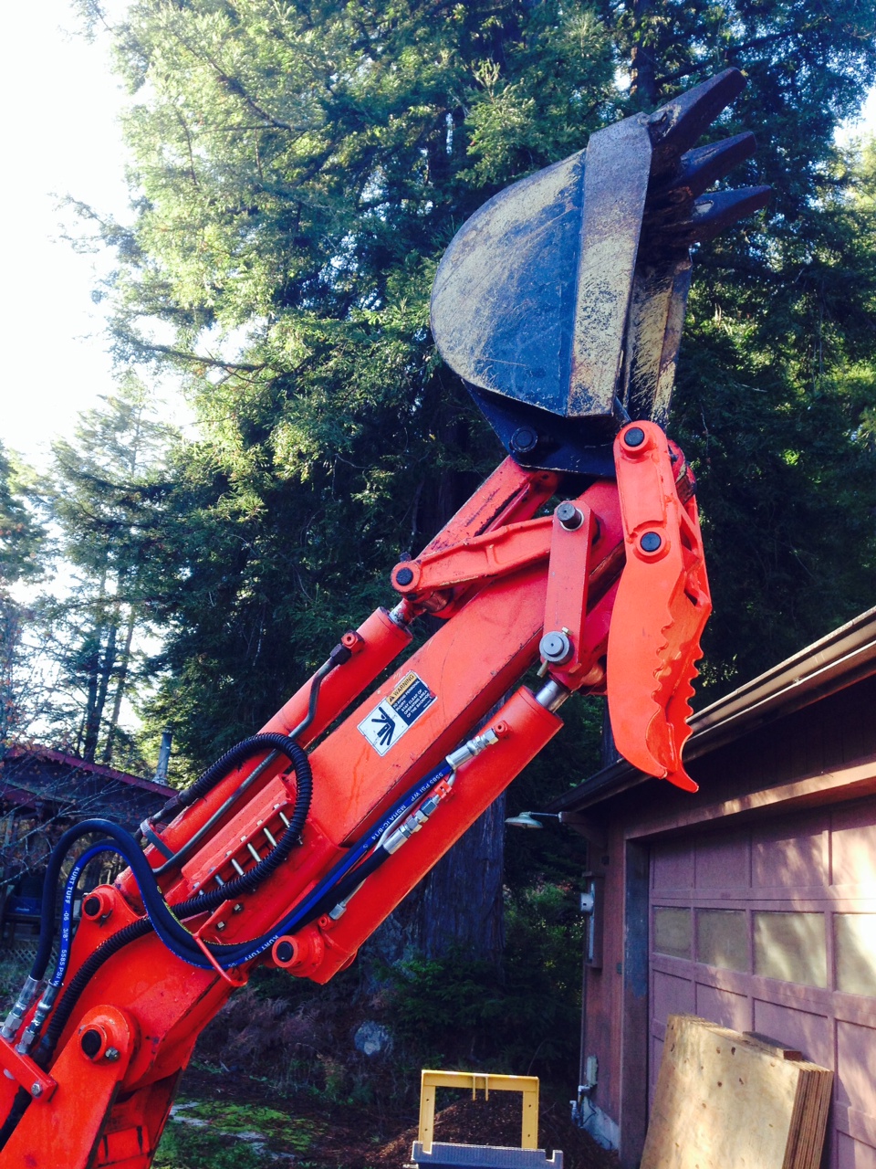

/ Drilling a small hole thru backhoe boom? #13
You might be able to piggyback on brackets for the thumb cylinder and for the bucket cylinder hoses. That is what I did. No welding or drilling needed.
